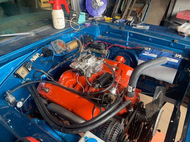

Got a bit more done this weekend.

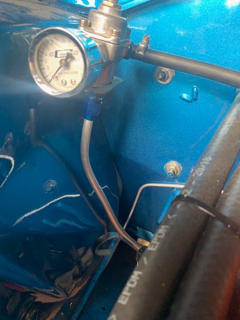

Re- plumbed the fuel system using ally tube up to the repositioned regulator . Will support the tube well to eliminate possible flexing and cracking.

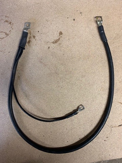

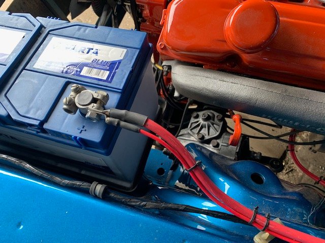

Made some battery cables, Crimped *and* soldered

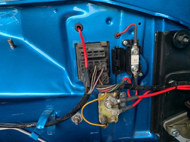

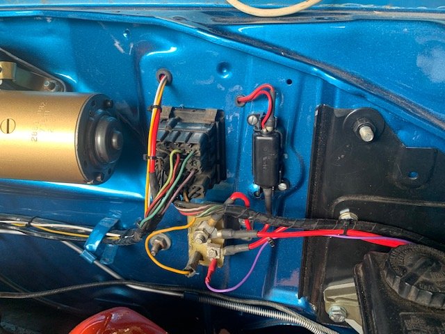

Replaced the fusible link with a real fuse. Bypassed the charging circuit around the bulkhead connector.
Added a separate live feed for the electric choke, and another for the ignition module which is live in run *and* crank thanks to a new relay under the dash.
Definitely getting there

Wow epic as always young man
Posts: 1680
Re: Matt's '68 Coronet 500
Looking tidy :thumbright:

Funnily enough,Ive just used the same type of fuse on my challenger,got to be better than the old fusible link :thumbright:

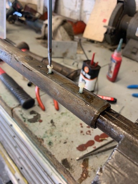

So having remembered that I'd 'borrowed' the power-to-manual steering column adaptor from the Coronet to use on the 'Cuda, I had a bit more work to do.
Martin at RPM found me a pot coupler with the larger 'manual' spline in it , so just needed to get the correct length inner column.
Power steering inner columns measure around 41 1/2" , and manual 44 1/2"
A manual column can be collapsed to a power length, but the power one will not extend far enough the other way.

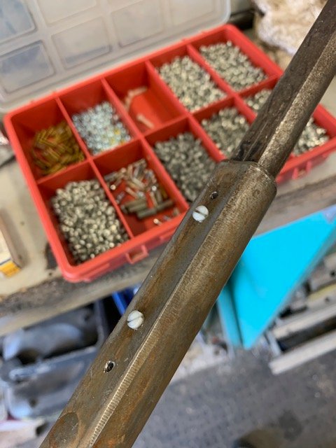

Fortunately I had a manual column in the spares pile, but the nylon shear pins had been broken at some point. Always worth checking these, because if the inner column collapses on its own, the UJ ''pot" coupling can disconnect and steering is completely lost. Never a good thing.

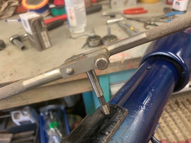

I drilled and M3 tapped another four holes (two each side) and used nylon screws with threadlock to 'replace' the shear pins

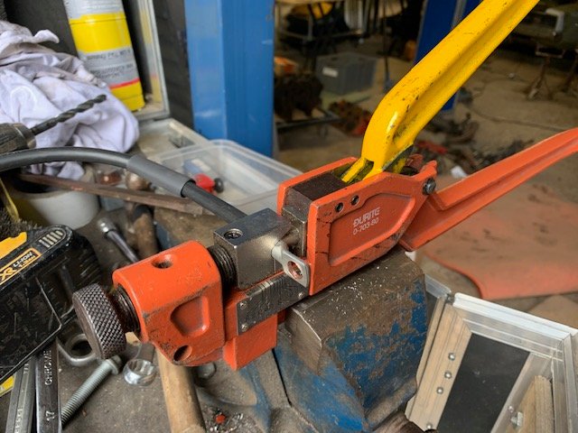

ONe of the column mount bracket bolt holes had been crossed at some point so I straightened it out

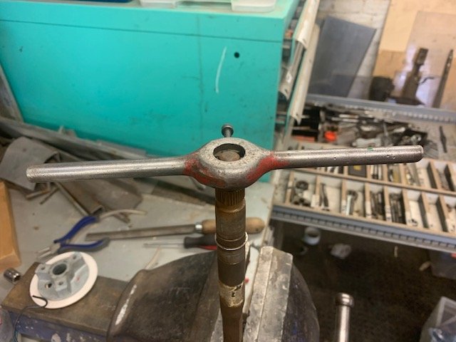

and then finally cleaned up the wheel retaining nut thread as it had been damaged at some point
