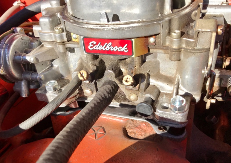

Fuel vapour separators were mentioned earlier in this thread. They seem to have been fitted to early 70s B bodies. A mate has one fitted to his 72 Satellite.
Re: Strong fuel smell
Posted: Thu Jul 30, 20 8:56 pm
by Mark B
The phenolic spacer is fitted, seems to have done the trick. The carb was running lean so new needles and bigger jets fitted. Cars running better now.
