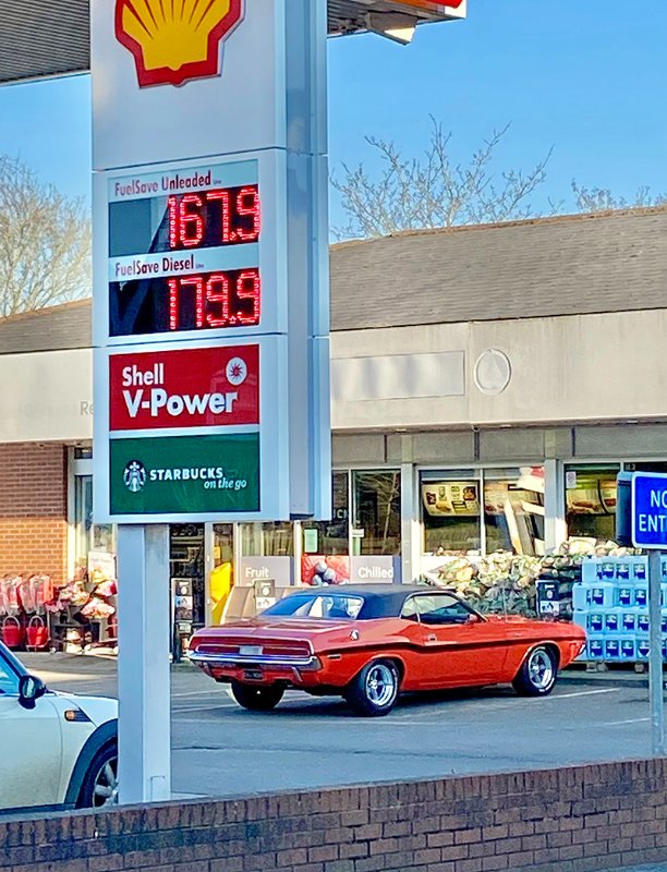

Re: E10 petrol
Filled up with E5 today at our local station, was £1.84. I know prices are high at the moment but Shell are taking the Bananarama!.

I thought 168.9 was bad round here for diesel.
Costco still only 149.9 :thumbright:
