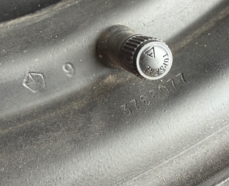

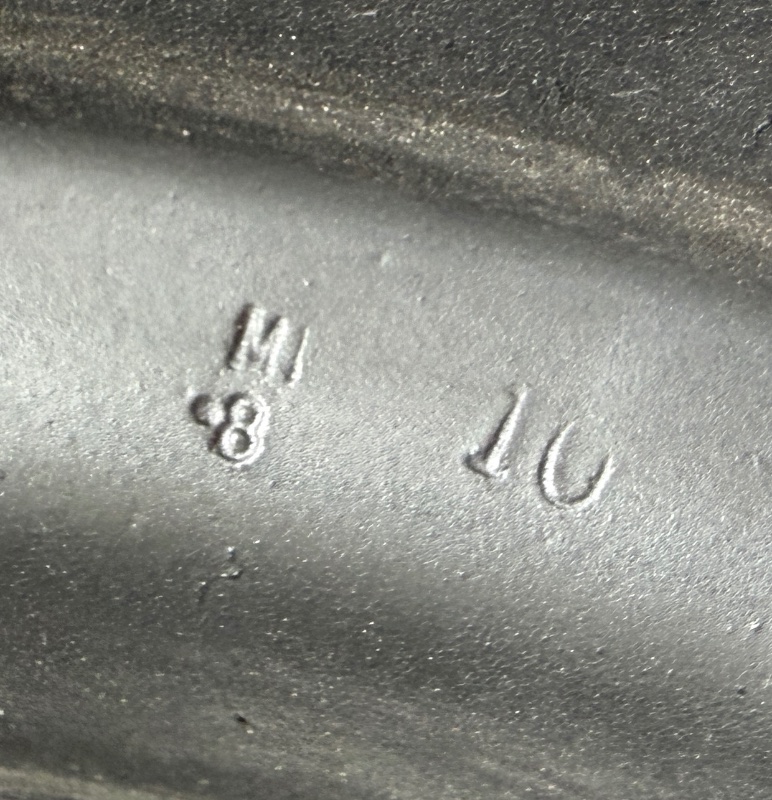

Found the rear wheel info from stamped numbers on them.

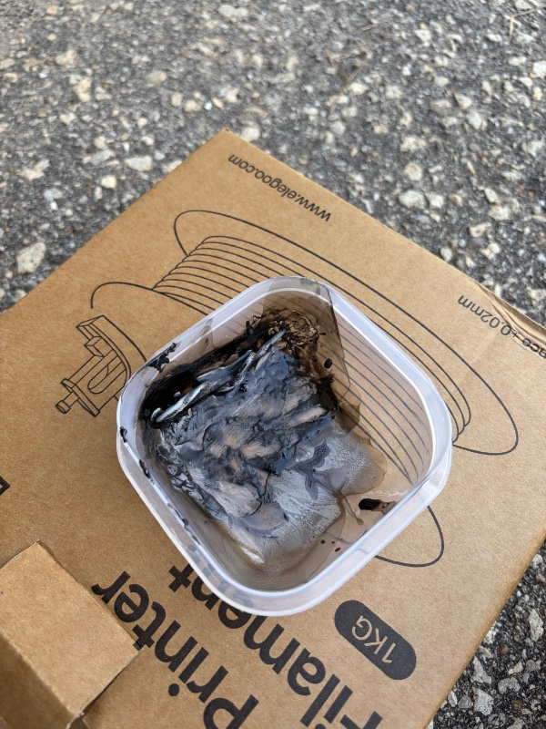

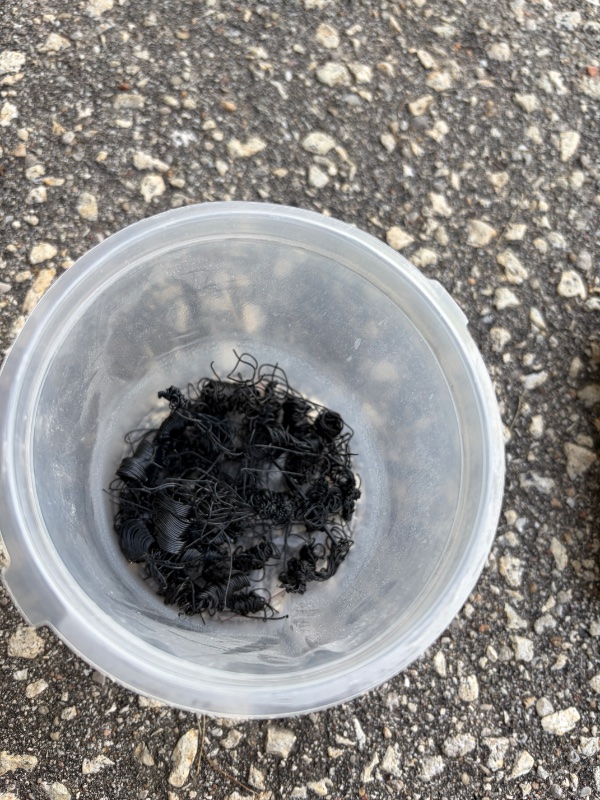

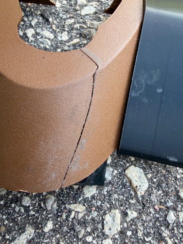

So I got the ingredients to mix some ASA slurry.
It is a melted plastic, that will bond with the original plastic.
Just mix the raw ASA plastic with Acetone. When it has melted to a paint like consistency, brush into the crack.
It will go off quite quickly.
Going to leave this overnight. To totally harden, then start sanding.

well, it aint perfect. Still more to do.
