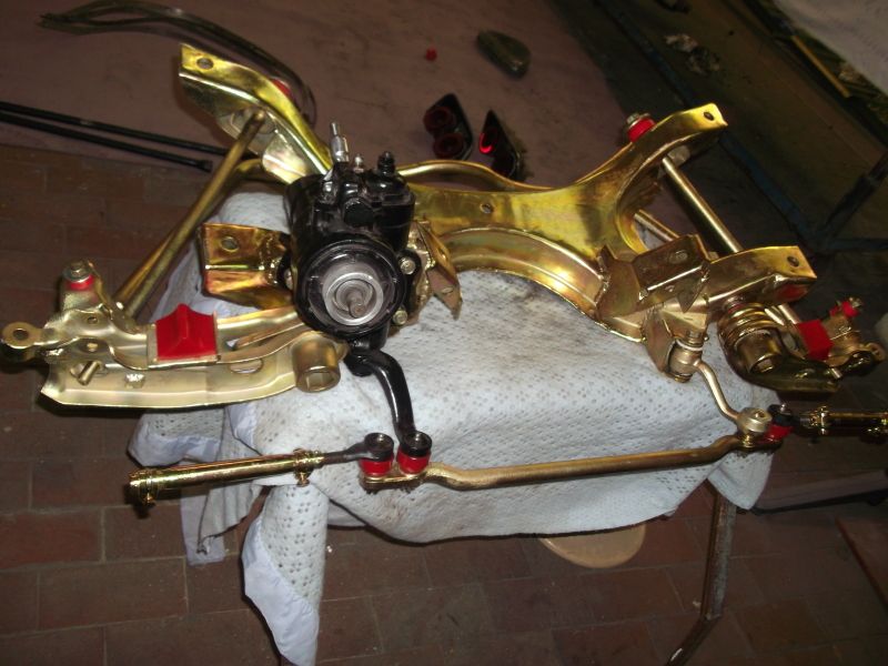

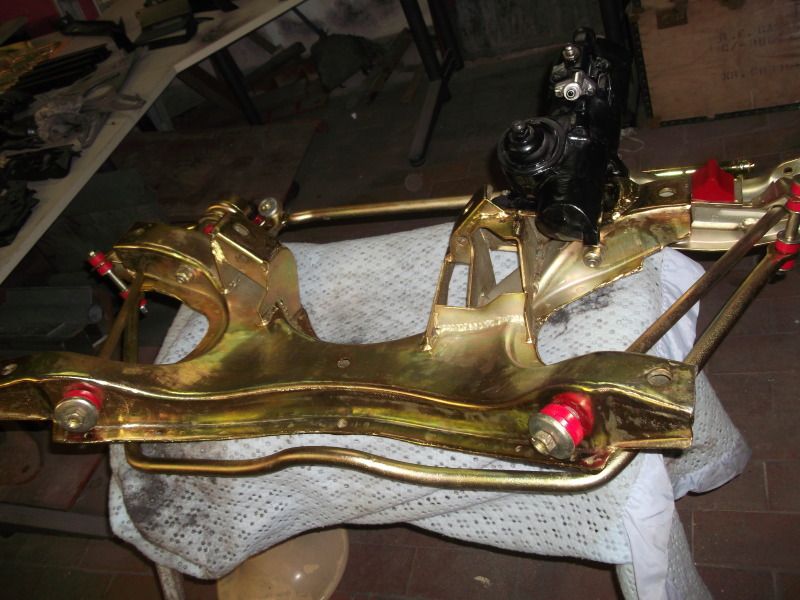

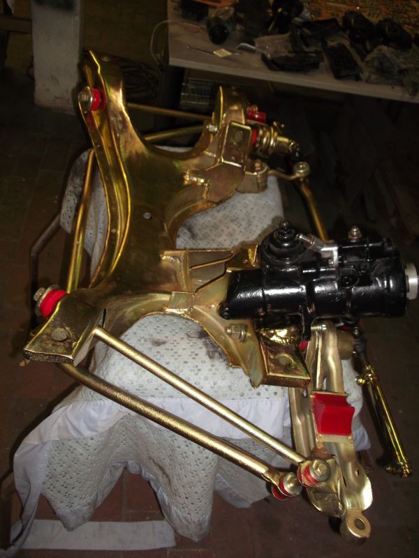

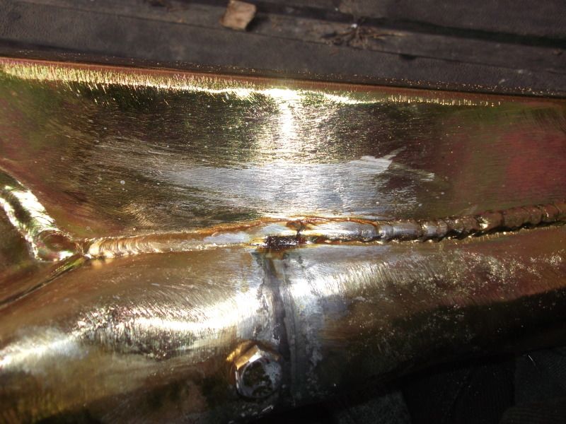

Front axle came out ok

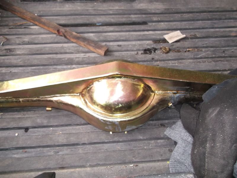

Back axle found another Bananarama! hole that i missed with the welder so back to the zinc shop

You need a tig welder Will. Much easier to get hole free welds.
If you dont mind me saying, im not covinced by the zinc idea. I think you may be dissapointed in how it looks a few months down the road. Dont get me wrong, it will be doing its job, (protecting the steel)but zinc is sacraficial, and starts that process straight away.
If it were me, id paint over it.

Roger wrote:You need a tig welder Will. Much easier to get hole free welds.
I do have a tig welder just brought it and learning how to use it. Was worried about the amount of heat thats why i used a mig to weld axle brace.
Zinc will it wont it last ?????
Shopping trolleys , mildon sump , Motor bike chain.
Anyone got a mildon sump pan yellow zinc plated thats looks Bananarama! ???
Time will tell
74challenger318
shopping trolleys are Zinc Nickel plated which is hard wearing, you stuff looks like Zinc then Yellow passivated, works better on brand new steel, you will find that the parts that were rusty will go first and 6 months down the line everything will be dull and rust forming, you will have to strip it all down again and end up painting it all,
be carefull also with spring steel as the process used makes these brittle, you may have to get your springs retempered?

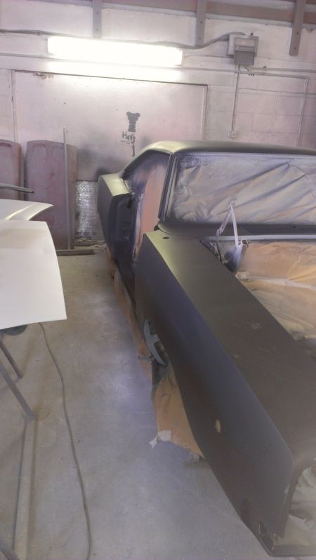

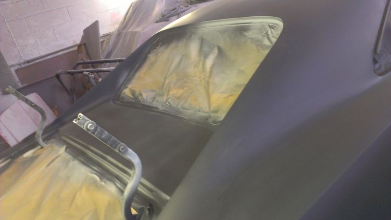

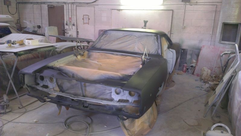

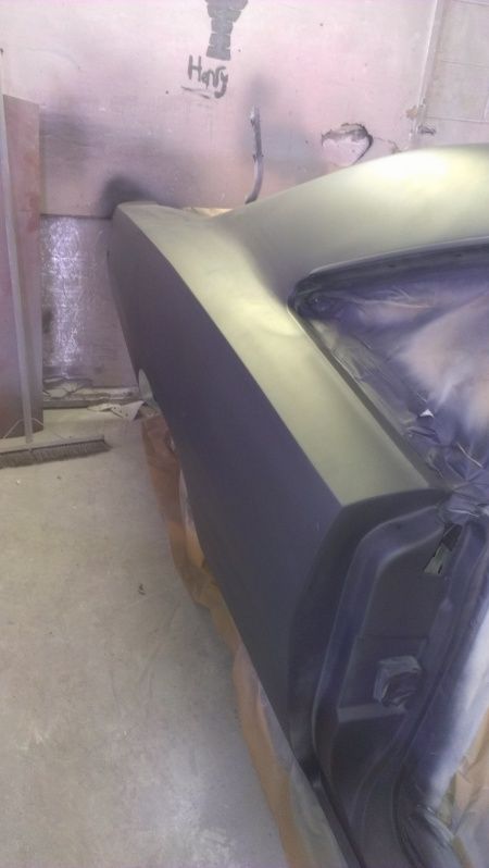

Anymore before i go and buy 2k clear paint and paint over zinc
below are a few pictures i just got sent from paint shop
<a href="http://photobucket.com" target="_blank"><img src="http://i73.photobucket.com/albums/i205/ ... AG0230.jpg" border="0" alt="Photobucket"></a>
<a href="http://photobucket.com" target="_blank"><img src="http://i73.photobucket.com/albums/i205/ ... AG0229.jpg" border="0" alt="Photobucket"></a>
<a href="http://photobucket.com" target="_blank"><img src="http://i73.photobucket.com/albums/i205/ ... AG0226.jpg" border="0" alt="Photobucket"></a>
<a href="http://photobucket.com" target="_blank"><img src="http://i73.photobucket.com/albums/i205/ ... AG0221.jpg" border="0" alt="Photobucket"></a>

autofetish wrote:Anymore before i go and buy 2k clear paint and paint over zinc
I think the lacquer will help to protect the zinc, but I for one wouldn't do it.
It's your car, at the end of the day, so the choice is yours, but to me, it looks as though it will gives the car the appearance of a 'Delhi Hot Rodder' ...
I'm not knocking you, I think you have done an unbeliveable job & gone about it in an ingenious ways, tackled jobs on your own & made equipment to do it
Looking goodautofetish wrote:Below are a few pictures i just got sent from paint shop
