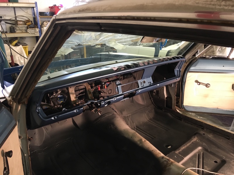

Posts: 14446
Re: Blue's Barracuda
Dash frame painted, that's it full scale reassembly underway...
Silly question.....Can the dash frame been unbolted/removed, or do you have to paint it in situe? :thumbright:
Post by 68Roadrunner »
You’ve been busy,
Looking good, are all the holes standard on the top right hand side or have you had your drill out again.😀
As far as I’m aware the dash frame doesn’t come out Dave.
Richard.
Posts: 14446
Dash frame is stock, no Swiss cheesing going on here. Yes the dash frame unbolts but it's a screen out job as there are bolts under the the windscreen rubber. For that reason I had the difficult job of masking it up and painting it in situ, it looks to be impossible but it can be done.
