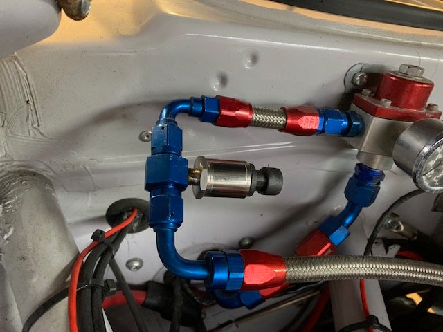

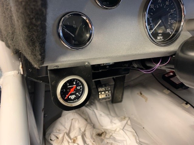

Installed a fuel pressure gauge on the dash to help diagnose a stalling problem. Engine will tick over all day, and has no running issues otherwise, but will stall if you dip the clutch after a run and try to coast.
Sender unit plumbed into fuel line
And gauge inside

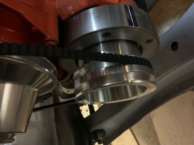

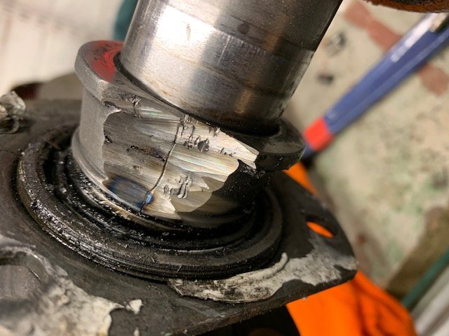

Fitted a March underdrive crank pulley , and shorter V-belt

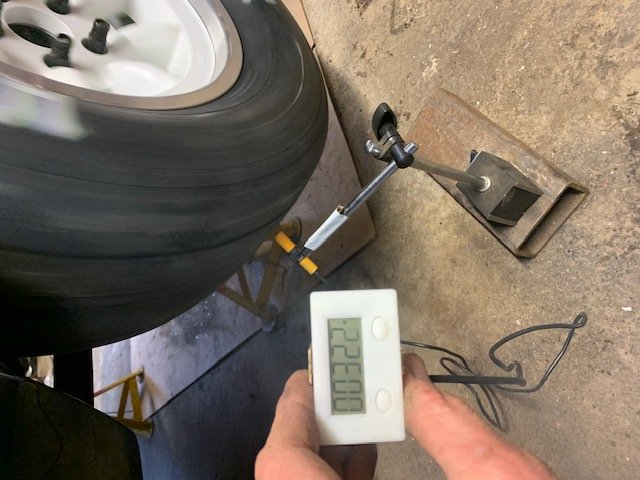

Calibrated the speedo, finally. Ever since the car was finished, the speedo has pegged at 150 pretty much as soon as you start rolling.
One calibration method is to drive a measured mile, pressing the speedo function button at start and finish. Couldn't figure out a practical way to do this, so bought a digital counter with magnetic sensor (£6.95 on ebay..) ,and strapped a magnet to the tyre. Ran the car on axle stands . One mile = 746 revolutions of this tyre size.

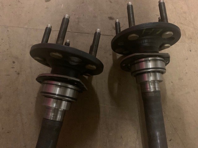

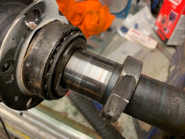

Fitting Moser green bearings
Grinding off the old ones very carefully . If you can get the metal thin enough they'll split on their own.
Pressing on the new ones
Ready to refit
I quite like the oil sealing with these - no more sealant required on the retainer plates during assembly, and much less fuss when removing halfshafts.
Although, surprisingly, there is still end float built into the bearing assemblies - about 8 thou. Was hoping that wouldn't be the case.
Upon installation, track width has been increased by about 3mm - confirmation that the half shafts are no longer butting together in the middle, and all is OK.

I didnt think the green bearings were suitable for hard cornering Matt.
SAV@RPM
Posts: 338
Location: Rushmoor, Surrey
Post by SAV@RPM »
Hi Dave
