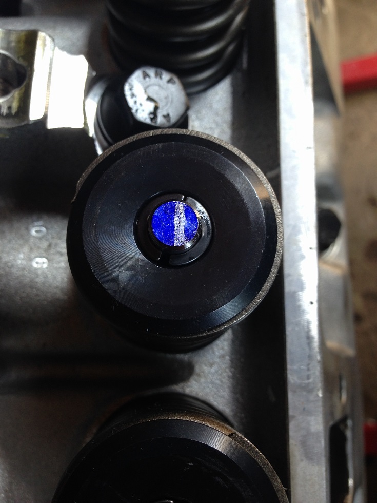

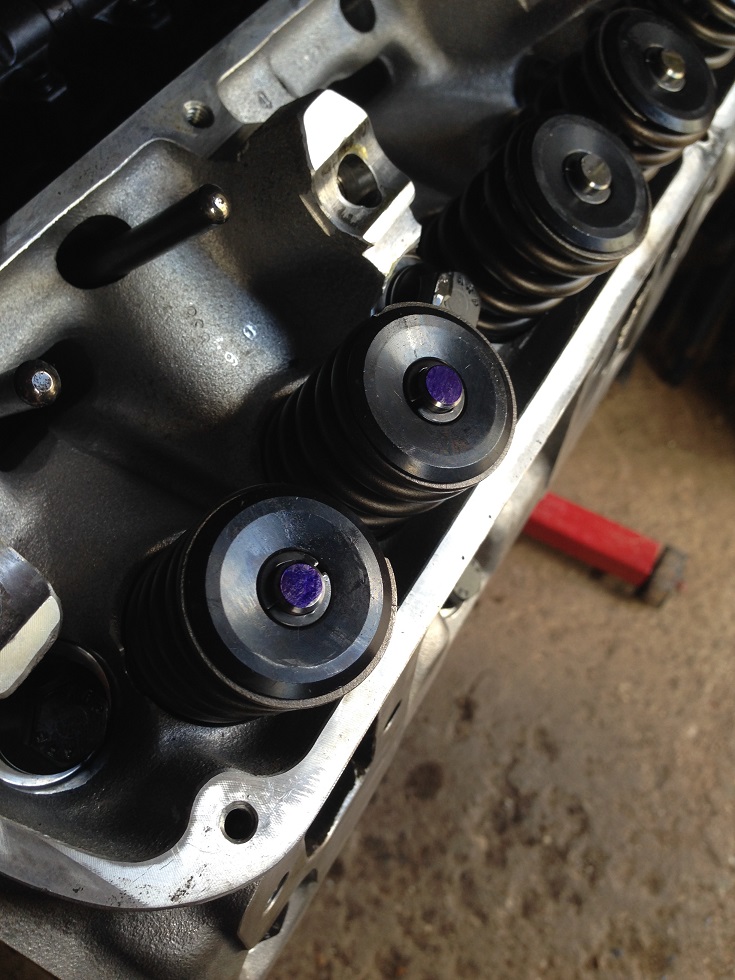

Prior to setting number 1 up with an inlet and exhaust valve etc. I marked the top of the valve stem so I can see how the roller rolls across the top of the stem this tells me if I have the correct length push rod. If the mark is too close to the exhaust side, the push rod is too long, too close to the inlet and the push rod is too short, you want it as close to the centre as possible. This as close as I could get it without running out of adjuster thread. You need an adjustable push rod to get the correct length

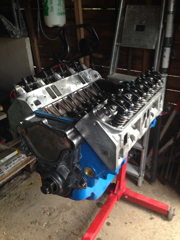

And all bolted on, it just so happened with the cam that's gone in a set of 273 pushrods where the perfect length.

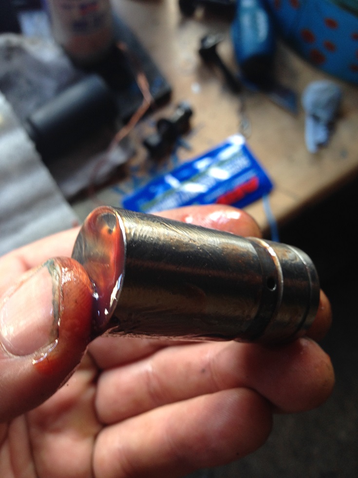

The lifters got a good coating of bearing guard before going in too

Carl wrote:Prior to setting number 1 up with an inlet and exhaust valve etc. I marked the top of the valve stem so I can see how the roller rolls across the top of the stem this tells me if I have the correct length push rod. If the mark is too close to the exhaust side, the push rod is too long, too close to the inlet and the push rod is too short, you want it as close to the centre as possible. This as close as I could get it without running out of adjuster thread. You need an adjustable push rod to get the correct length
I think you need to shim under the rocker shaft to get the mark dead centre on the top of the valve stem. I think 20thou shims are available?

Yes your probably right I was thinking that too :thumbright:
I need lash caps I recon, lifting the rockers will push the roller closer to the exhaust side. I need to bring the rear of the rocker down and the roller side up to bring the roller closer to the centre of the valve stem, shortening the adjustable push rod and setting the lash to get it anywhere near the centre of the valve requires the rocker adjuster to have to wind down too far, I could get longer valves, another alternative is to have the pedestals milled down, or I need another set of rockers?

Carl wrote: lifting the rockers will push the roller closer to the exhaust side.
You sure?
Raising the rocker will mean it has to rotate down more. It rotates in the direction of the inlet side yes?
I might be wrong. You had better check.
