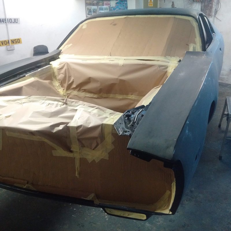

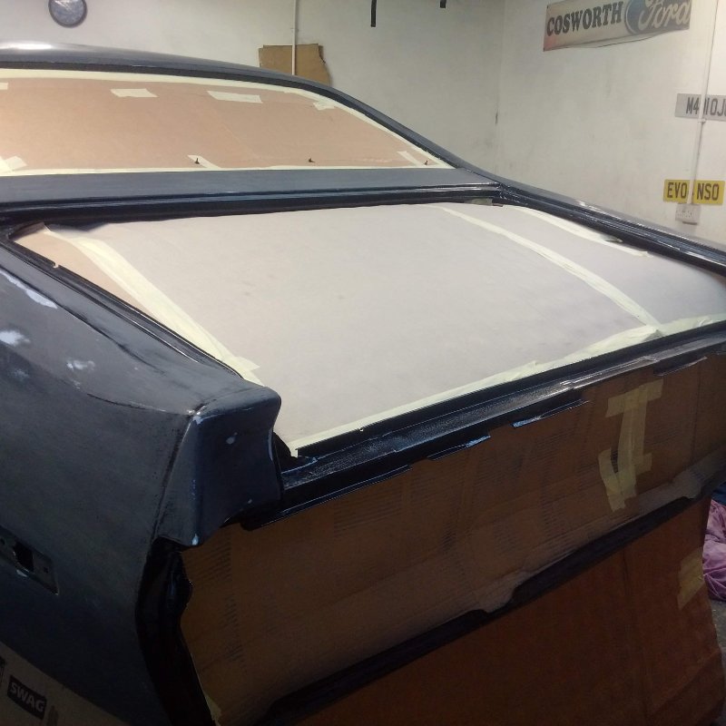

Ah well it's the end of the Feb half term week and... I didn't manage to make the trip North, the island was locked down due to a large number of covid cases.
Going try again at Easter all being well and it'll give me time to collect a few more bits.
Stephen sent some photos through last night of the shell in it's guide coat, so here's couple.
