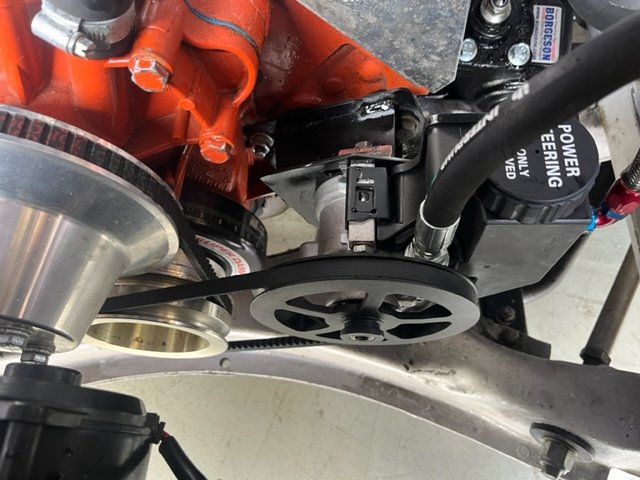

Well Speedfest was mechanically eventful.
Spent the previous three days fitting power steering - a GM Type 2 pump and Borgeson box. I'll post details later of the conversion. It worked fine in the yard but no time to really test.
Qualifying - absolutely brilliant steering for around 6 laps then lost assistance. Pulled in and drove back to the paddock. Belt still attached, but the fluid had got hot enough to soften the plastic reservoir on the pump, allowing the return line fitting to pull out of its boss. Fluid everywhere. And even the surface of the PS dipstick had melted.
