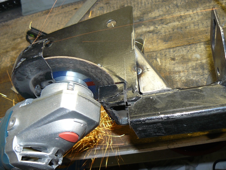

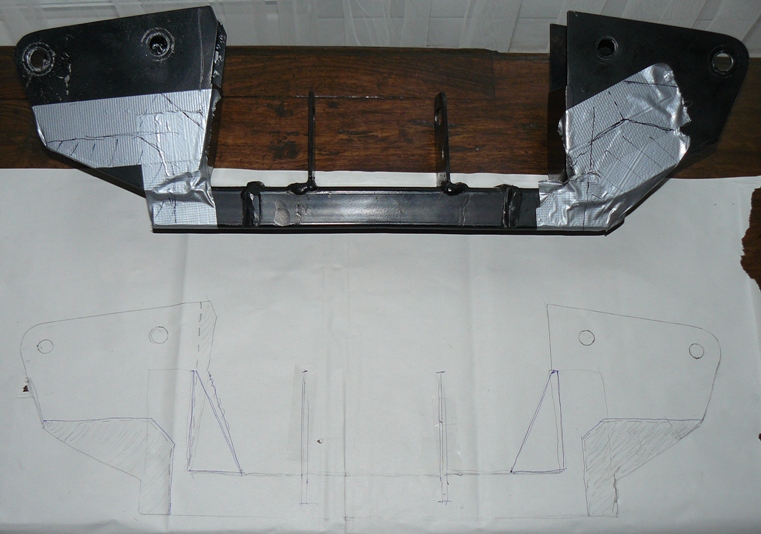

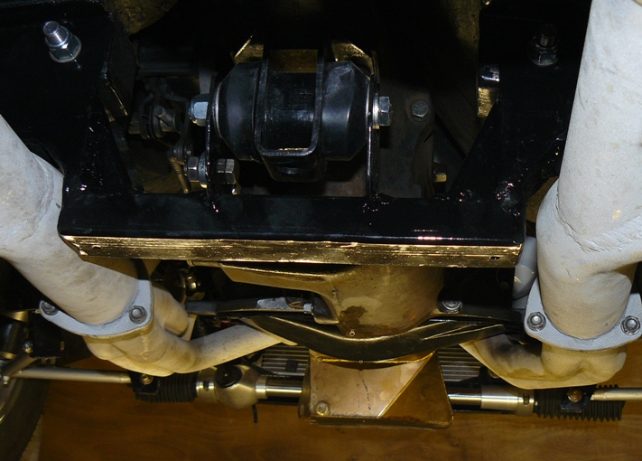

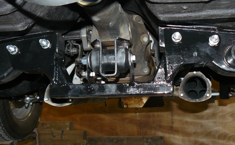

I rebuilt my trans mount over the weekend to clear the exhausts...
14 Done and fitted.JPG (187.8 KiB) Viewed 848 times
13 Brace tacked, cutting out.JPG (222.17 KiB) Viewed 848 times
12 Checking pattern.JPG (202.22 KiB) Viewed 848 times
11 Trans mount marked up and pattern.JPG (185 KiB) Viewed 848 times

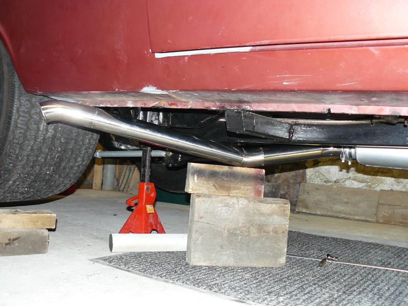

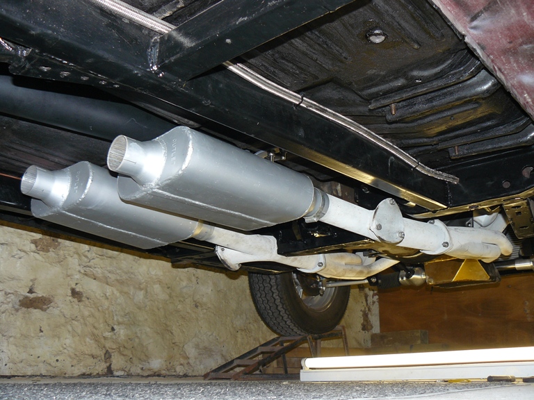

... & fitted my new Thrush Mufflers ( :lol: )

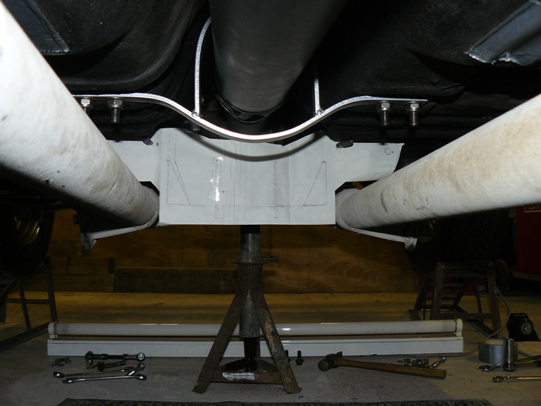

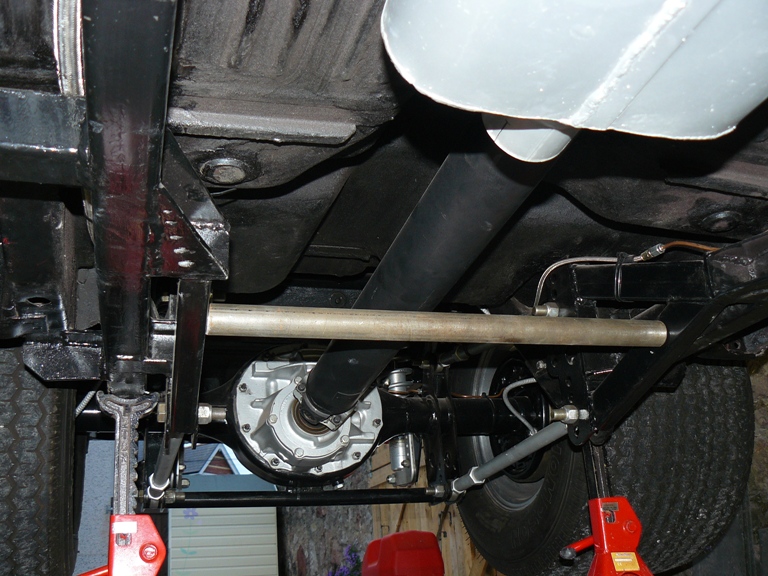

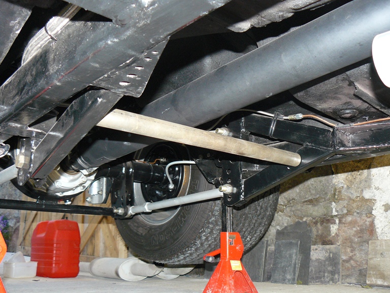

Remember you were concerned i should have a brace of some sort across the front of the 4-link mounts? Now i know where my exhaust and prop sit i can do that.
Have a look at pics 3 & 4 please mate, does that look like it'll do the job?
What's anyone else think?
4-link front brace 04.JPG (232.57 KiB) Viewed 843 times
4-link front brace 03.JPG (231.21 KiB) Viewed 843 times
16 Silencers fitted.JPG (244.6 KiB) Viewed 843 times
15 Exhaust clearance.JPG (199.4 KiB) Viewed 843 times

Posts: 6739
db wrote:Ivor-
I can't see an axle locator in the photos, is this to be fitted later, or I should say it must be fitted.
The axle locator is to stop the side forces on the axle, the rod ends in the 4 Bar are set up for rotational & forward/aft forces.
The axle locator needs to mount to the chassis & the axle case and needs to be able to pivot, to follow the Arc of the axle (up & down movement)
There are numerous methods you can use, such as sliding link, watts linkage,track locator,etc,etc,
With regard to the brace shown in pics 3&4, how much clearance between the brace & prop ?
Me personally, I am never a lover of exhausts that exit to the rear tyre, purely for the fact if something catastrophic goes wrong the motor. It's being dumped on to the rear tyres, to give you the added interesting ride to your woes .....
I'm not criticising, as I think your doing a great job
