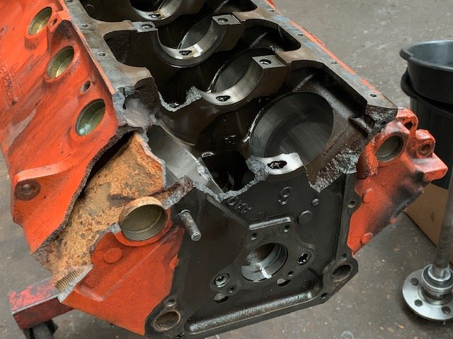

I was going to strip and rebuild the engine properly over the winter , but it turns out the engine had other plans.
Donington , September.

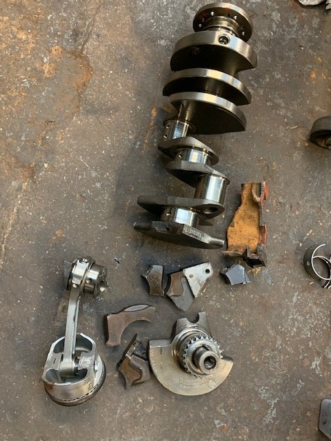

Sudden bad vibration whilst racing, quickly followed by a very big bang. Coasted to a stop, fortunately out of the way.
Looks like the crank finally let go. It's had a good innings, in fairness. A forged crank was specced when building the engine, but for some reason ( I have long ago forgotten any explanation for this - probably availability) I ordered a cast one instead.
Well it was the last race of the season, so probably the best time for this to happen.
I had a spare 360 block that I picked up a couple years ago in case I needed it. Stroker cranks, however, (either Eagle or Scat) not showing in stock on Summit etc .
Kev Borland who races with me said to try Hausers, and it turns out Geof can source an Eagle crank. Whilst on the phone to Geof about the crank I said - 'Geof, can you just build me the whole engine?' , and that is now what's happening.
Now that I've got a couple of years racing under my belt, and I don't appear to be a severe hazard either to myself or others, I think I'm ready for some more horsepower.
Geof suggests that with a custom cam grind, improved valvetrain, and better breathing , the compression can be raised quite a bit. All this will add up to a fair amount more horsepower (quite how much I'm not going to guess at until the dyno results are in)
The main hold-up will be the Mahle pistons which are looking like about 12 weeks at the moment, although most of the other work can be done in the meantime. Hopefully back in the car late March 2023 in time for the season.

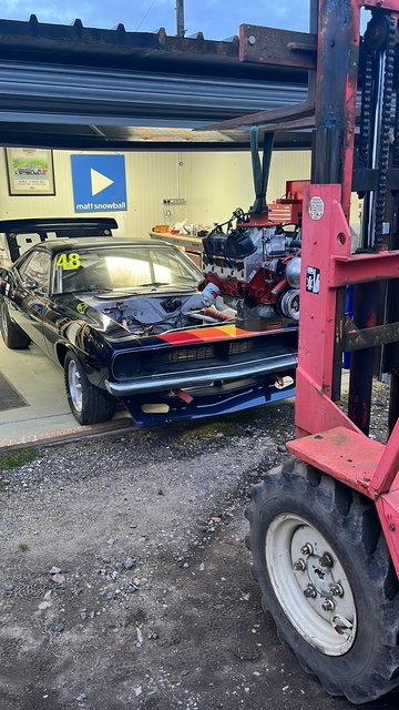

Winter workshop update :

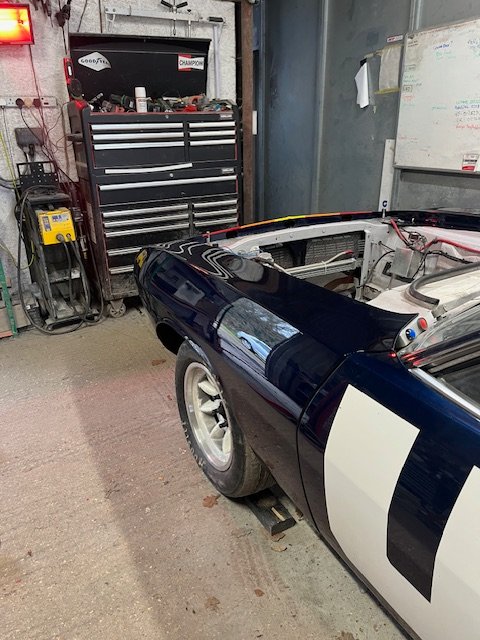

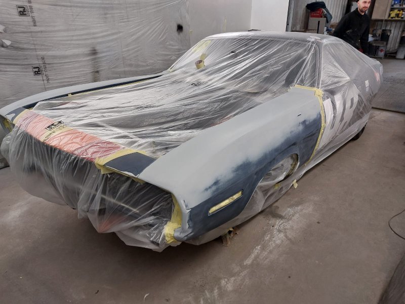

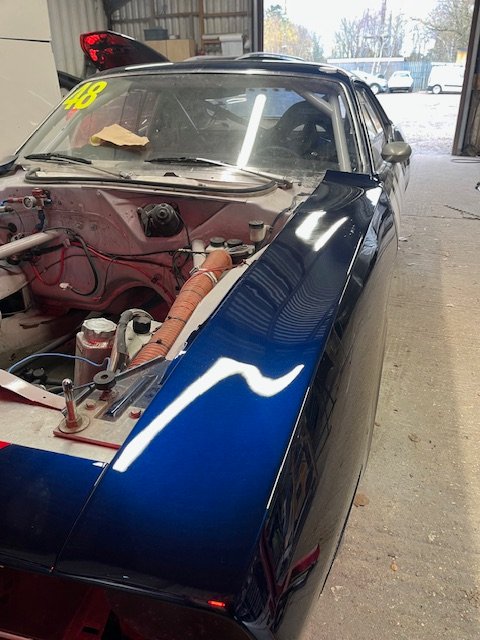

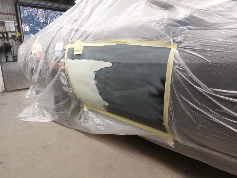

Had the passenger door and front wings repainted.
The wings in particular were quite badly damaged from gravel. It sticks into the hot tyres then flies off like bullets when you go fast, putting horrible outward dents in the top surface of the wings. The painters scanned the existing paint to get a formula, and the match is absolutely unbelievable.
Engine going back in after freshen-up. Custom Mahle pistons now installed. 558HP on the Dyno.

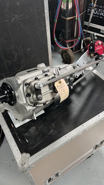

Changing the Tremec gearbox out for a new Roltek straight-cut dog engagement 4-speed, with lightweight flywheel and clutch
Fitting proper racing brakes to the front.
Updates coming over next few weeks - first race Silverstone 18th April

by Matt74
The body shop has made a lovely job of those wings.
Is there anything you can do to prevent the damage from reoccurring?
Posted: Tue Mar 25, 25 12:08 pm
by mygasser
Matt74 wrote: Tue Mar 25, 25 10:03 am The body shop has made a lovely job of those wings.
bed liner sprayed on the underside will protect it, maybe thicker directly in line with the 'spray' of stones. the issue is it'll add weight to a race car so the extra hp will be handy, lol
