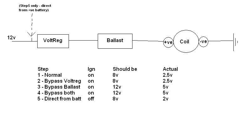

OK Gurus - Here is the latest. Did some proper investigation tonight and the results are very strange indeed.
Essentially the components appear to be working as they should (voltage reg passes through (which is all you can expect with no alternator) and the ballast appears to drop the voltage. Trouble is the voltage is nowhere near where it should be.
Its 12v over the battery (obviously) - but everywhere else it drops to about 5. Just makes no sense....
A sinplification of the ignition system is thus (see diagram). At all points I am measuring over the coil. Up until step5 I had assumed my investigations were pointing towards not getting enough voltage being supplied from the dash - But then I went straight from the +ve to the volt reg - still got the same results.
So even when I bypass both volt reg and ballast I still only see 5v at the coil??!? huh ?
Of course what my diagram doesnt show is all the ECU hanging off the -ve coil etc. So does this mean it MUST be in there somewhere ? How can it be - AdeW has tested ECU and it fires.
Oh, and yes - I have checked all my earths - even made auxiliary straps to double check.
Any other checks ? Getting very sad now...

Dave - Will do also. Although given item 5 above (where I jumped the +ve straight to the voltage reg therefore feeding 12v directly to it, bypassing the dash completely) it would seem to imply the voltage-muncher is in the ignition somewhere...
Does that make sense ? 12V delivered direct to volt reg has been munched down to 5v by the time I measure at coil.
Tonight I will jump coul to +ve just to prove spark (this will be fine I am sure).
Only thing left if that ^$&^%$ ECU again ???? Which means its now eaten 2 orange boxes and a blue-generic one.
Alternator and volt reg changed, so shouldnt eat any more - but SOMETHING is munching the volts. Something in the ignition circuit - and I dont think its regulator or ballast. Not much left :shrug:
Anyway - Will try as you suggest.

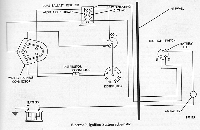

see i'd expect to see 5 volts off the field connector on the voltage regulator at idle when the battery is charged
i.e it powers the alternator at idle to put out a trickle charge
once you battery gets a bit flater the volatge off this pin increases driving more current through the coils in the alternator thus making more charge (from the rotary energy provided by the running engine) to top up the battery again
sure you have it wired correctly?
showing me a picture is no good as my 1970s aussie mopar is basically a 1962 valiant in all but body...yours is kinda like magic rocket science
with its new fangled ways and that

For the rest of you its moved on a little. Getting my 12v out of bulkhead. ( good). Everything pointingnback to module again when i decided to jump coil direct just to ensure spark -nothing. And now i get no readings at all from it !
So - looks like coil may be fried (too)
For the money this is going to cost I can near-as-dammit rip it all out and put a self contained dizzy/ecu/reg/12v setup in...
The difficulty with isolating this is being unable to test components. When someting is physically broken you can see it to fix. With this, there are multiple potential sources. What you need is a running setup on a car or test bench where you can plug bits in until you find the one that stops the car.
I'll get there. But its maddening in the meantime....

Right. The diagram posted. Let me see if I can help you test this correctly.
Replacing one bit at a time is NOT the way to do it!
Remove the multi-plug from the orange box unit. When you look at the plug connections refer to the diagram i just posted so you kow which socket in the plug I want you to test.
Turn the ignition ON.
Ground the -ve lead on your voltmeter and connect the +ve lead to #1 terminal on that plug. It is normally a blue/yellow lead going to that terminal. The voltage should be within 1v of battery voltage with everything else in the car turned off. If it isn't you have wiring problems.
Do the same to terminal #2 with the black/yellow wire. Again voltage should be within 1v of battery voltage.
Now check terminal #3 IF USED. Should be within 1v of battery volts again. Not all set-ups use this terminal though.
If you look at that diagram you ca see that these tests are checking both the coil and ballast resistor. Note also how the resistor is by-passed to terminal #1.
Turn the ignition OFF.
