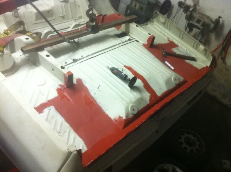

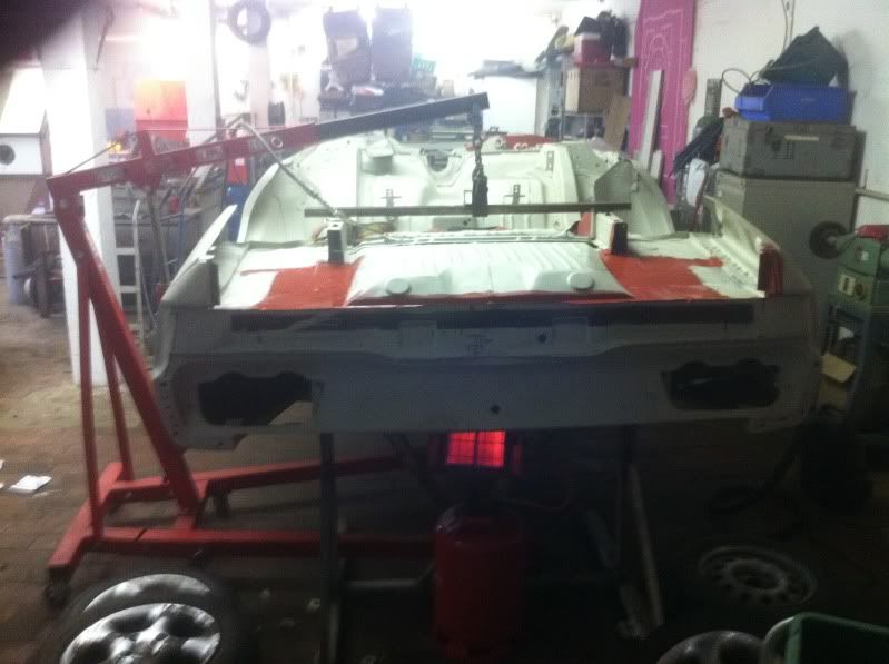

Well i have now finshed my sand blasting tank and it work really well.
Using a tank type sand machine which has loads of power.
xxxx
I started cutting and making patch panels but work is slow with a hammer and vice

Again, I am struck by just how cool your rotisserie is.
Doing underneath mine took me weeks of scraping and painting by hand. You are going to be able to do a great job there will. Keep it up :thumbright:

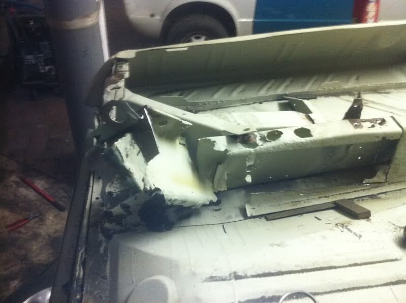

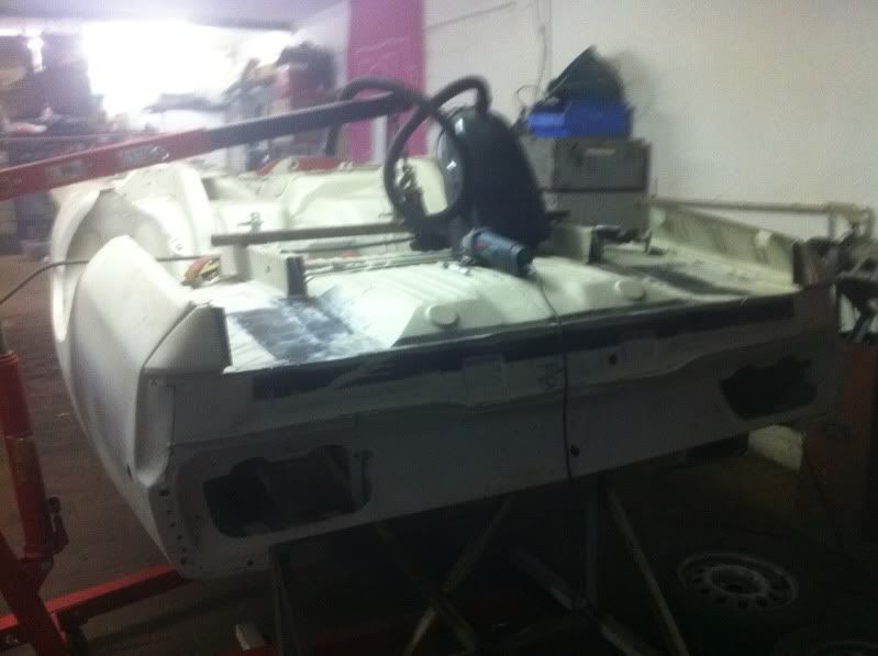

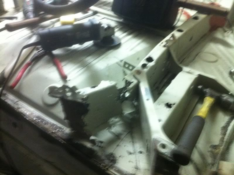

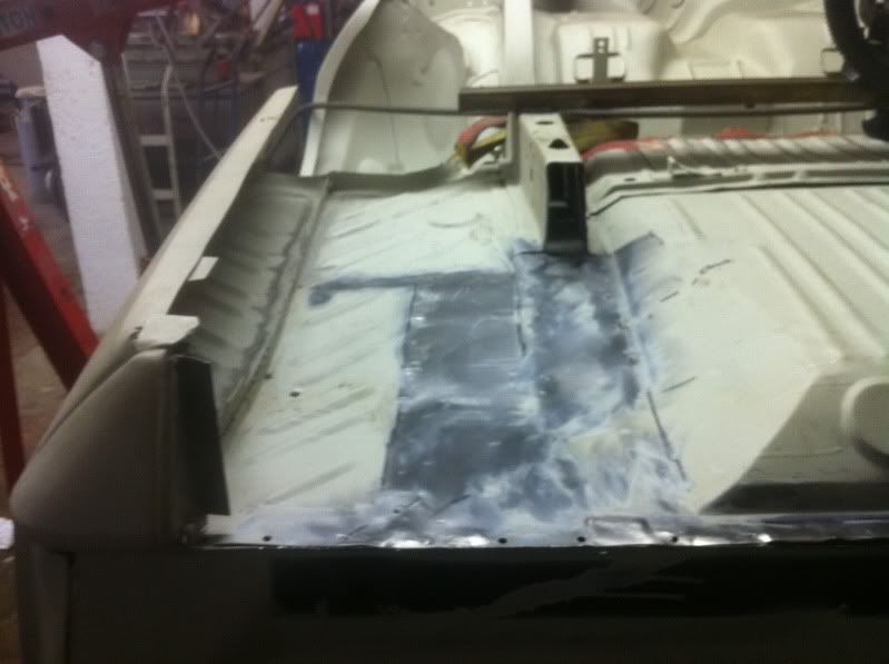

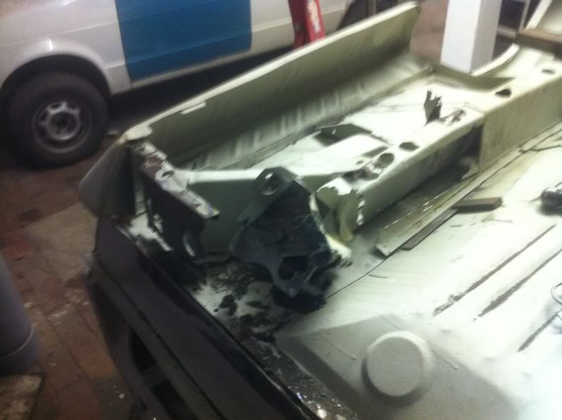

Had to remover the rear rotisserie holder to gain access that was a brown paints moment.
The rear spring holder where held on with 2 spot welds :shock: so they came of to . Rebuilt them and sand blasted

Posts: 5239
awesome work chap :thumbright:
i take it the trunk floor has already been replaced??
Scary stuff!!
Well done chap, great work there 8-)
Charger wrote: i take it the trunk floor has already been replaced??
Yes but they didn't weld it in so have been over all welds.

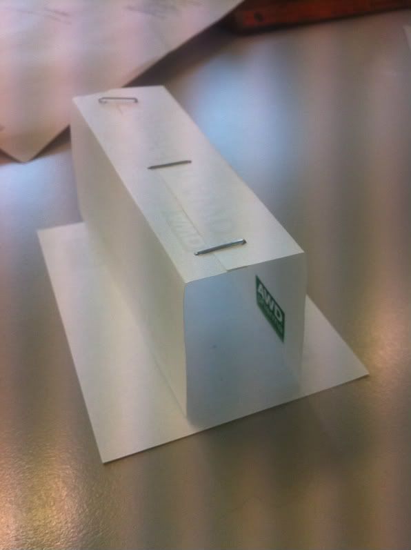

Q. Back to paper on desk car i make my rear frame rail out of 3 pieces.
Should be stronger and look original any reason why not ??
:help: :help: :help: :help:
<a href="http://photobucket.com" target="_blank"><img src="http://i73.photobucket.com/albums/i205/ ... e150-1.jpg" border="0" alt="Photobucket"></a>
Go for it. :thumbright:
Requires more metal and more welding but less bending and stronger.
And if you were attaching it to a non-flat surface, you can bend the base section to a perfect fit and profile the box sides to match!
Like it :thumbright:
