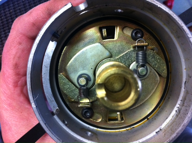

Pulled the distributor out to put FBO plate in and found it looked completely different to the one I had practised on!!!! Looks like it already had some sort of limiter plate already on.....Emailed Jon (Turnip) a pic and he told me that it did look like it already had a some kind of plate on. Had to put her all back together as kids wanted some attention. Fired Up straight away and just left her at 26 deg initial.

- distributor.JPG (137.04 KiB) Viewed 1028 times
you might have an issue running that much timing 36 deg int is way too much you should only need between 12-16 and the total no more than 36 deg.
