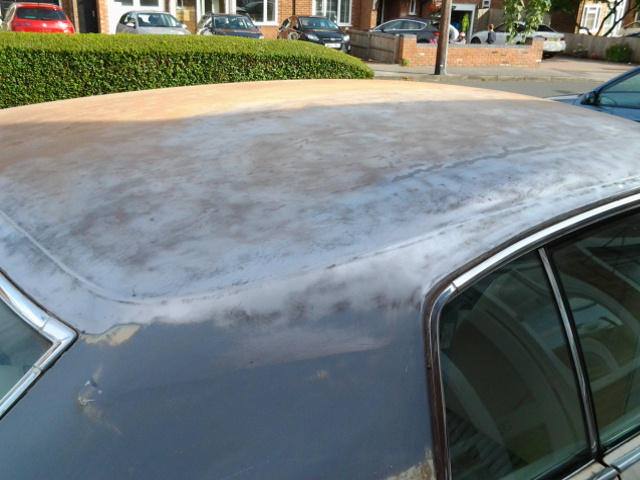

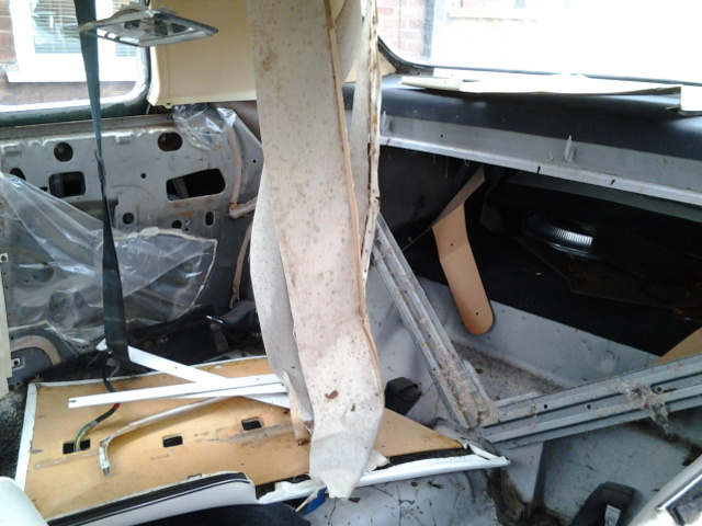

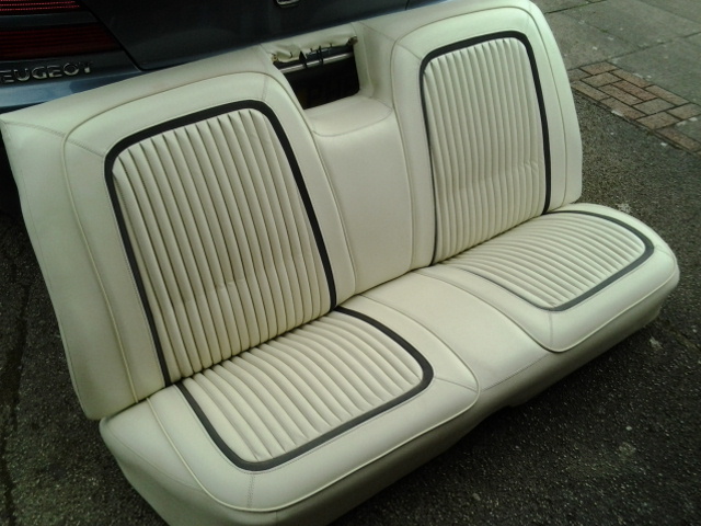

Chipping away at her....interior coming out, roof nearly back to metal, loads of wiring bits n pieces arrived this week ready for when bodywork sorted and relaxing session cleaning the rear seats. They have come up lovely!! Found another build sheet under the seat but its to fragile to remove. The text on it is perfect so I will photograph it properly and leave it in situ,

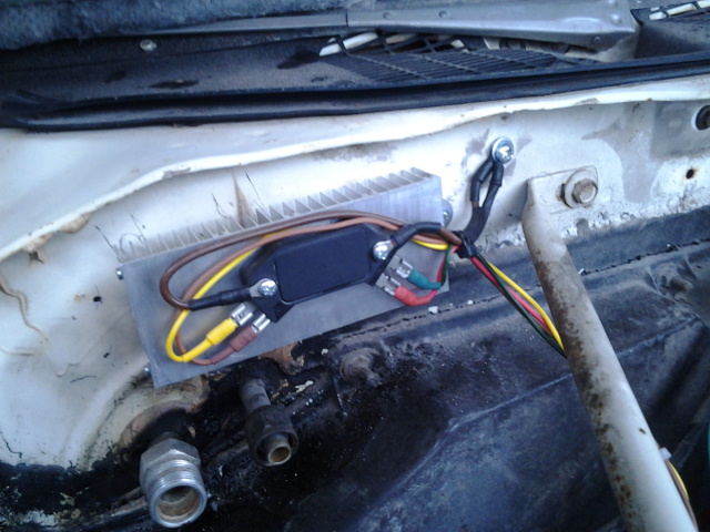

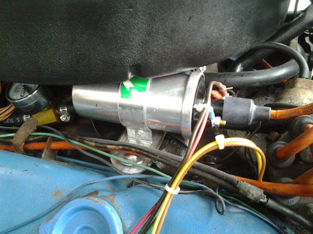

Back on my feet now after knee op so been getting stuck in again. Weather killing outside work so been concentrating on getting the various wiring looms for the engine bay made up. Ive stripped out the old ECU setup and have fitted an HEI unit with a high performance Lucas coil (much cheaper than a Blaster 2 and just as good).

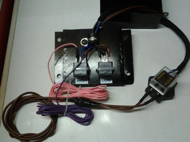

Ive made up the lighting relay box and its all wired up with new trigger wires etc. I will fit it to the car before I make up the new lighting loom. Im putting in Autopal dipped beam units and moving the sidelights up into them from the indicators.

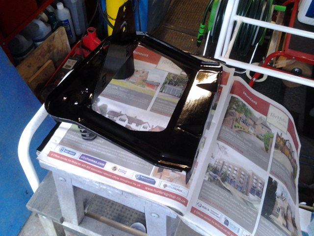

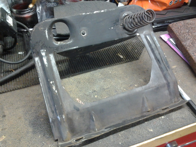

Been painting bits and pieces as I take them off so they are done ready to go back on when I get to the 'putting it back together' stage.

Most of the interior is out now ready for a bit of welding in the drivers footwell, and to prep the roof for a new headlinng.
This is becoming a bigger project than I first thought!

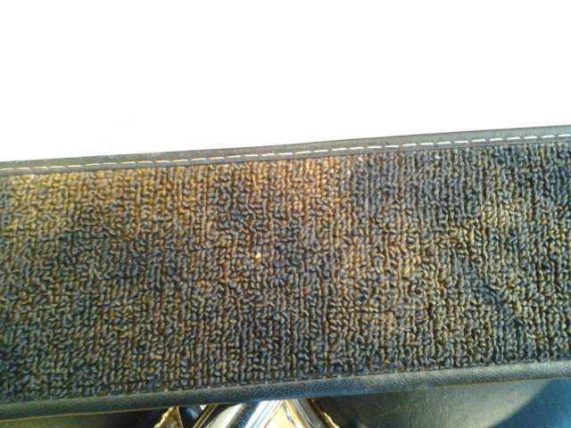

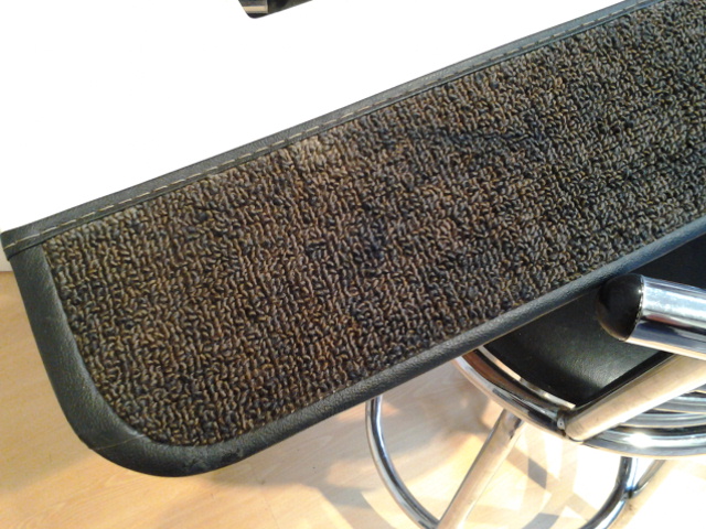

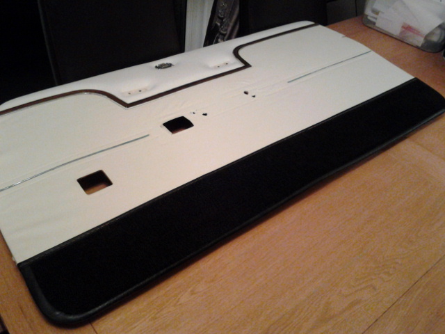

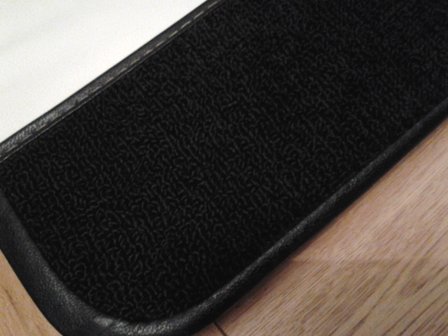

Few more pics...,.recoloured the carpet on the doorcards while they are off...

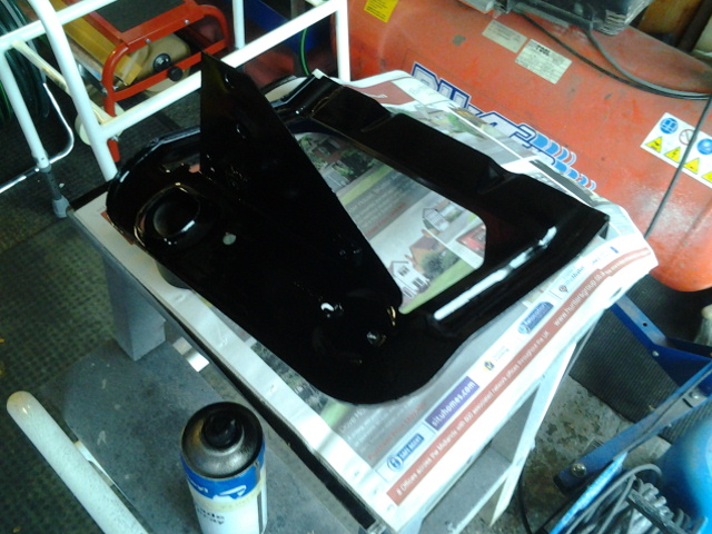

Last couple....just bits sprayed up while weather bad. Hairdryer has been working overtime! Cheers :thumbright:
Looking good Steve :D

Door card carpet looks great :thumbright:

BJ Mac wrote:Door card carpet looks great :thumbright:
Indeed - what did you use, Steve?
Posts: 7675
Thanks men...very slowly but starting to chip away at it.
Used the fabric spray from this company Pete....
https://www.fabricspray.co.uk/
They do leather and vinyl paint etc...great stuff! :thumbright:

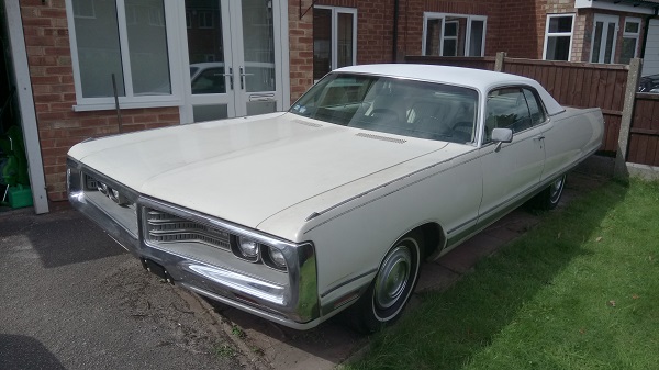

Been making a bit of progress recently so will do a proper update later with some photos etc.... back in the saddle as they say! :thumbright:
New yorker 2 resized.jpg (78.53 KiB) Viewed 2526 times
Posts: 14100
Jeeze, I forgot you had this! What a beaut :thumbright:
