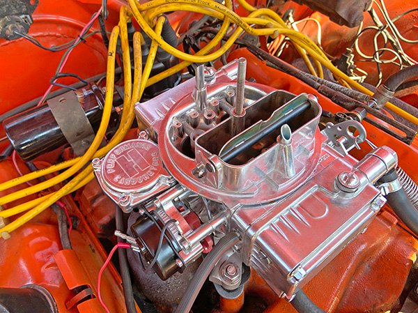

by Mark B
So ditched the troublesome Edelbrock and fitted a Holly. The performance is better. Also fitted a new PerTronix, new distributor and new spark plugs. Seems to be running better.
Holly 2.jpg (138.26 KiB) Viewed 2773 times
