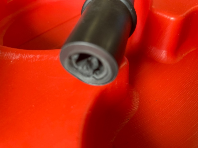

Well, seems to have cured itself after I turned it off to scratch my head, so connected the vac gauge to the manifold and got a wobbly needle, in time with the engine pretty much. Can’t post the vid here, sadly. Think I’m right that means I have a vacuum leak?
Anyway, I did learn the hard way that you should turn the engine off before you take the vacuum plug off.
Disconnected the gauge and looks like in just that few minutes the connector has melted.
I’m now concerned that the vacuum plug I have in the back will go the same way?

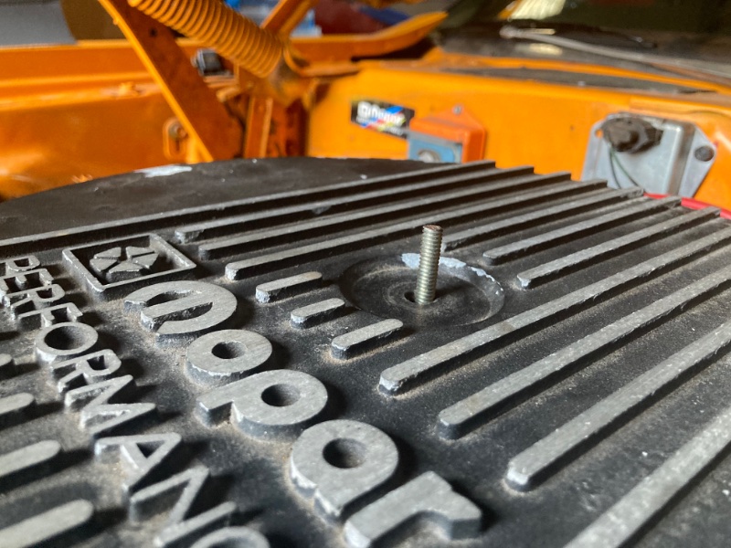

Finally found a drop filter base the right size and much happier now, that’s given me an extra 3/4” and who wouldn’t be pleased with that.
On to the rear end again now, todays job is to refit the lights. Got replacement studs and sorted the gaskets out, so once I know they are all straight, I can figure out how much more adjustment is needed on the bumper and light surround. Also finally got the correct fittings for the rear valance, so fingers crossed should all sit better by tonight.
Only head scratcher for now is, the throttle bracket was stuck solid this morning when I came to adjust the lockdown. No idea why.

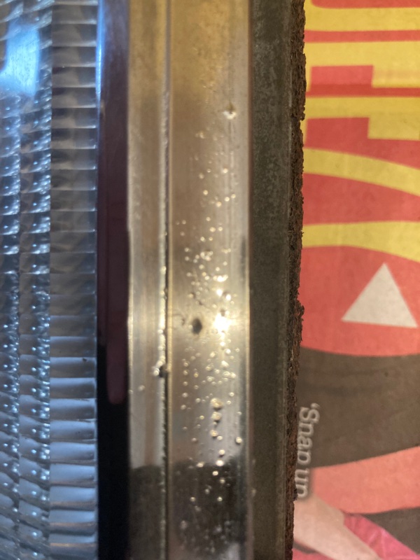

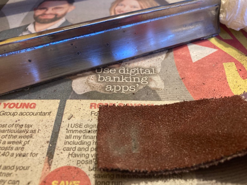

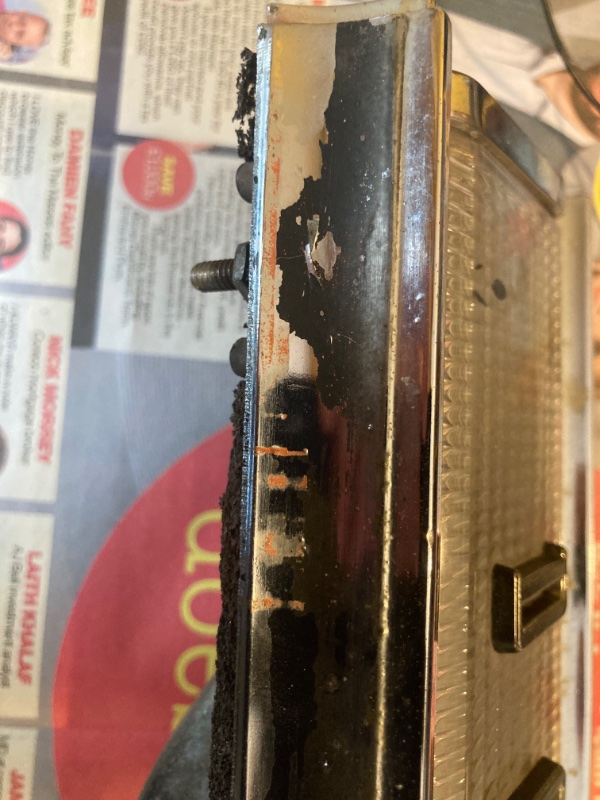

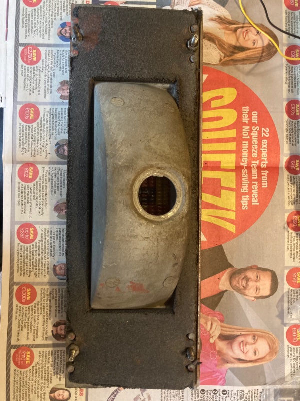

Anyway, turned my attentions to the rear end again and pulled the bumper and lights. I’ve finally managed to track down some of the chrome paint I wanted, so set about cleaning the lights and seeing how well the surrounds will come up. Centre lens has come up great and managed to sand out the blemish that’s been getting on my tits for ages. Happy with the slight patina on the lettering, so that’s done. Gasket was glued on like, well, glue! Finally got that cleaned up and have good replacements, so all that remains are the surrounds.
They are in a right state and badly pitted, but didn’t want to attack them with power tools, so settled at the kitchen table with some emery board and set about them.
How wrong I was. Thought the issue would be not sanding them to dust, but turns out they are hard as nails and the pitting takes shed loads of elbow grease and barely touches the finish. Not easy with the onset of arthritis, so may resort to power tools after all.
Still, much smoother than it was, so looks like it’s just a case of a few evenings hard sanding and should be ready to spray at the weekend. Small steps.
Some before and afters below. Nowhere near finished sanding yet.
