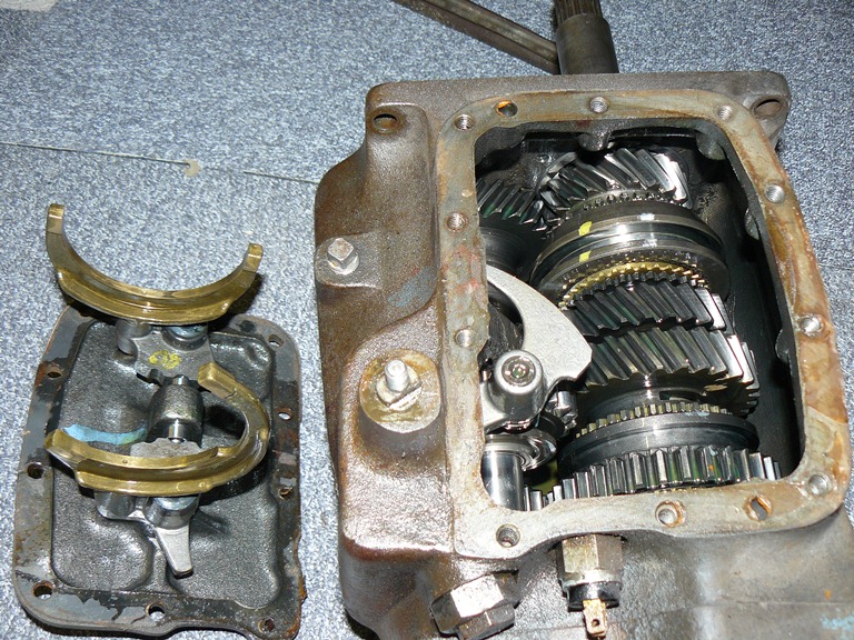

I've fully stripped the trans and checked everything for wear and damage.
The brass selector forks look a bit worn but I think they'll be fine.
The countershaft thrust washers need replacing.

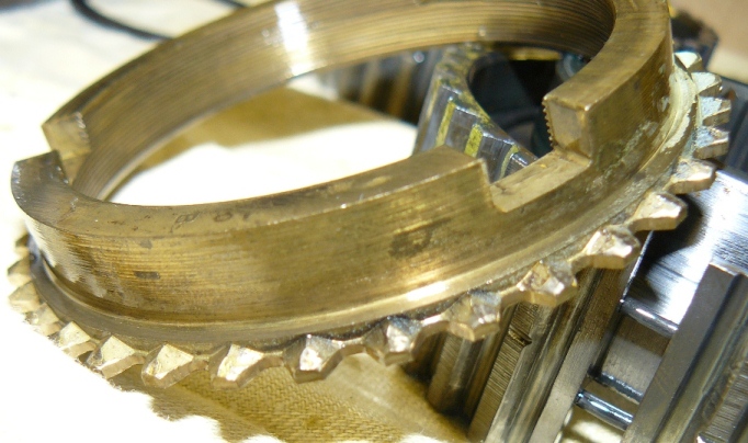

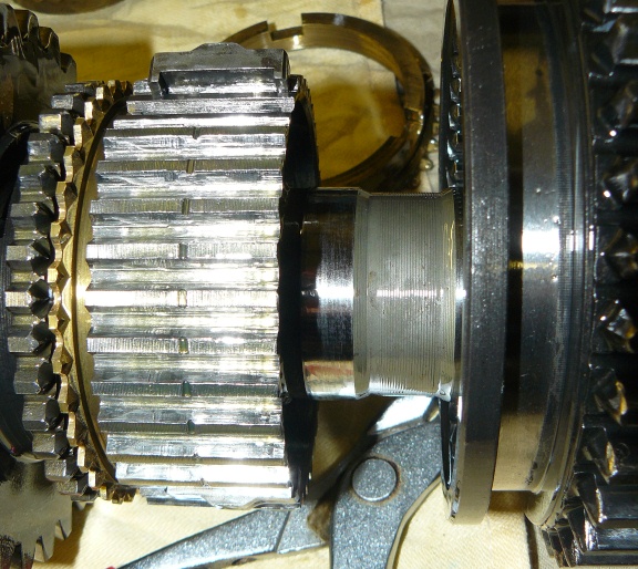

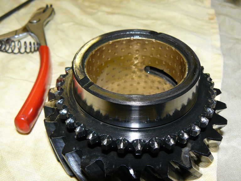

The synchros all have a bit of wear but the 2nd looks quite bad, the teeth are pretty rounded and 2nd was hard to shift into. At the very least the stop ring needs replacing. Ideally I'd renew the whole assembly but they're a bit pricey!
And finally- the input bearing is loose in the casing.
Wear on 2nd synchro teeth

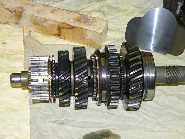

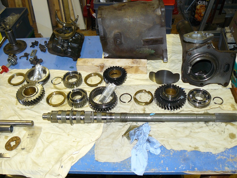

Right to Left: 1st, rev, 2nd, 3rd (4th is on input shaft)
4-speed 03.jpg (200.51 KiB) Viewed 1733 times

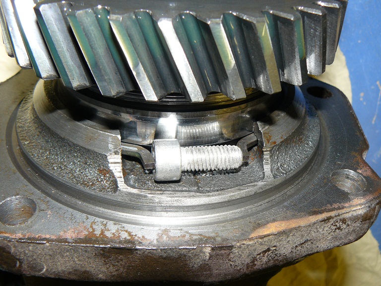

My trick for holding the tailshaft snap-ring open
4-speed 02.jpg (216.01 KiB) Viewed 1733 times
selector fork wear
selector fork wear
4-speed 01.jpg (238.13 KiB) Viewed 1733 times
Actually the previous pic might have been 3rd...
Anyway, on with the show, here's the 2nd synchro hub and stop ring and the whole lot spread out.

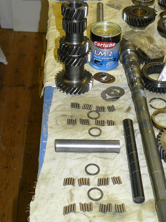

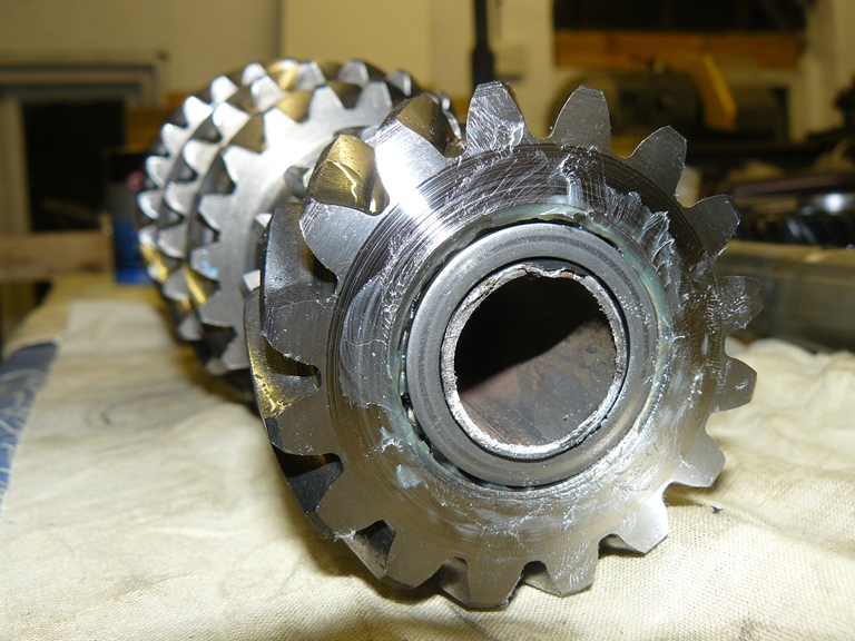

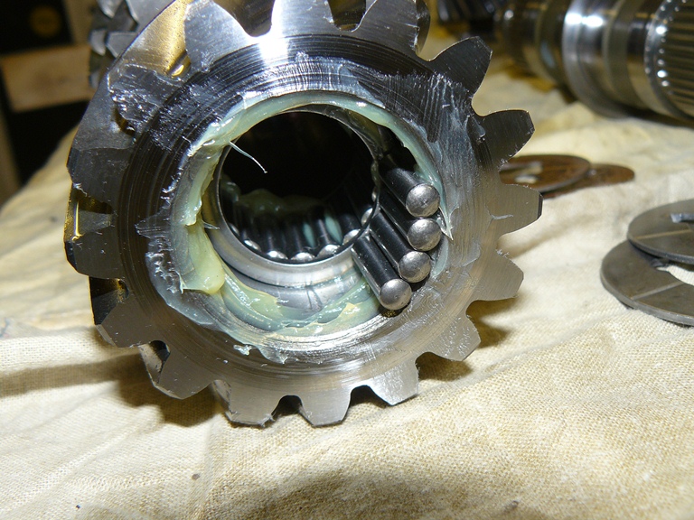

Anyhoo... here's the countershaft bits all cleaned and ready to assemble. Note the dummy shaft, I couldn't find anything quite right so carefully wrapped tape around a tube to the right thickness.
The rollers stick really well to grease so assembling that lot is no bother, it's all ready to drop in now :thumbright:
Countershaft assembled.JPG (216.63 KiB) Viewed 1640 times
Countershaft rollers.JPG (244.88 KiB) Viewed 1640 times

db wrote:I couldn't find anything quite right so carefully wrapped tape around a tube to the right thickness.:
Exactly what I did to load the bearings in my Aussie 4 speed, worked a treat and came out the other end of the box perfectly when installing the countershaft.
Did you accurately measure the length of your tube or test it inside the box with the thrust washers in place? Would be a pain if it's too long and wont fit.
If you find it is too long when try to install you can slide your counter shaft in place pushing out your tube to hold your loaded bearings and modify your tube then slide it back in again before installing.
Good writeup, glad you are enjoying the journey.
Thanks Steve, I think I measured the dummy shaft length by slotting it inside the gear cluster.
The Mopar mag guide says to stick the thrust washers to the gears but I found it easier to stick 'em inside the case.
There's a lot of juggling and straining and balancing and swearing and taking it out and starting again cos something dropped out or won't line up or just doesn't want to go in....
