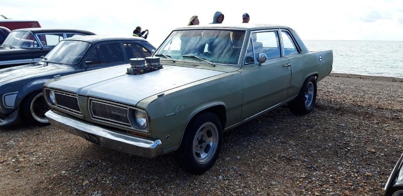

here's a couple of pics the meet photographer took last night
neil.

Two pics and then it was gone :shock:
