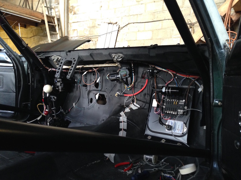

About time for an update! Been doing loads but not much to show till it all comes together. My intended front end rewire rapidly descended into a total rewire of the whole car, mostly done now and just needing a final tidy up.
I did a total system check on Friday and everything works as it should apart from having inadvertently having wired the side markers into the indicator circuit :roll:
Think I've just spliced into the wrong wire on one of the front sidelights so hopefully that will be an easy fix.
Before I switched on the power for the first time I made up a fused jumper wire to connect between the main live and the battery with a 7.5 amp fuse. That way if I'd got something catastrophically wrong the fuse will pop before anything burns. Once I'm happy all the ancillaries are right, it can be removed and connected as normal.
Moving the switches from the dash and fitting a larger fusebox in a different location creates about 3 times as much wiring as the standard set up even though I've only added a couple of extra electrical items, I'll have to count up how many wires are in the main loom, it's a lot, thank god for thin wall cable!
