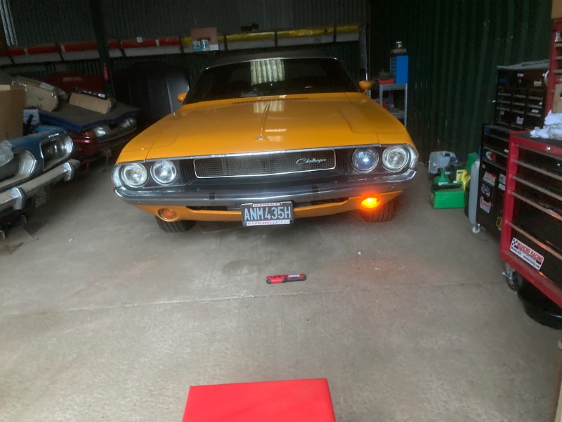

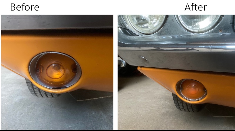

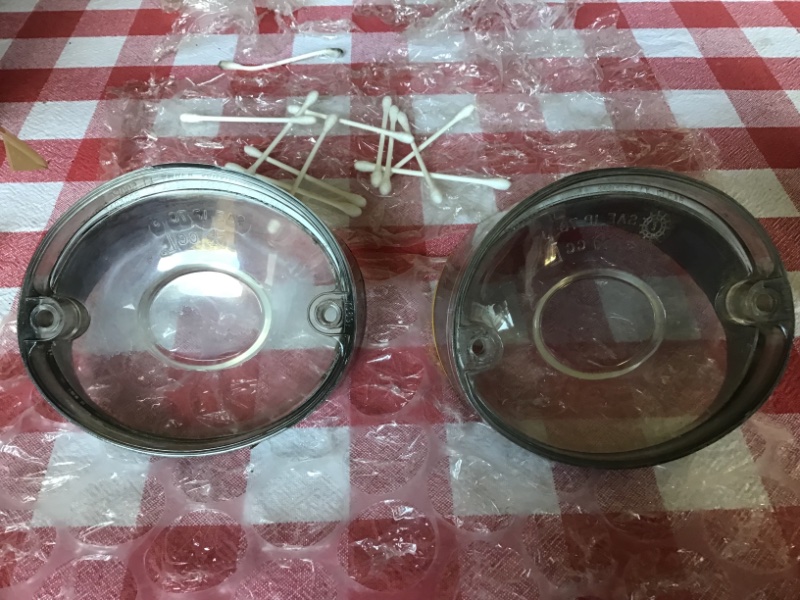

Todays 1 handed project, front indicators. Mine are both broken, passenger side has a big hole in the casing and drivers side lens is shot, cracked all over. £135 a pop plus shipping for re-pops, so wasn’t on the critical list! :roll:
I wanted to retain the amber lenses, as I didn’t want to be able to see the bulbs through them, but couldn’t find an undamaged set. Andy (mustangbooks) came through a blinder with some clear lens versions which were in good shape, though. :thumbright:

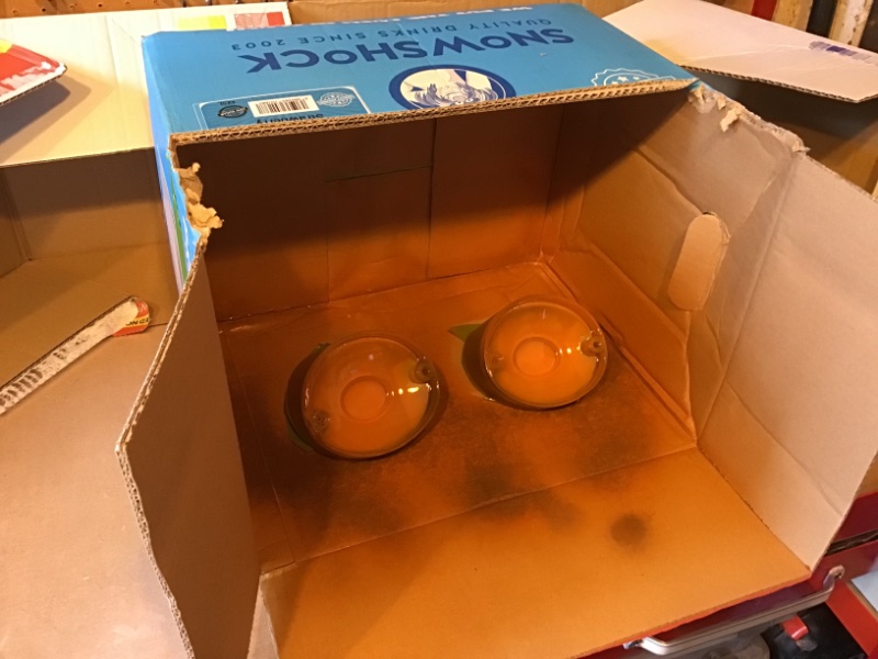

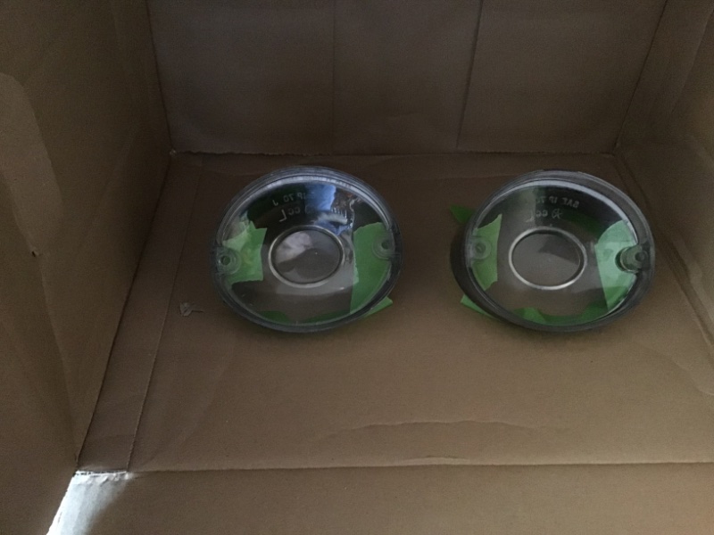

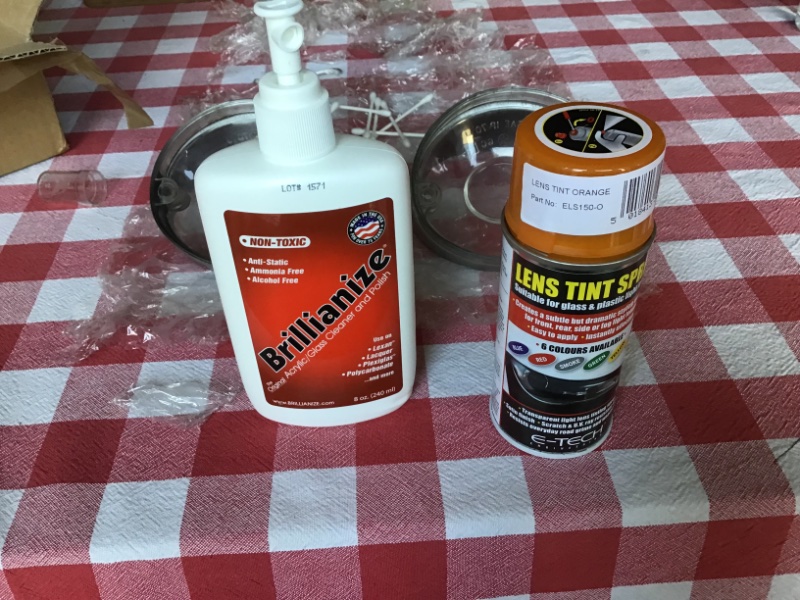

I took a punt on some lens tint paint off eBay, gave them a really good wash and then hit them with some acetate / plastic cleaner that I use for my turntable top to get the remnants and grease off. The spray went on ok, but very, very light, so over the course of an hour I emptied the whole tin on them, gently building up.

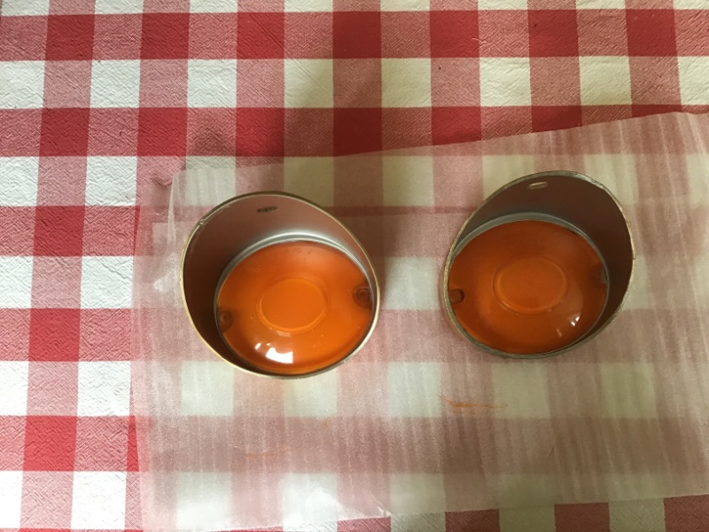

I wouldn’t say the finish is the greatest, but using a spare from Dougie (thanks chap! :thumbright: ) as a point of reference, I took it as dark as I could. The originals are a deep amber, the lens spray is definitely more orange and not as “clear”, but translucent enough that I think they will be fine with light through them. I may well use amber bulbs as well for a deeper orange. The key bit for me was not being able to see straight through them.
Also from Dougie was a set of new gaskets, so pretty happy all round for a £10 tin of paint, a few quid on postage for the gaskets and a couple of hours work.
I’ll finish them off with a chrome paint pen round the lip before I fit them, but for a 10 foot car I reckon I’m good to go. They look miles better than the broken ones and perfectly acceptable for a driver car. :rr:
Cheers Andy and Dougie, another job ticked off. :salute:

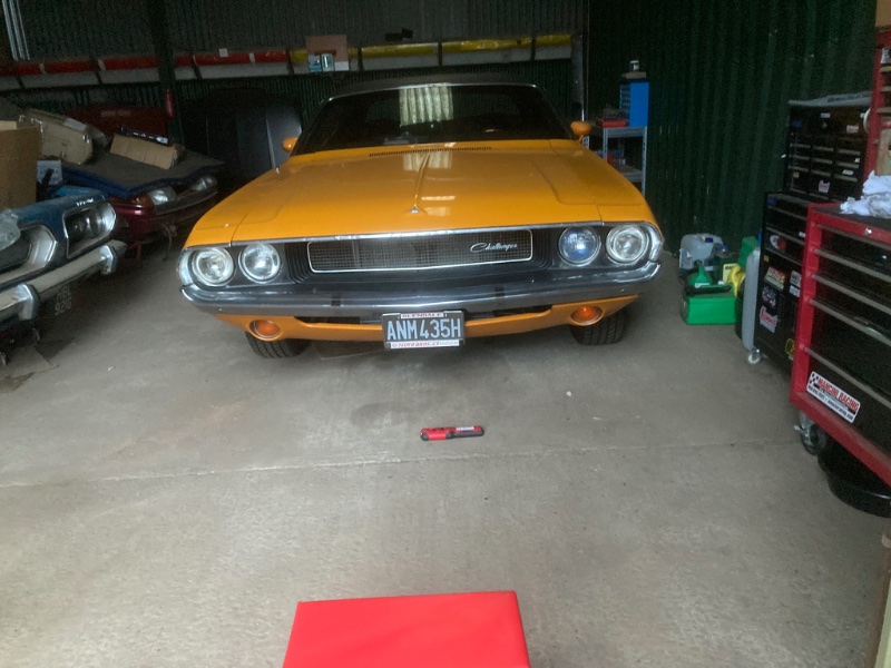

Managed to get them fitted left handed, what a game it is without being able to hold screws properly. :lol:
Happy with the colour of the flash, too! Nice and bright. 8-)
