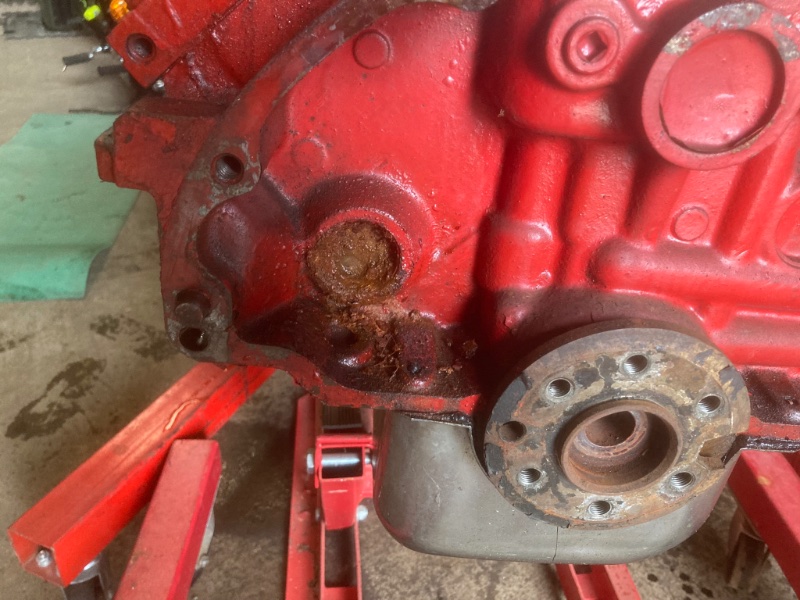

Fix the leaks, rear core plug is shot away for a start and sump needs replacing. Replacing the leccy fuel pump for a mechanical. Alternator upgrade. Fuel lines. Re-routing wiring under the fenders, lights upgrade and a trans upgrade. Decided to pull it all anyway as I’m planning to have the bay painted whilst I’m at it. The front has come off so I can refresh and paint the grille and sort the battered mouldings out. New bumpers and that’s about it, I reckon! :-k

Reckon that’ll be the leak from the back, then!

you will get full set of core plugs and do them all won't you? even if they look ok, they rust from the inside out. they're so easy to do while the engine's out it would be daft not to. :thumbright:
neil.
Posts: 7202
Yep, will do them all while it’s out. :thumbright:

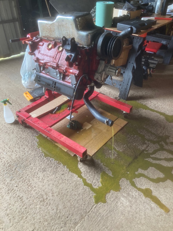

Posts: 7202
Well, it’s empty… #-o
T!@t… :roll:
2001 Dodge Ram Van
Posts: 22261
Don't you love it when it does that!

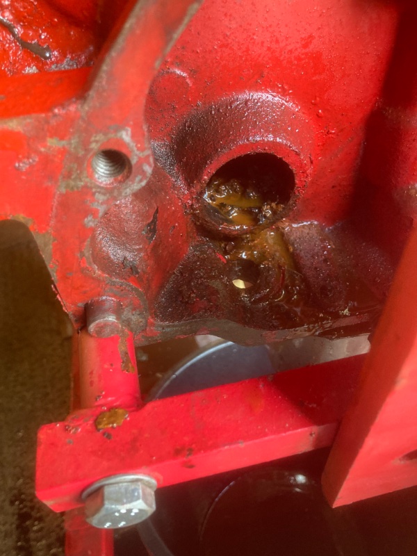

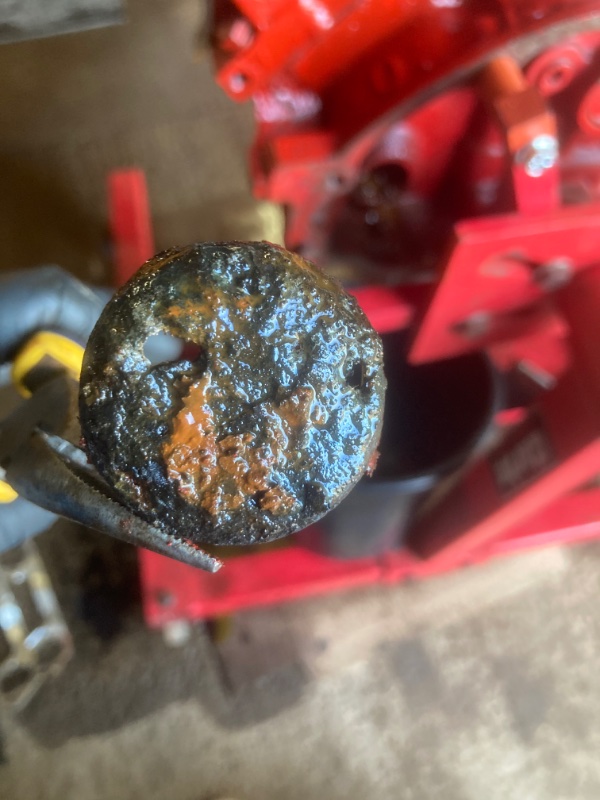

Posts: 7202
Yep, that’ll be daylight through there, then!
Some serious chunky, rusty sludge in the water channel once I’d removed the plug. :sad4:
2001 Dodge Ram Van
Posts: 22261
Result!! Worth the effort!
