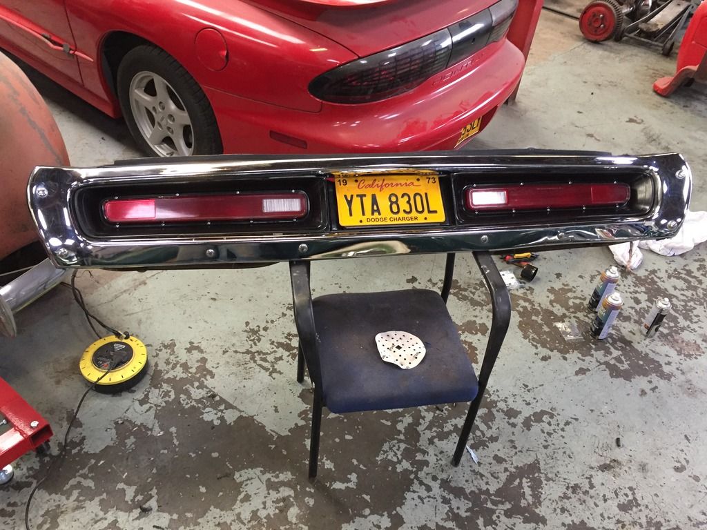

Whilst the welding was going on i busied myself rebuilding the back bumper with the new lights i bought. I'd already rebuilt the pods, and painted them, so it was just a simple case of dropping them in the bumper...
Quite a bit of grinding and drilling new mounting holes before they would fit properly. Anyone who tells you they're just a "bolt in" fit. They're not.
Anyway, got them all fitted in and spliced into the original loom. I think they look ace. Much more attitude than the sequential type 73 lights.

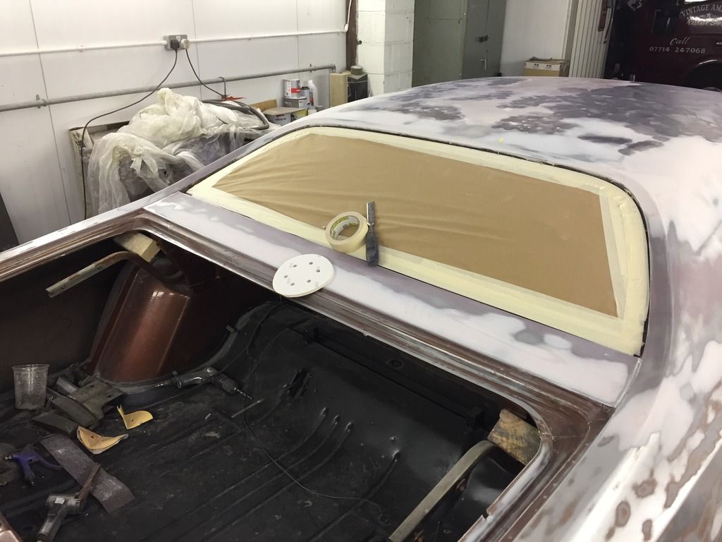

Yeah, if it was my own workshop and the time was my own, then you're right, that would be best. But we were happy that the screen surrounds are in good order and the screens don't leak.latil wrote:Going that far,I'd have had the glass out too. The area that rots the fastest and out of sight.
Once the paint is on, and new clips installed i'll be dousing the area in anti rust treatment to prevent any horrors down the line.
Good to see the vinyl gone, look much better without. Are those lights from an earlier car? looks better, the '73 lights are a bit "busy". No doubt it upsets the purists but I'm quite a fan of mixing and matching parts from different years to get a cleaner look, I've done it numerous times.

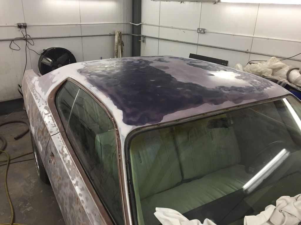

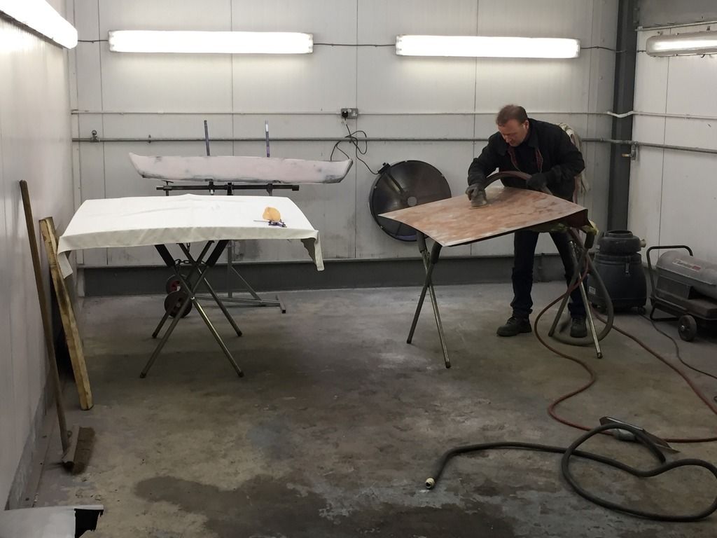

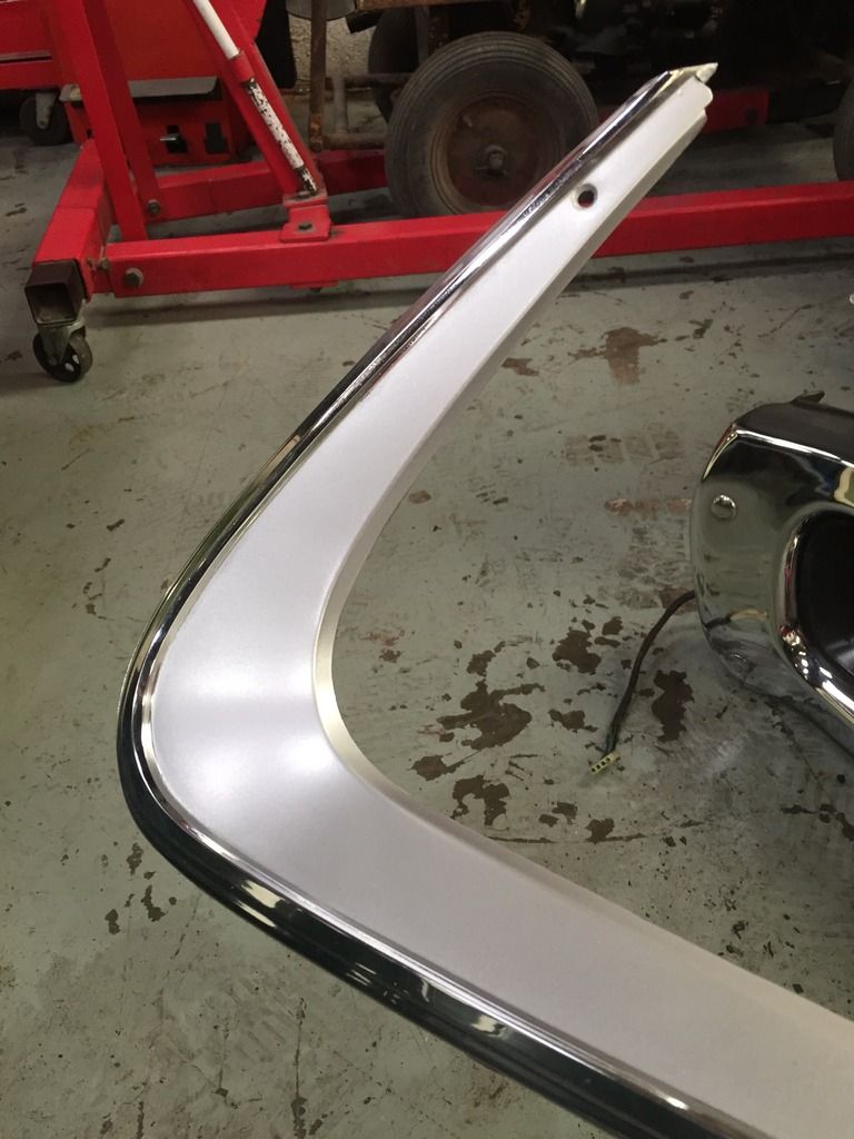

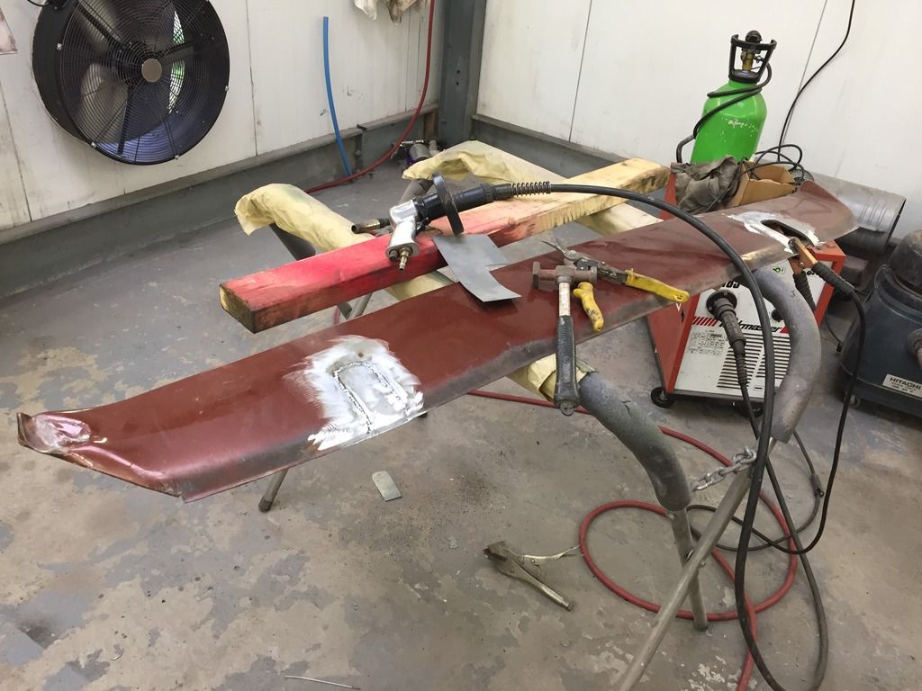

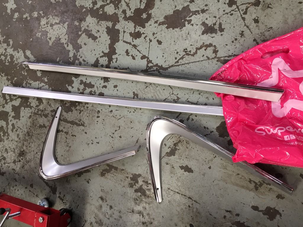

Last of the filler work today. Deleting the vinyl roof has added quite a bit more labour. Roof and surrounding panels needed quite a bit of fettling. Roof is back to metal today. I sponged on some rust eater just to be sure the tiny pock marks in the metal don't ever come back to haunt. For a purely cosmetic addition, a vinyl roof really doesn't do a cars bodywork any favors in the long run.
Rear valance came off today as well. I'd bought another to go on, but the original is so clean that we decided we're going to bash the dents out and re use it.
Went to the paint shop and bought a couple of litres of etch and half a gallon of Green Ti primer ready for next week.
I did get the first bit of primer on today though! Front valance has had a good slosh of hi build today.
Also restored the window surround trims, and they look fantastic.

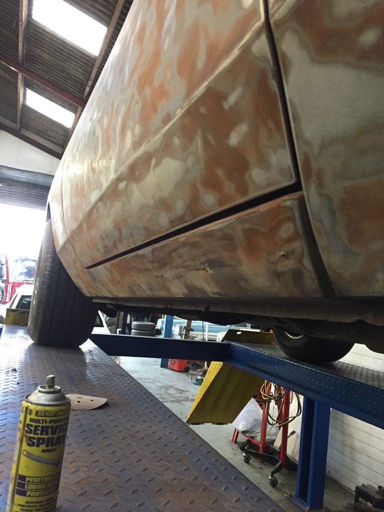

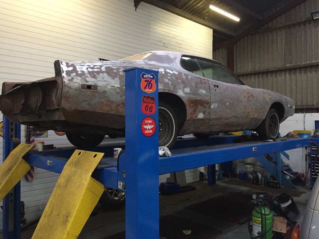

A bit more today. Got the car running and warmed up. Started on the button.
Removed the bonnet, and got the car on the ramp.
Then some moooorrre sanding on the sills and bottom of doors. Still can't believe there's no rust in it. Just as well, as i had my weeks bill from the workshop
Thank god i'm working on it too, as otherwise it would have been double.

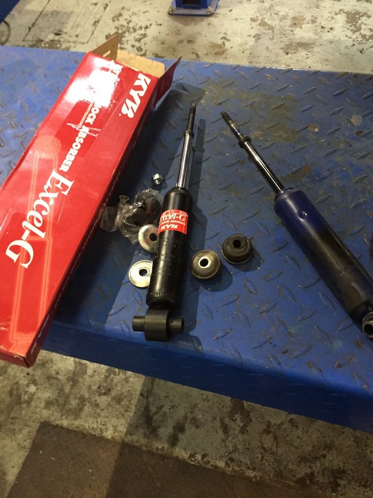

Whilst i was waiting for the air line, i busied myself fitting new front shocks. The old ones were absolutely knackered. No wonder it was so floppy on the front.
Top ball joints arrived from Rock Auto today. They don't really need changing yet, but the boots are all a bit mangled, and everything else is new, so i'll do them in the next bit of down time. (Then Turnip can have his socket back
Speaking of the rear lights, Blues right those are from the 72 models...ha if you like them go with them...to many people get hung up about that sort of thing...its your own choice...Blue wrote:Good to see the vinyl gone, look much better without. Are those lights from an earlier car? looks better, the '73 lights are a bit "busy". No doubt it upsets the purists but I'm quite a fan of mixing and matching parts from different years to get a cleaner look, I've done it numerous times.
Keep the pictures coming
072
072
- octanejunkie
- Posts: 399
- Joined: Thu Dec 04, 14 3:03 pm
- Location: Somerset
Yes they are. I specifically tracked a set of these down as i think they look the best out of all the 3rd gen rear light treatments. I think there are 8 types to choose from.Scooby wrote:Speaking of the rear lights, Blues right those are from the 72 models...ha if you like them go with them...to many people get hung up about that sort of thing...its your own choice...Blue wrote:Good to see the vinyl gone, look much better without. Are those lights from an earlier car? looks better, the '73 lights are a bit "busy". No doubt it upsets the purists but I'm quite a fan of mixing and matching parts from different years to get a cleaner look, I've done it numerous times.

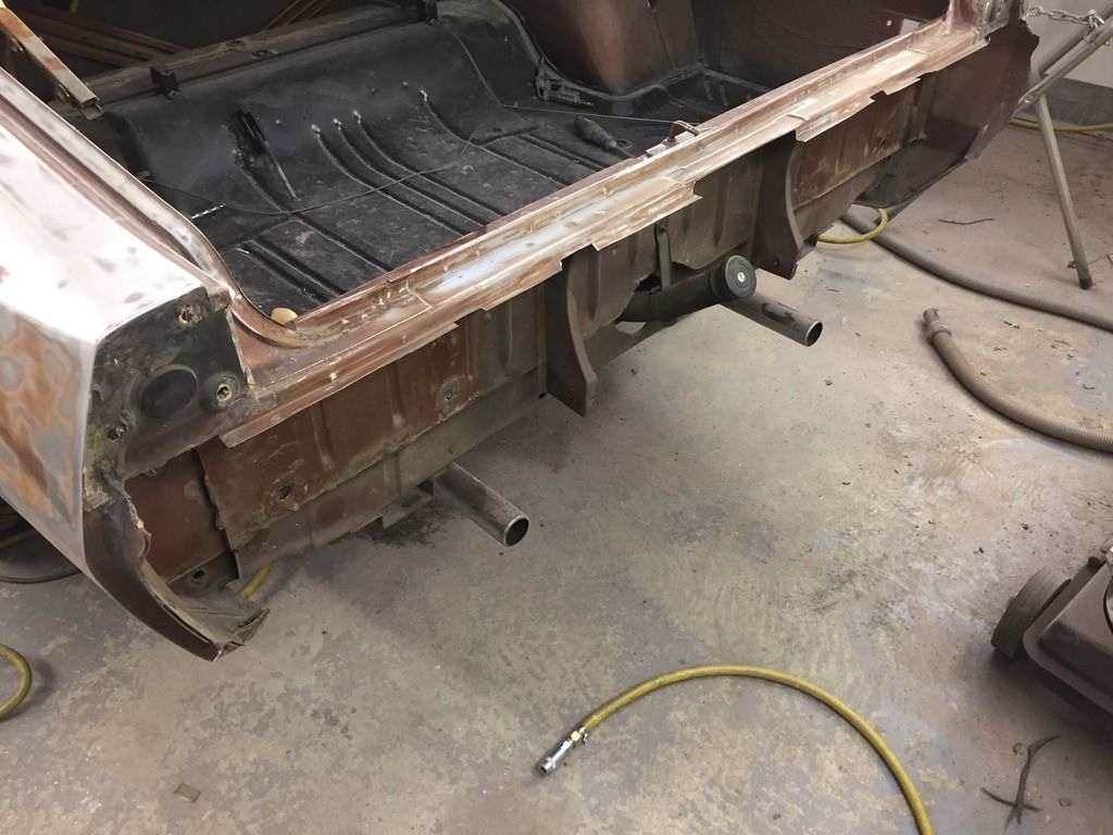

Prep has slowed down a bit this week, as i've had to stay away, and a few other jobs came into the shop this week.
However, the back panel has been sorted out, and the cut outs for the over riders have been welded up.
Got the car on its original steelies to roll it around so as not to mess up the magnums. Can't believe such skinny wheels were standard!

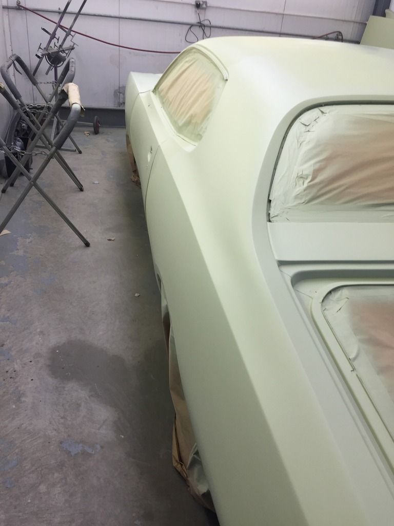

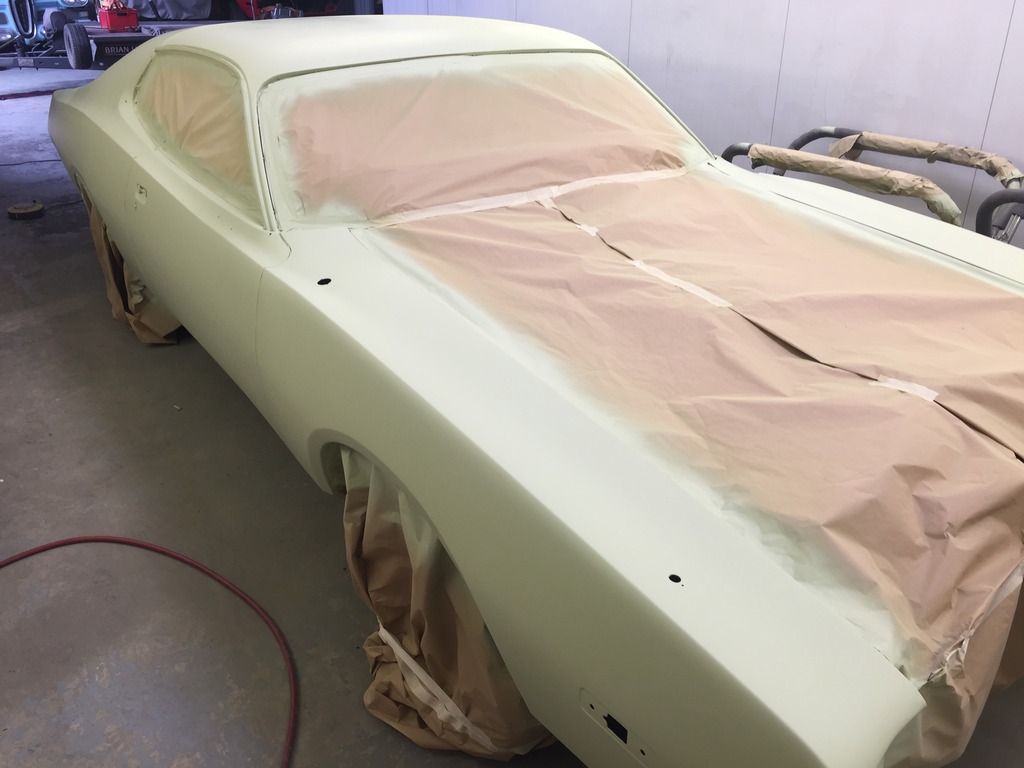

She's finally in primer! Several thick coats went on last night. Its come up great. It'll be left over the weekend, then a hand sand down with a 400 grit.
Hopefully that's all it'll need before some top coat.
