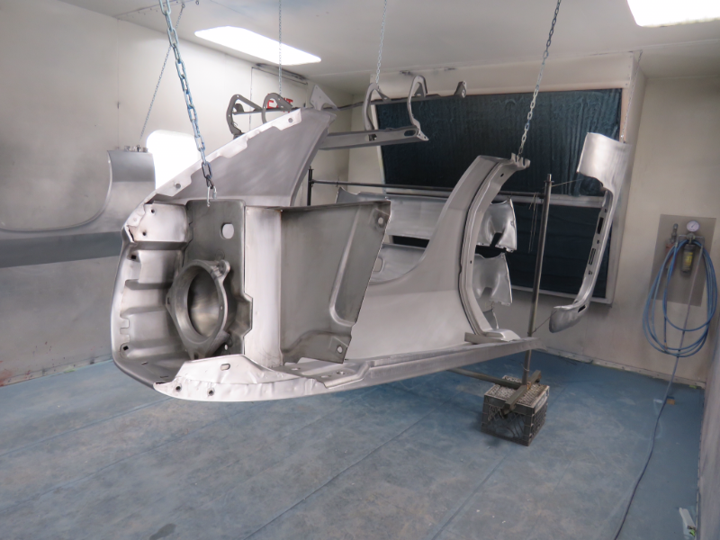

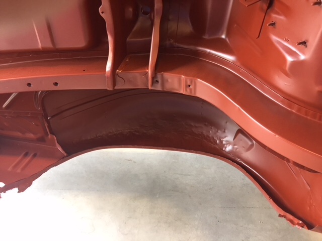

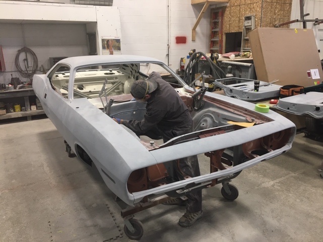

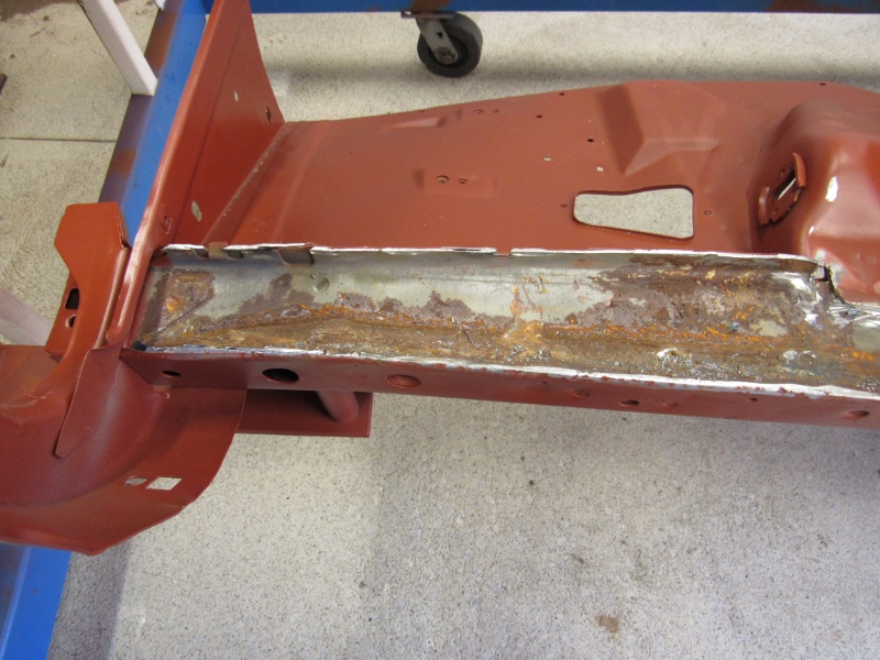

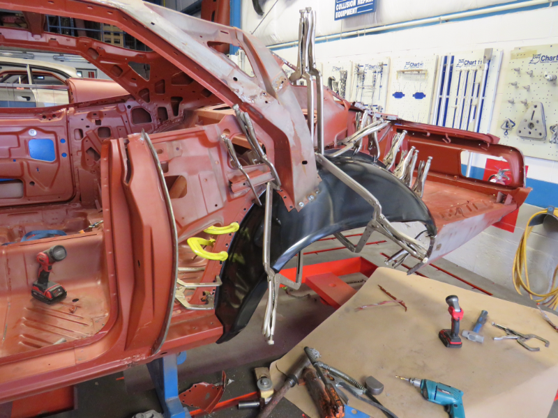

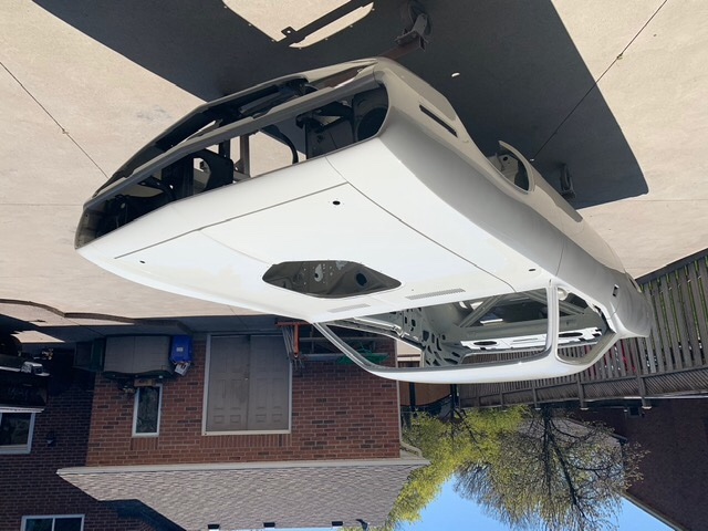

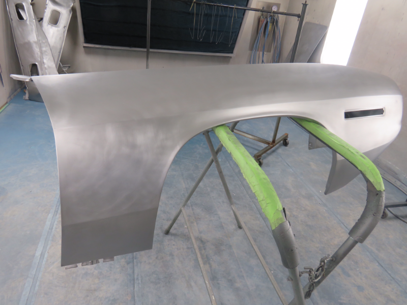

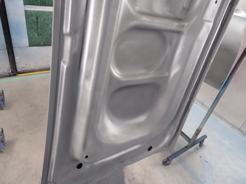

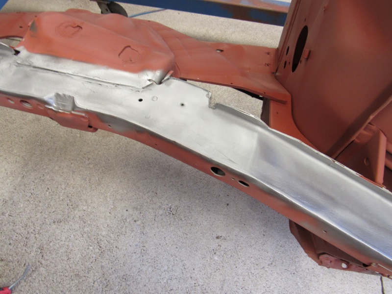

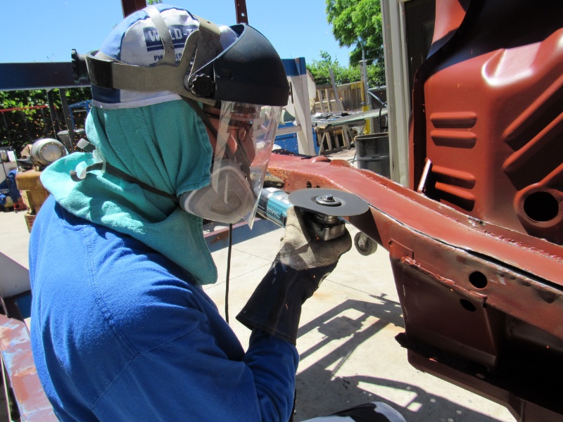

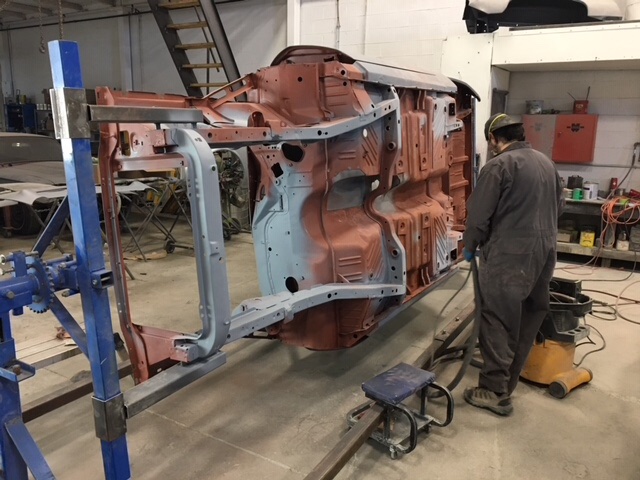

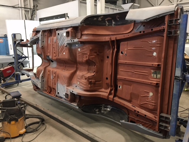

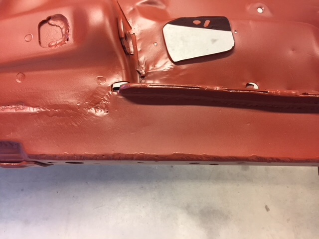

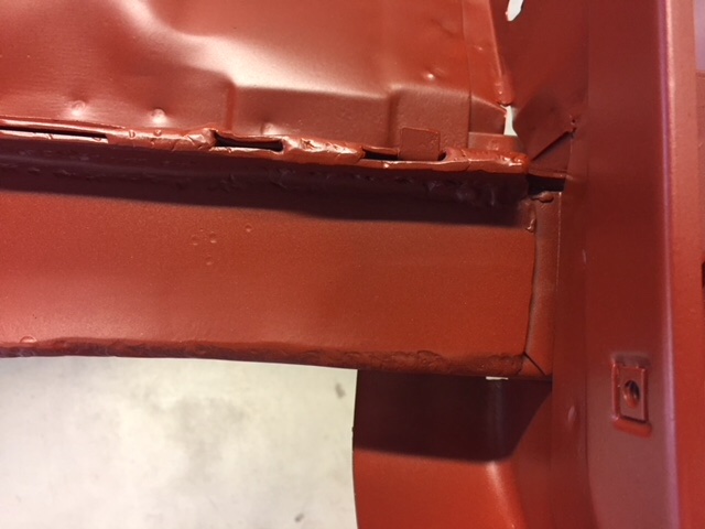

The body shell was disassembled and sent out to be stripped back to bare metal. As you can see apart from a little rust in the bottom of the rear quarters it was in pretty good shape. There were some strange strengthening plates welded to the front chassis rails, probably from it’s drag racing days and these needed to be removed and the rails tidied up.There were also some ugly repairs on the inner rear wheel housings from where the flared arches had been removed and patch panels welded in.

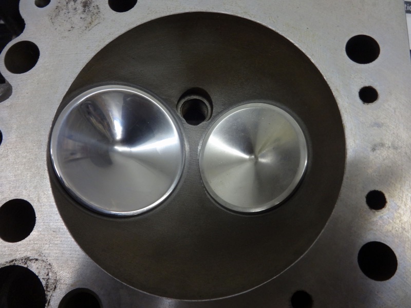

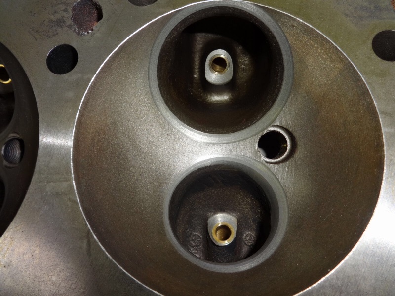

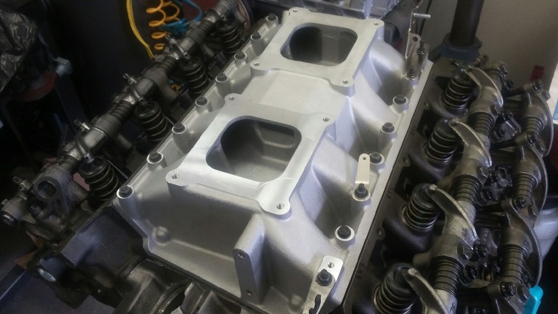

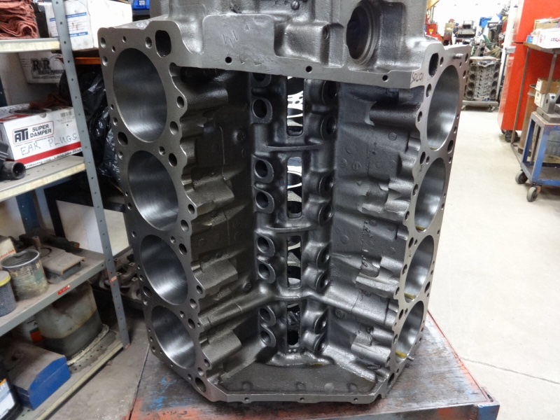

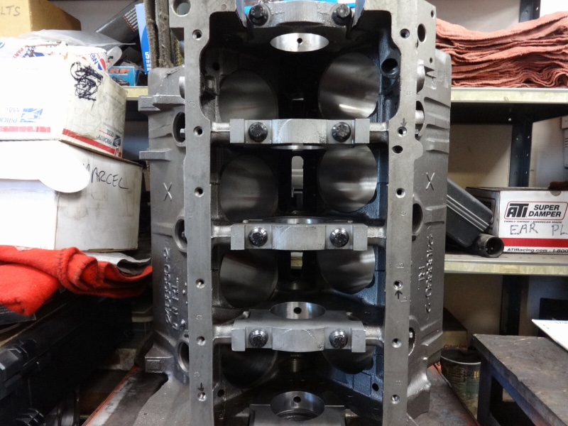

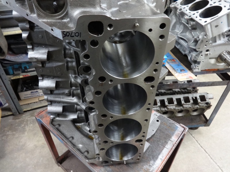

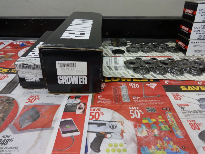

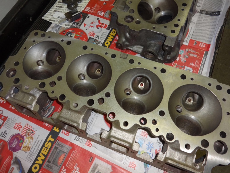

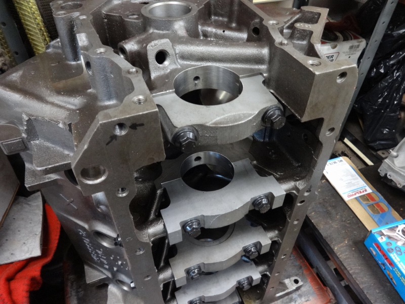

The engine was now with the engine builder and turned out to be in good order internally with no damage and still on it’s standard bore. The heads had obviously been worked on at some stage and this appears to have been carried out to a high standard. According to a previous owner the engine had been freshened up by Keith Black during its drag racing days but we have no evidence to back this up. The plan has been to rebuild the engine with a decent hydraulic cam, sensible compression and a stage V inlet manifold with a pair of worked Edelbrock Thunder series carbs from Tim Banning at “For Hemis Only”. With headers and a decent exhaust system we should be looking at around 500 hp, but more importantly the Cuda needs to be user friendly, relatively maintenance free and able to run well on modern fuel.
Here are some more photos of the bodywork as it progressed and also some of the engine being prepared.

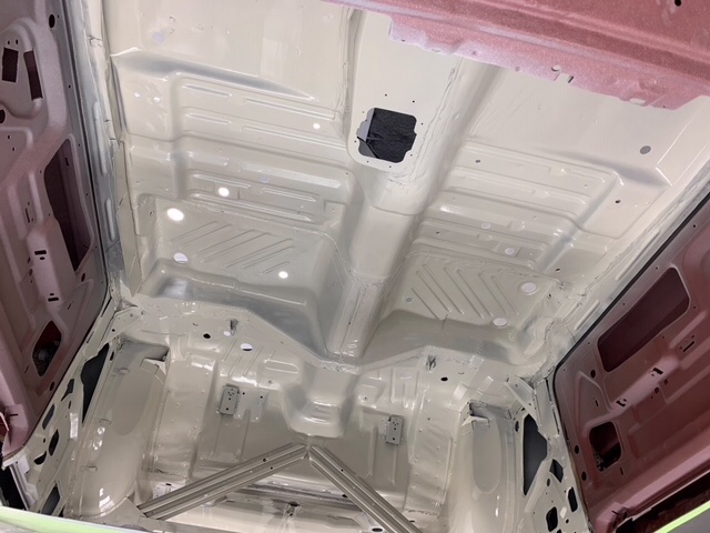

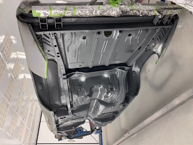

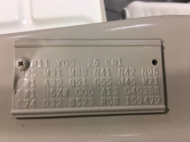

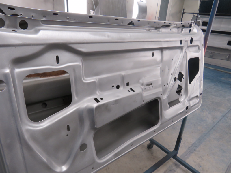

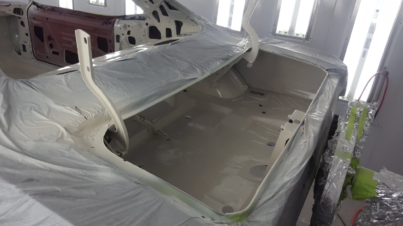

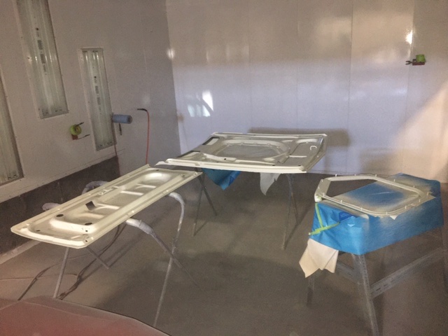

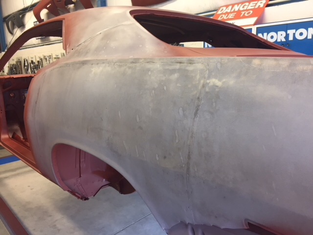

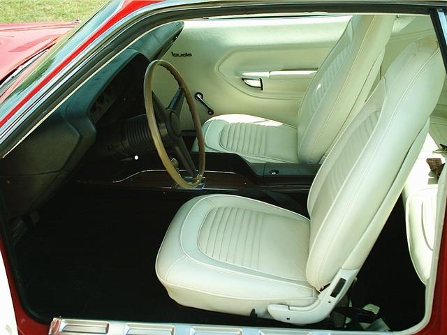

Here are a few more photos of the body shell as it progressed. While it was with the bodyshop Mauro started sourcing missing parts and restoring some of the ancillaries in preparation for reassembly. As mentioned earlier in the story we only had a photograph of the original fender tag which allowed us to have a reproduction made, I have included a clear photo for the decoders out there. Originally the car came with quite an unusual interior trim combination H6XW and I have included a photo from another car for reference. It also came with the A32 super performance axle package which included the Dana with 4.10 gears. This will be changed to more street friendly 3.54 ratio.

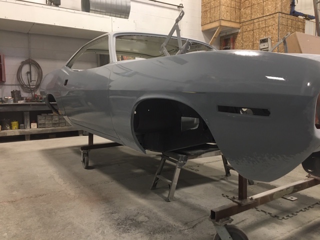

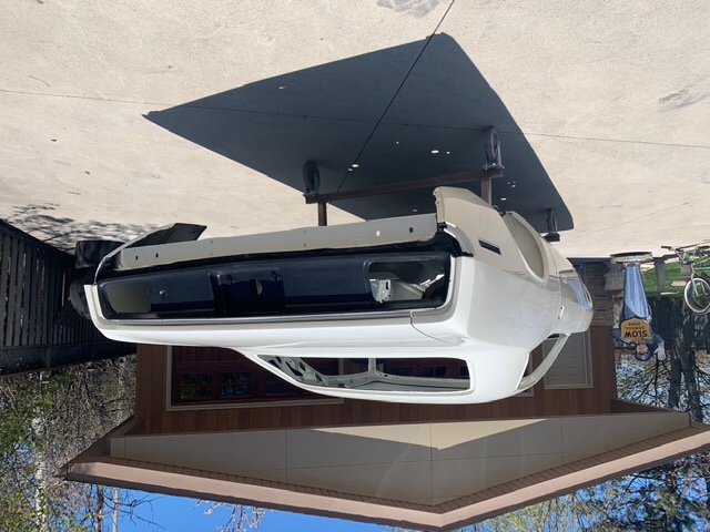

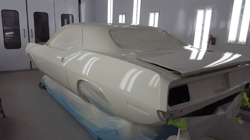

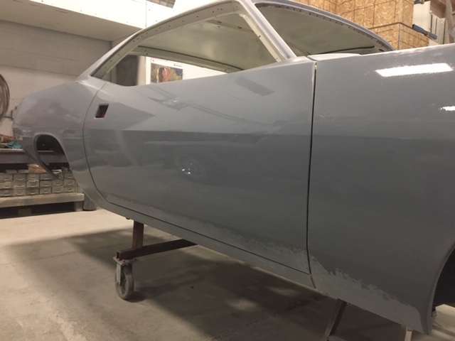

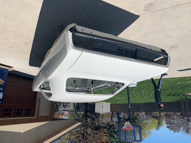

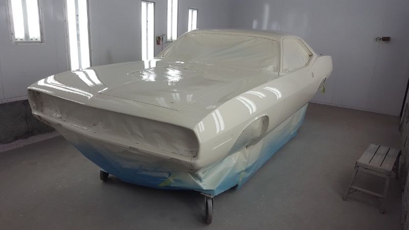

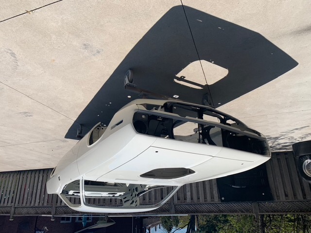

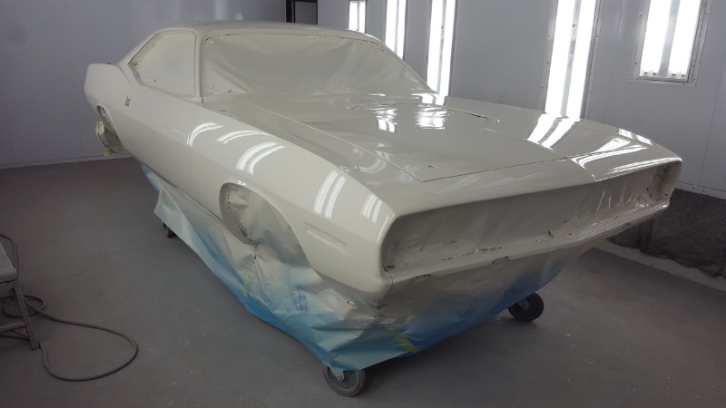

A couple of shots of the Cuda back from the bodyshop and now at Mauro’s ready to start the re assembly.
Posts: 7632
Re: Canada Trip
Stunning. The shut lines etc look perfect!

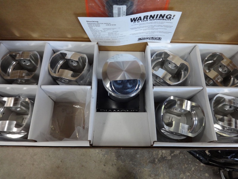

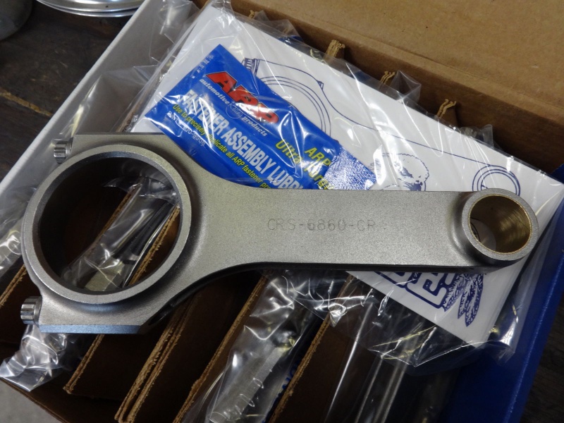

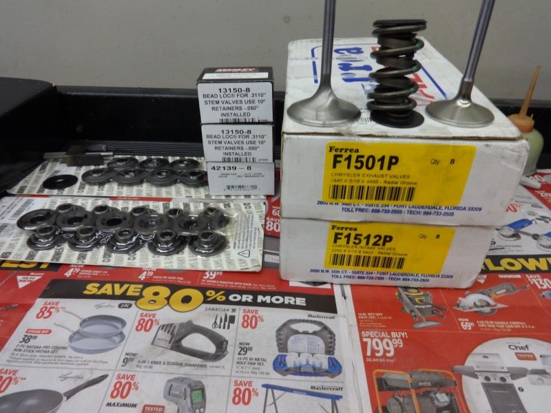

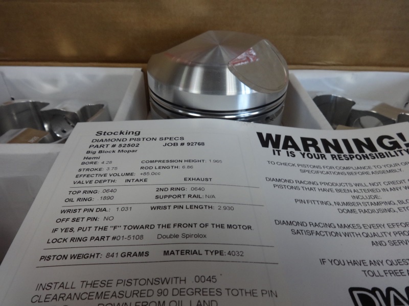

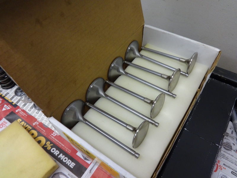

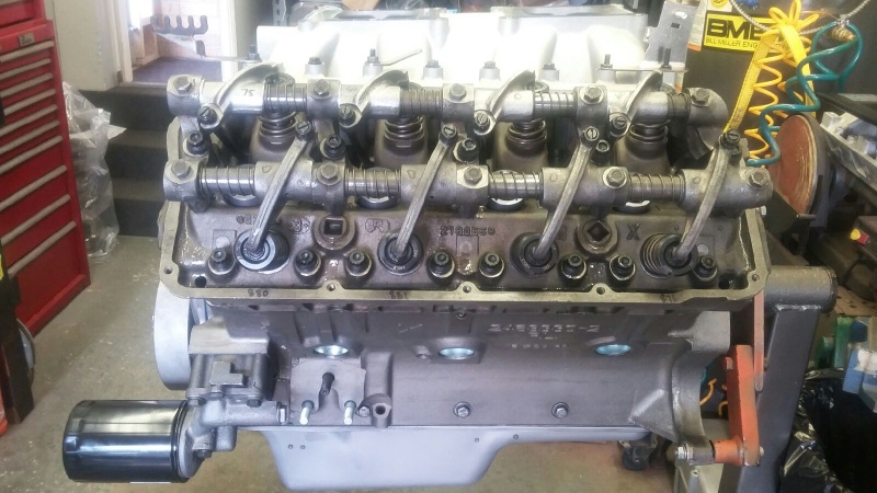

While the Cuda was at the bodyshop the engine build was completed. Here are a few photos of what went into the motor, nothing super trick but all quality parts, the aim being to build a strong reliable motor.
