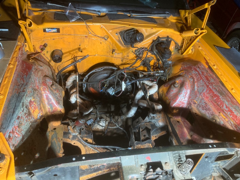

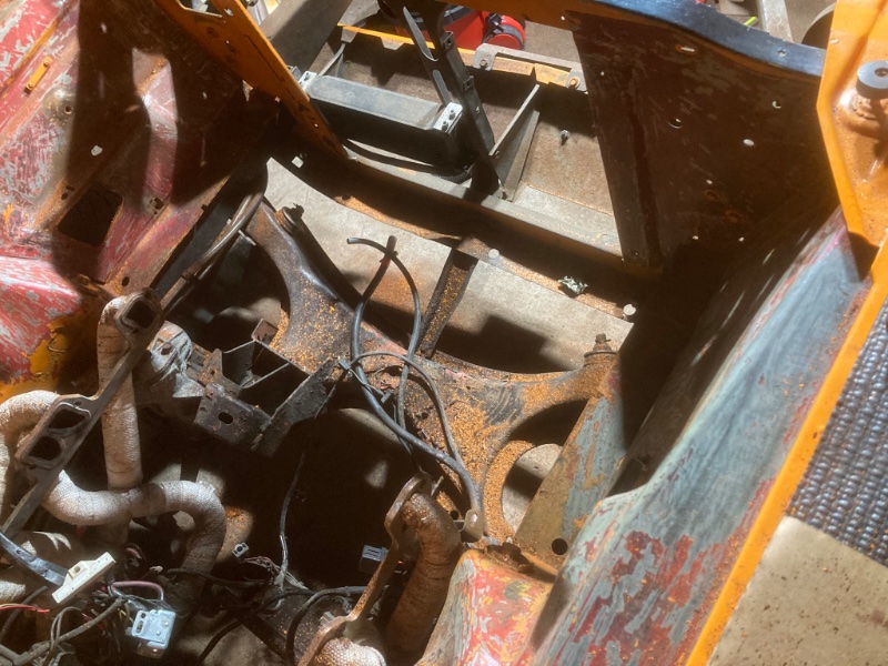

Pete wrote: Mon Mar 27, 23 11:14 am How is the engine bay progressing?
Like this!
2001 Dodge Ram Van
Posts: 22261
Mod Tops are supposed to go on the Roof!!!
I bet that is so much fun, but will be completely worthwhile when it is done... fortitude, young Skywalker!!!
Posts: 14656
Is the heater going for a trip to the tip?
Posts: 7202
Pete wrote: Wed Mar 29, 23 4:56 pm Mod Tops are supposed to go on the Roof!!!
:lol: I can’t claim all the scraping fun, I’ve done a good chunk of it, but a bigger chunk of it has been done by a good friend who came to help last night, who will be doing the re spraying of the engine bay. :thumbright:
Meanwhile, oil pan is back on and I have just taken the boot lid off and stuck it in the boot of my daily, waiting to be taken to be paint matched for the engine bay paint and I have the valve covers and air cleaner in the garage where I am going to strip them back and repaint them. It’s progressing slowly.

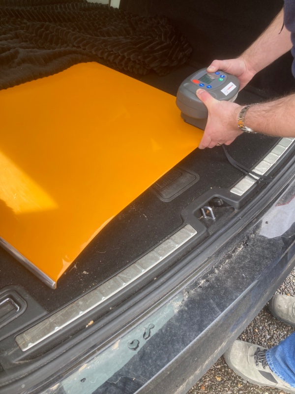

In the meantime…. Paint matching!
2001 Dodge Ram Van
Posts: 22261
Volvo Grey????
Posts: 7202
:D Not quite!
They had 3 different machines to try and match it, think we’ve got it now, but have a small sample to do a sprayout with before committing. Fingers crossed!

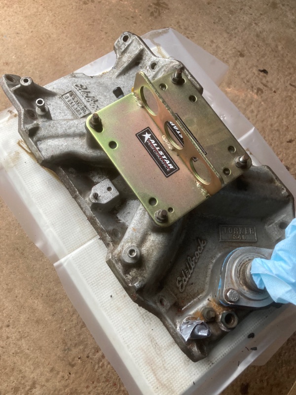

Just starting to clean the intake manifold up and want to address something else that’s always wound me up…

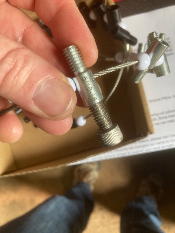

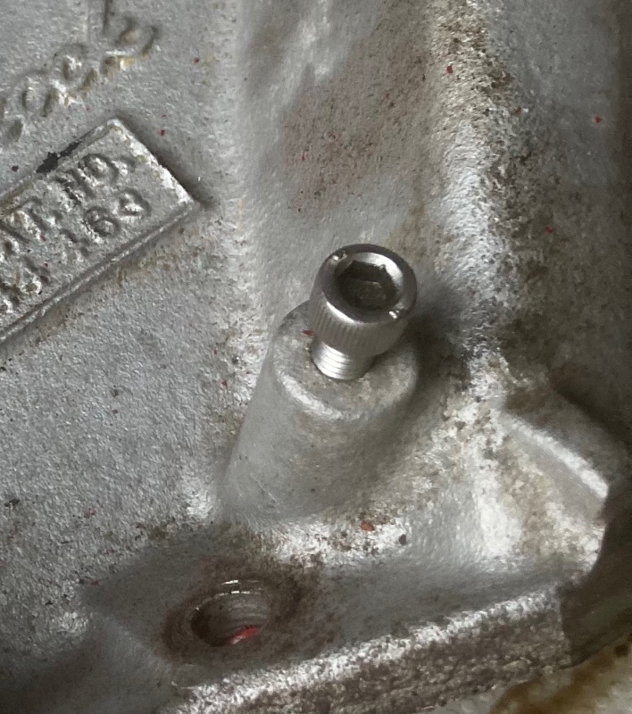

Someone had plugged where you would normally use pipe plug fittings with bolts that stick up. The bolts are 5/16-18 thread, but I’m sure these should be NPT, shouldn’t they?
My question is, if I get the right thing, are these threads the same (enough) or am I now dealing with something that’s had a new thread carved into it. :roll:
