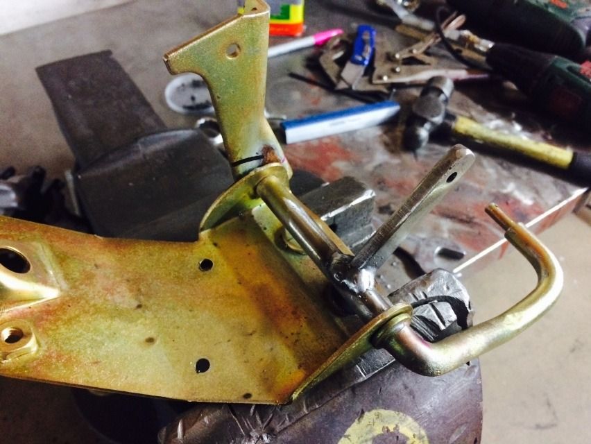

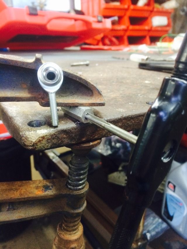

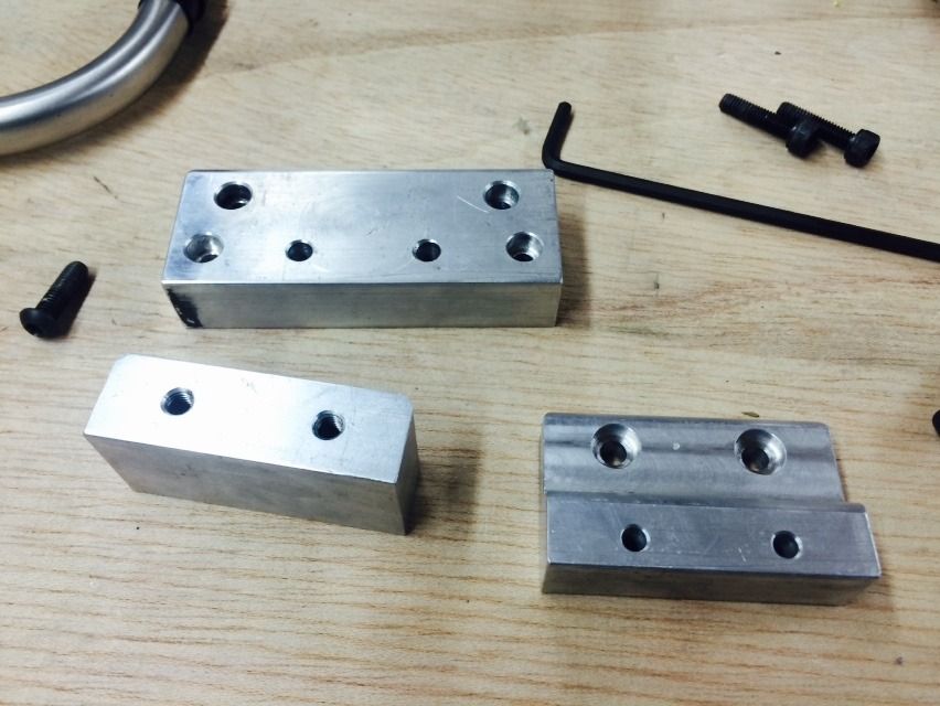

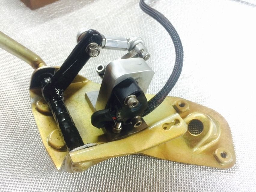

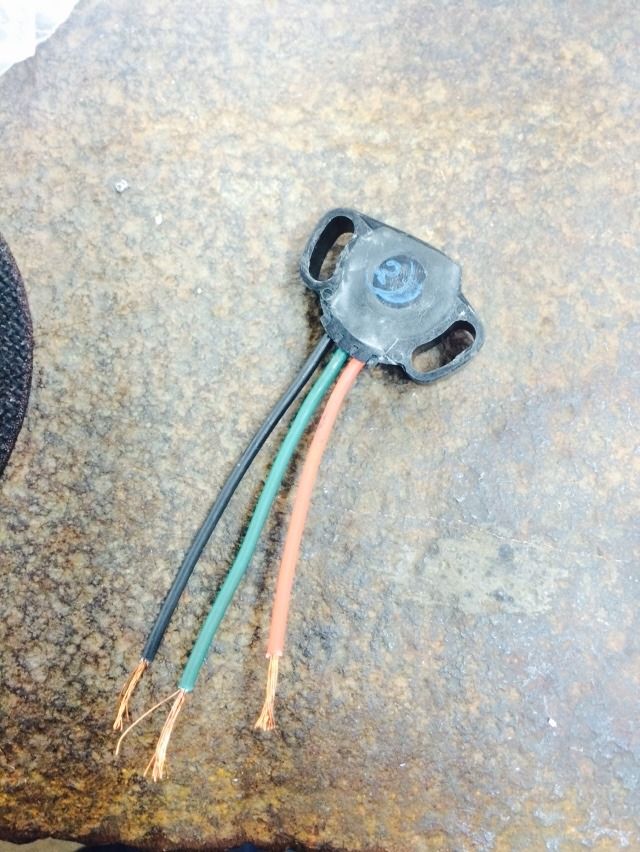

TPS
Throttle position sensor
This tells the ECU what postion the throttle is at
Now most people mount this up on engine next to butterfly's

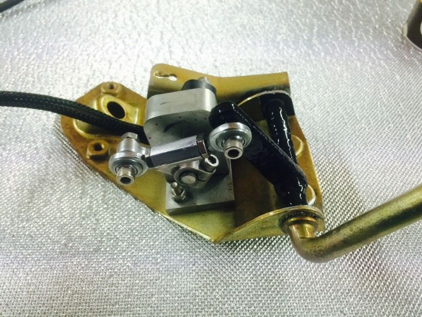

I mounted it next to the throttle pedal under dash this ...
A. Makes it confusing when looking at engine how does it work :scratch:
B. Gives a never level of tunablity.
I will be able to make sure just before the butterfly's open fuel starts.
This will help stop the blower sneezing which can be deadly.
Made Alu house/axle block , welded rod to pedal and rose joint bar.

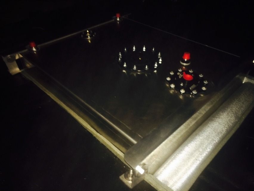

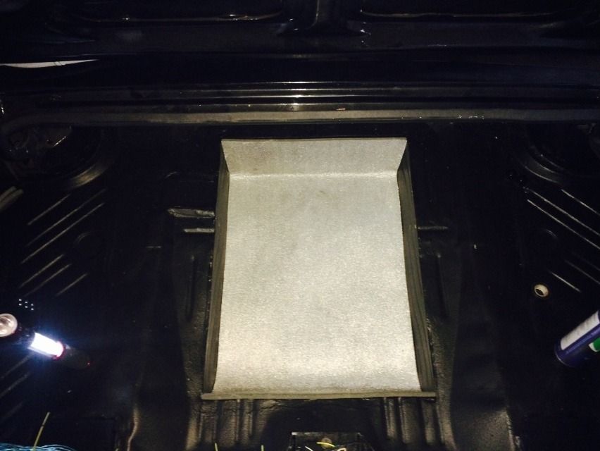

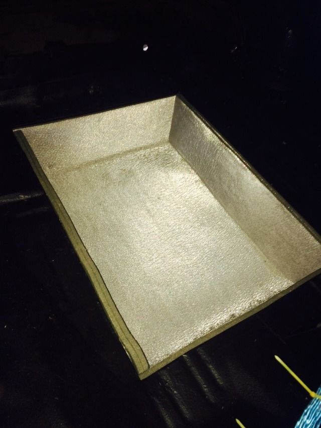

Fuel tank
When I made my lowered boot floor I made it a little bigger than the tank.
So I coukd line it (from demon Tweeks its £97 a sheet) or you could go to a camping shop ;)
Lined and put tank in then made up some Alu straps to hold it down for when doing some duke jumps

Your doing some great stuff Will.
I think you could of come down on weight/ strength of the TPS bracketry & Rod ends, it doesn't need much effort to alter the TPS position.
Must of taken a while to get the ratios right ;)

Do you have foam between the tank and the straps mate, can't tell from the pics?
Yes mark the angle :runaway!:
Have a little bit of padded double sided tape between tank and braket :thumbright:

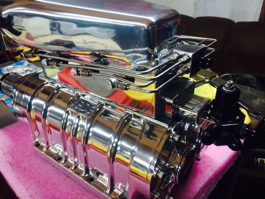

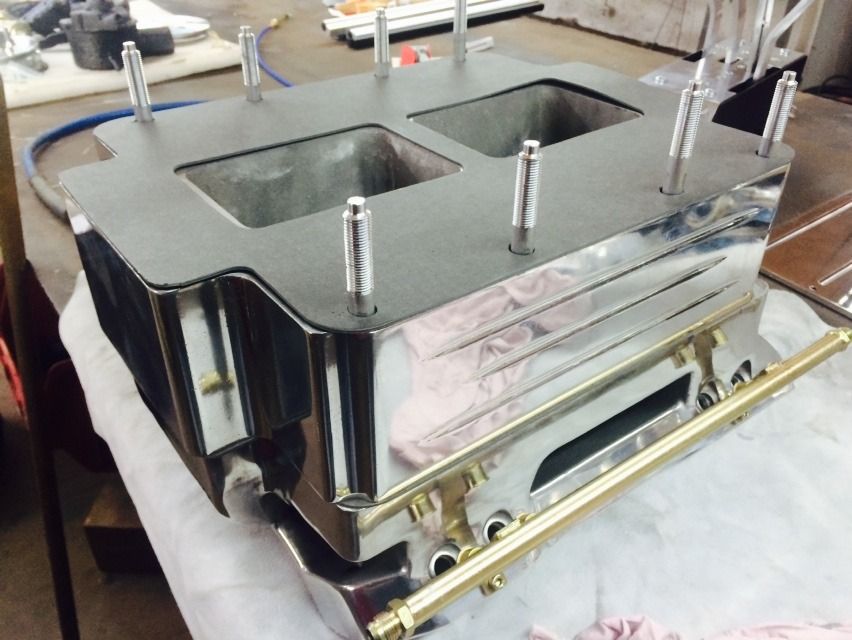

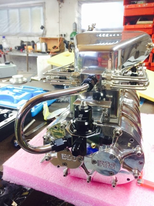

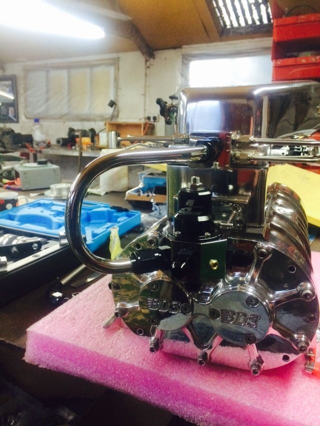

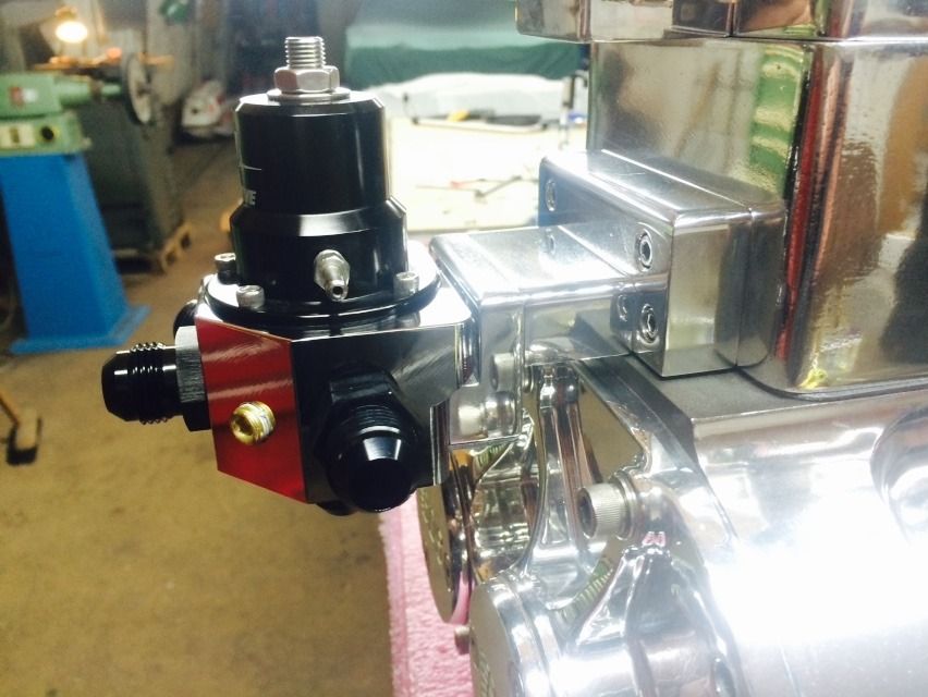

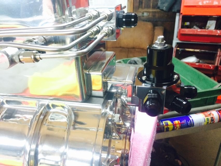

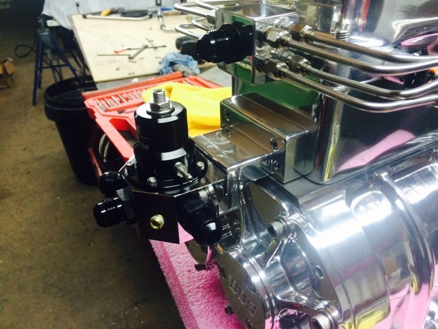

Next I had a braket machined up to hold my huge fuel reg.
It's boost reference so will increase fuel pressure at a 1:1 ratio to inlet Mainfold pressure.
Polished up and nice and close to fuel rails

Will,
I am not saying you will have a problem & most likely all will be OK. But it's not good practise to solid mount regulators.
Thanks mark I see where you coming from its a piston in a bush that won't like being rattled by engine will see how we get on with it can always change later.
Since I am mounting it solid I can use hardline to feed my fuel rails.

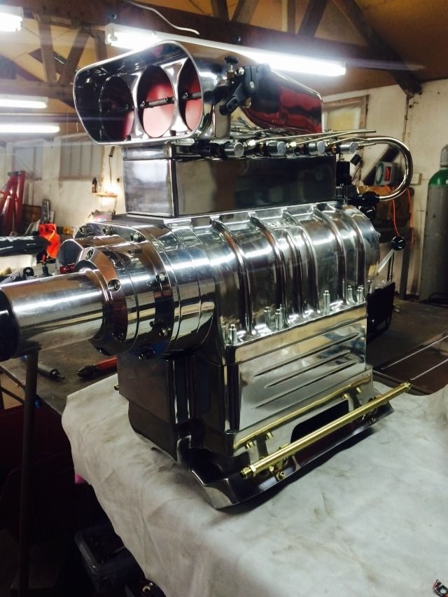

That must be tall if you need a step ladder to reach up to the injector hat :lol:
Posts: 6738
I know it was discussed previously, but you are regulating after the rails ?
You want full pressure going to the fuel rails....
Don't worry, I must get better glasses ;)
mopar_mark wrote:I know it was discussed previously, but you are regulating after the rails ?
http://www.moparuk.com/forums/viewtopic ... 543#555543

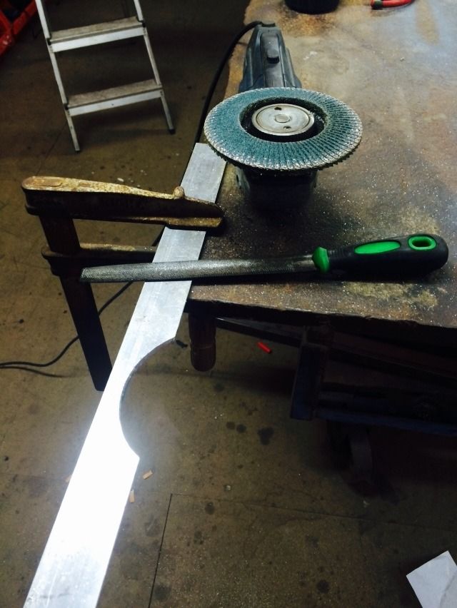

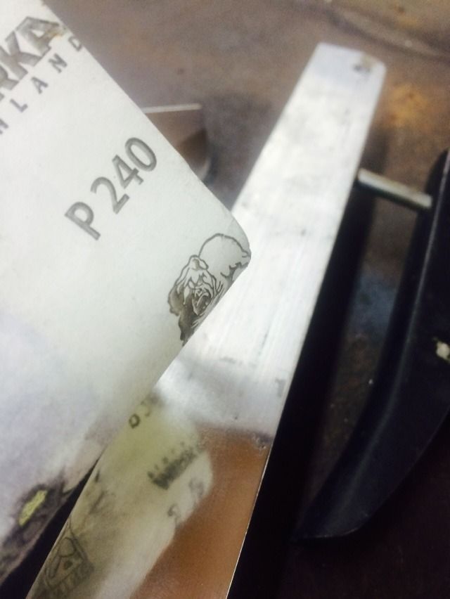

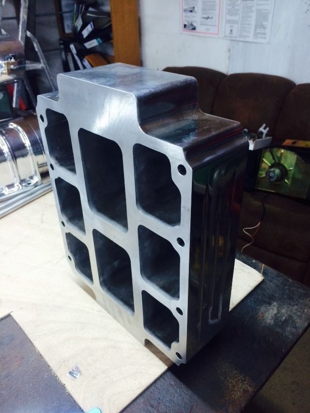

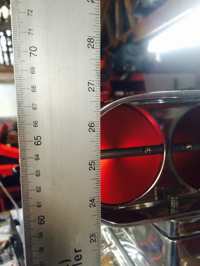

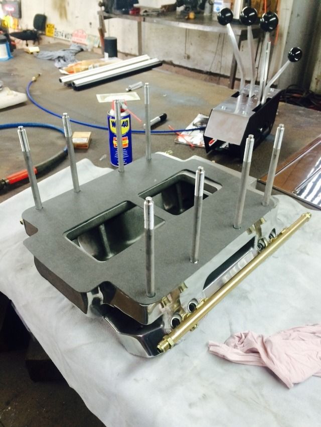

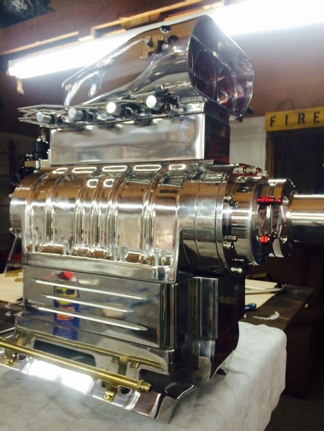

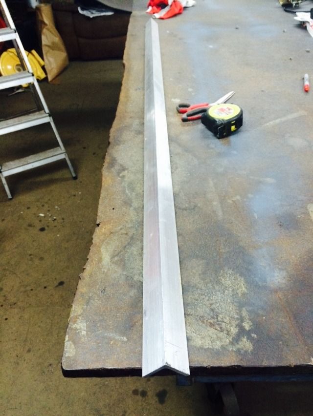

Well I would love to tell you all stories of making inlet runners longer and the quantum leap phenomenal.
But it's. Basically a 4inch penis enlarger that will make my blower/EFI setup
Stick out the bonnet another 4inches :geek: :geek: :geek:

Posts: 22109
Yep, you are definitely going to have to cut a big hole for that one, and drive wearing Stilts with a cushion on the seat!!!
