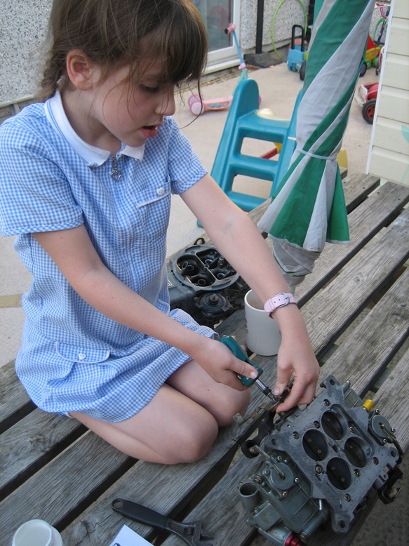

Well I copied most of the settings from the old carb.
Fitted the loudest pump cam in the primary (brown for you anoraks) and upped the secondary to green.
Replaced the leaking float bowl with one pinched from the old carb.
Binned the sight lenses and refitted the brass screws and set float levels.
No leaks, started up instantly, idled cleanly and revved lovely :D
Out for road test and tuning tomorrow :thumbright:
Scarlett changing pump cam.jpg (237.76 KiB) Viewed 1334 times
Must say Paul.
You look rather femanine to be playing with a Mopar race car ! :D
Posts: 8369
That's my personal mechanic ;)
