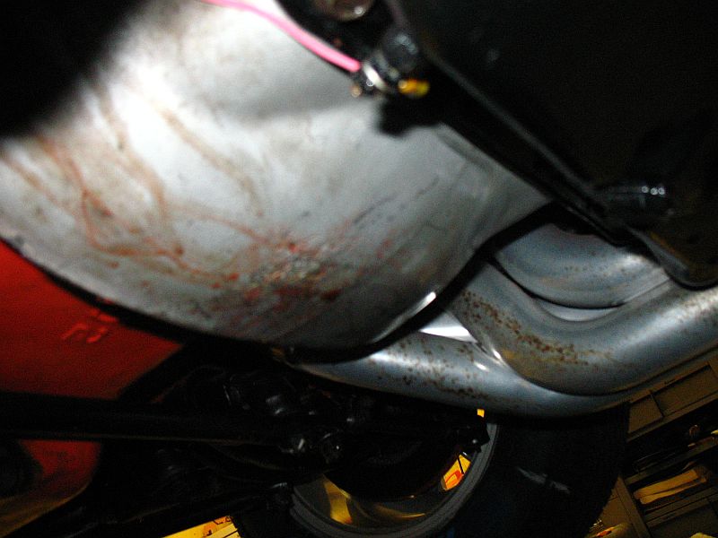

The trans leak was pretty bad. The whole of the underside of the car is dripping. It has burned onto the headers and exhaust pipes.
No wonder it was smoking bad.

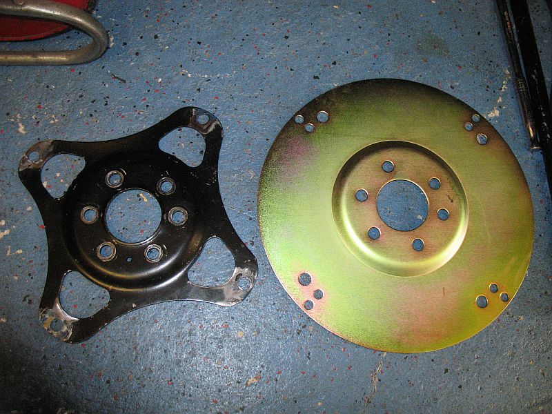

I thought the price was good and my drilled out (hemi bolt size) stock flexplate was a worry in the back of my mind. I want to inspect my rear seal for leaks while the trans is off so may as well fit this new flex plate.

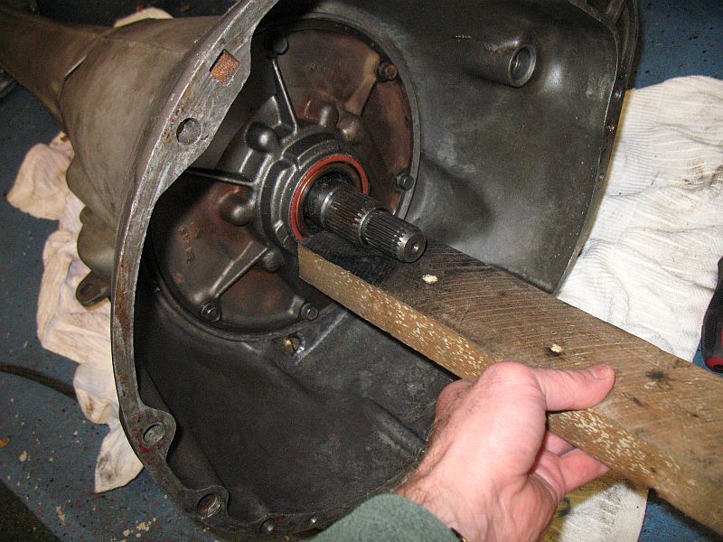

Also Blue sent me a new front seal for the trans to fix my leak but it seems to have got lost in the post. Another is on it's way though. Thanks Blue. :thumbright:
On Saturday morning I ended up with TWO seals from Blue and the flex plate also turned up. So things are looking up! :thumbright:

Did manage to fit the seal during a short bit of free time though.

Fitted the new flex plate too. Makes the old one look pathetic.

a little tip when fitting pump seals/well any lip seal come to that, after fitting take a good look inside with a light and check that the elasticated lttle garter has not jumped off the seal lip, it happen,s
