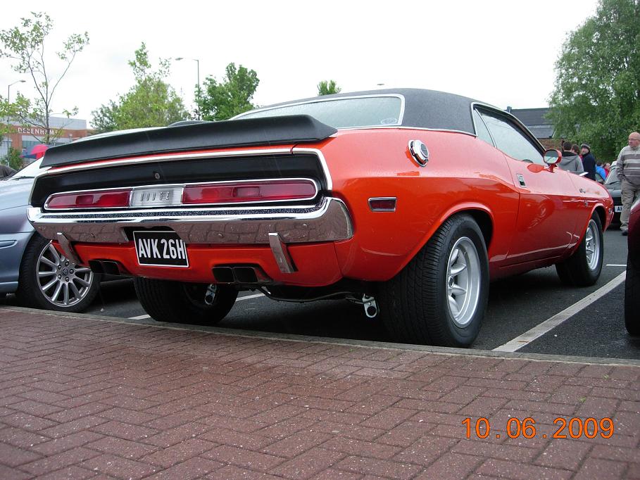

Certainly created a stir on arrival. Loved the electric cut outs on the exhaust :evil:
Thanks for those Neil. :thumbright:

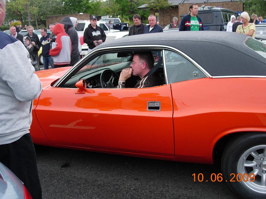

Posts: 13003
An absolutely epic performance Dave, bloody well done, it looks amazing, despite you looking a bit pensive at the wheel! :thumbright:
