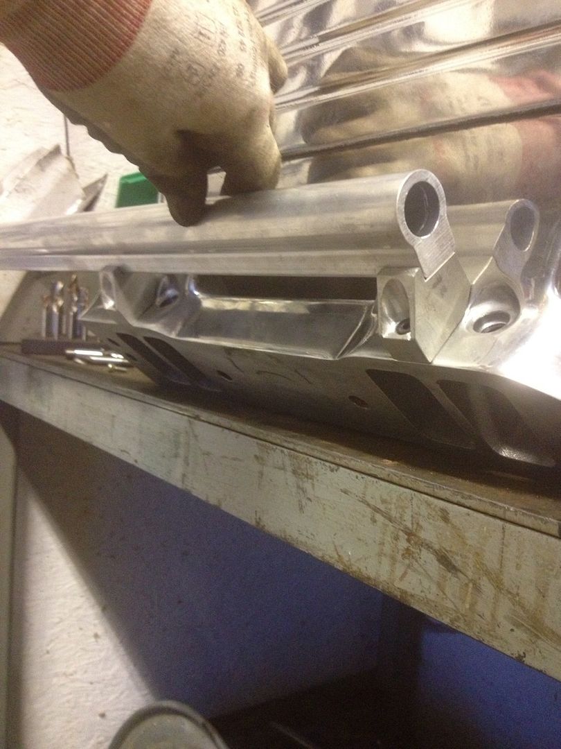

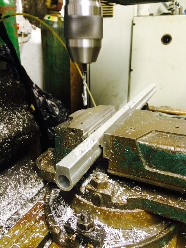

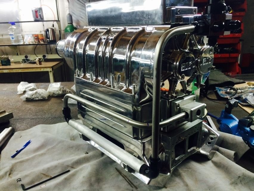

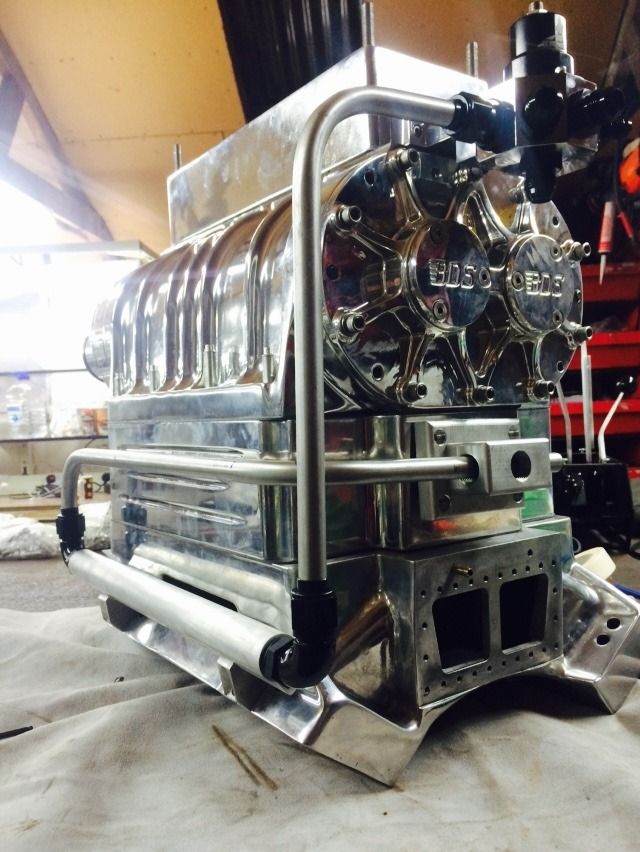

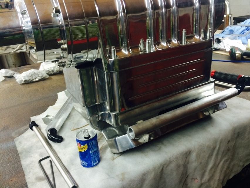

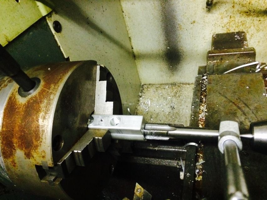

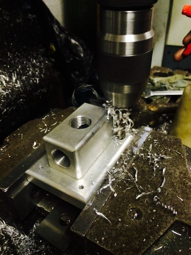

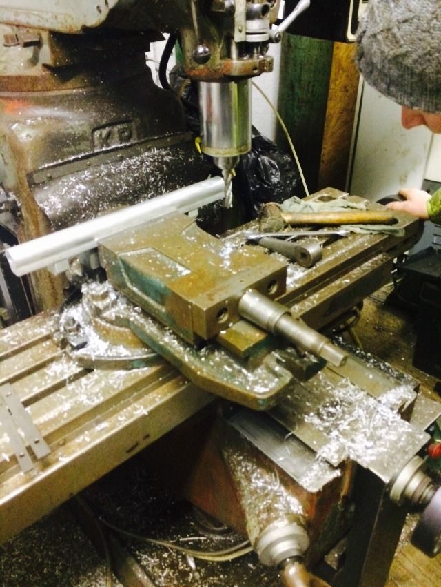

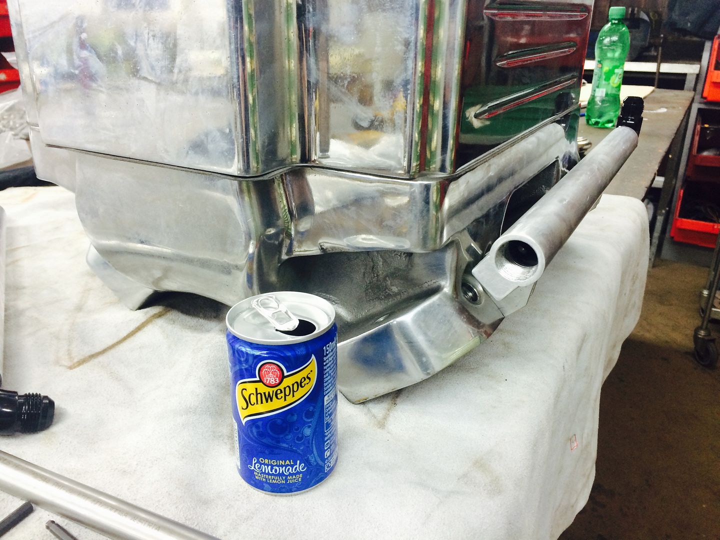

Fuel rails
Now as I need to have the regulator after the fuel rails there was worry that the an-6 rails where not going to flow enough.
So bigger is always better always !!
I look at everyone's else fuel rails and went one size bigger.
I bought some AN-10. 20mm inside Diamter :shock:
Fuel rail stock and with a good friend cut the injectors pockets and mounting.
Also made a fuel T block (1 in 2 out ) this will sit at back of blower.
Mocked up some fuel pipes ( you think stainless brakes line are fun come and try this stainless 5/8 pipe ! )
Thanks for all your kind words
Will

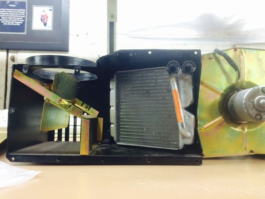

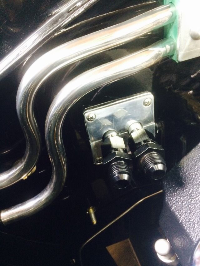

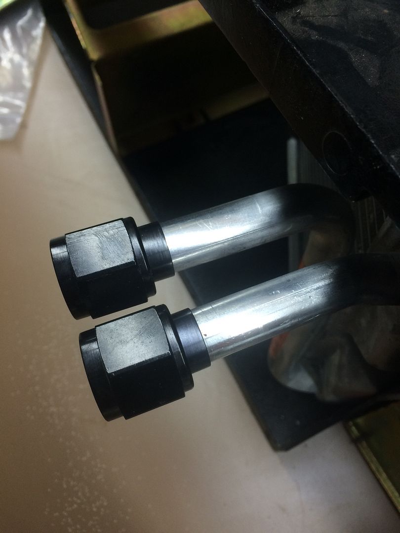

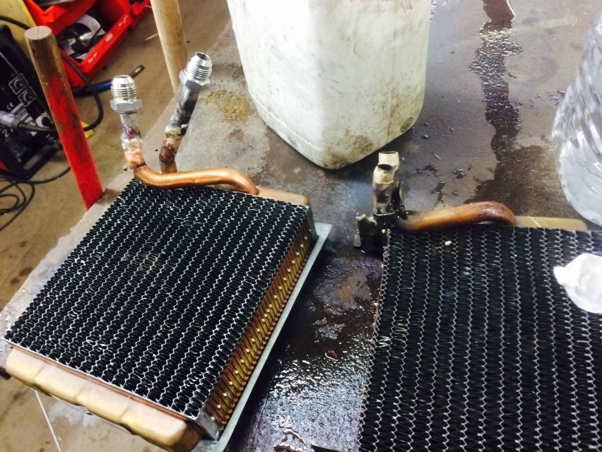

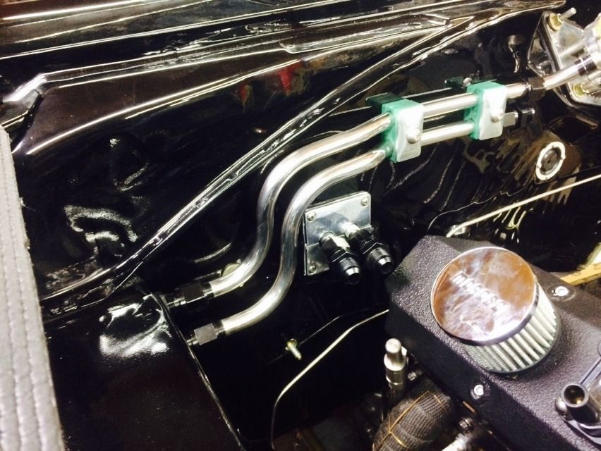

This has been driving me mental and final got it.
Where the heater matrixs pipes come into engine bay how do you make them look good!!
Well after weeks of melting brass I found that rock auto sell an Alu rad !!!!
So I very carefully swagged some
Fittings on :thumbright:

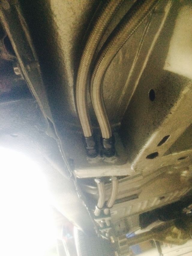

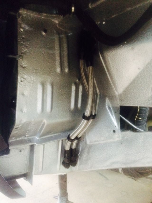

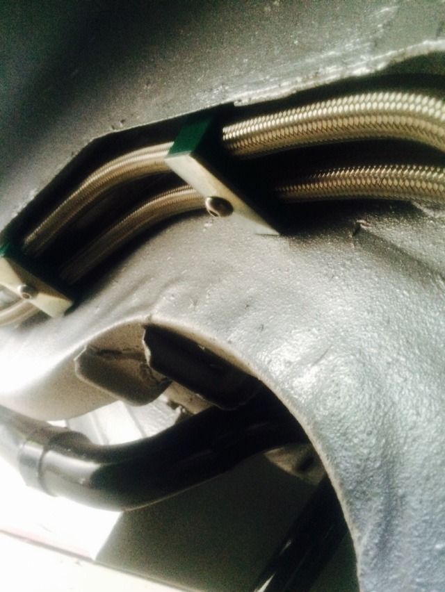

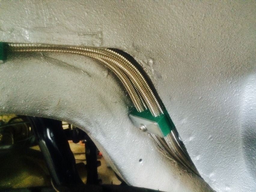

Back to it !!
Took everyone's advice a run my fuel line from from to rear with brained lines to allow for some flex
