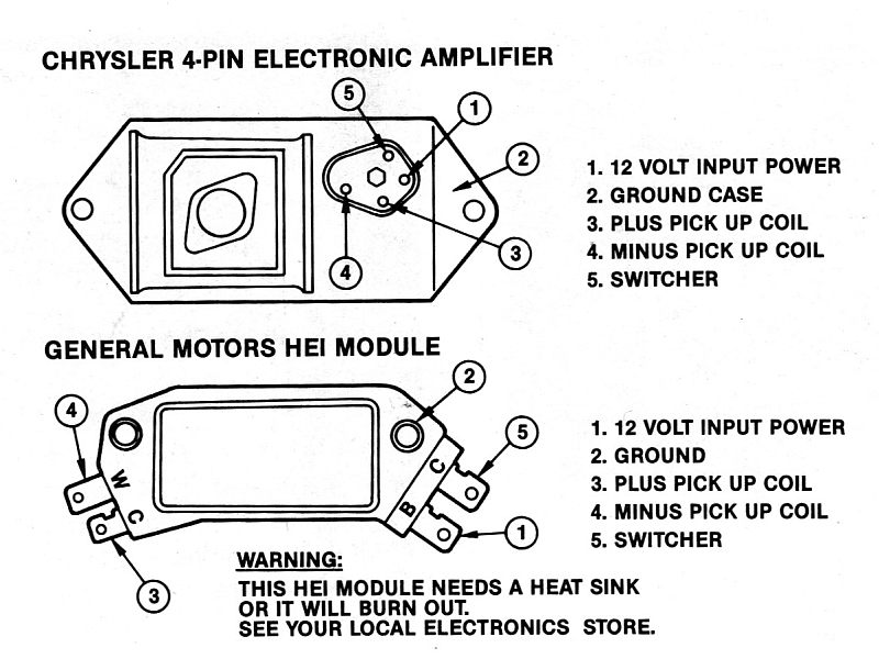

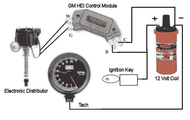

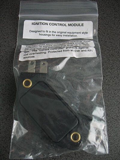

Thats the very thing
notice good to 7500 rpm
and features dwell control to stop coil over heating at low RPM
similar setup on the mopar side is chrome box territory
pair it with a blaster or Bosch 12 volter
and bypass your ballast
mines mouted on a bit of ally angle and jubilee clipped to my dizzy for common earth
i stuck a maplin heat sink on the bottom
here is the distructions
- close.jpg (83.73 KiB) Viewed 612 times
- hei_102.jpg (83.41 KiB) Viewed 612 times
- aaa hei_pic.gif (19.87 KiB) Viewed 612 times

Yes it is a good one. Better than the stanndard GM version. Cost me £25 off ebay I think?Dave999 wrote:Thats the very thing
I bought it in case the FBO ignition didn't work out. Which did eventually but not before the ECU needed replacing on that too.

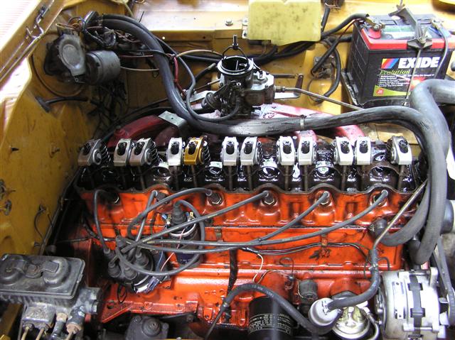

Well - Update.
Made some lovely brackets up - ECU now sitting clear. Car starts first flick. All is good. Vroom vroom. She is running rough, but smooths out with heat.
Once warm check her - 2 things are odd.
1) Only seeing 12.17 at battery on idle.
2) Ammeter in car is now running at -20 constantly. Used to sit in the middle.
Either of these seem odd ? Strikes me that new alternator is not charging. Sigh. Its a 2 pin alt, but this should be fine - wired up as instructed, one pin into volt reg and one to ballast (spliced). Battery is flat now, so thats kinda that for tonight.
Headed for home. Got here, turned her off. SPLOOSH ! Dumps the contents of the rad out the second I turned car off. She has never overheated before (and its not like I was in traffic, I blasted up the road and back).
One step forward, 2 steps back...

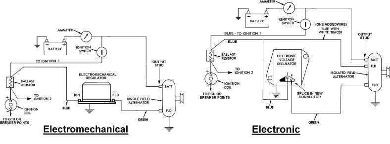

No no! I don't want anything for it! It's yours. If you want to be clever then clean out the guts of one of your knackered ECUs and mount the HEI chip inside so the whole thing looks Mopar.morgan wrote:Cheers Dave. WIll do. I have your paypal details here I think. Will check.
Does the voltage increase to normal at 1000rpm? What is your current rpm?Once warm check her - 2 things are odd.
2) Ammeter in car is now running at -20 constantly. Used to sit in the middle.[\quote]
You not by-passed that sucker yet? Wire as per the instructions on the Mad Electrical website and fit a volts guage. But it could be showing a short circuit somewhere. Which would pull the voltage down.

Put old alternator back in. Current now works fine - guage in the middle, car runs good. Battery charges.
So - new alternator potentially no good - now need to get tested. Annoying.
MAde it to Harpenden yesterday, but not without drama. Big overheating problems (something she has NEVER done) - used 20 litres of water over 4 breakdowns - She just kept boiling up and throwing it out - was blowing like a steam train (engine compartment now very mucky).
So no NATS for me - ah well. C'est la vie. No point debugging really - I know I needed to do the rad at some point - its a 2 core small block item and although it has been perfect I meant to beef it up at some point. Will look into that now before trying to diagnose. (it is odd though - always been faultless.)

Yep.RobTwin wrote:Morgan - did you get to the bottom of this?
It's all sounding too familiar...
2 things.
1 - some clown in the past had run a wire direct from the back of the fuse board at 12v into the old mechanical dizzy. Dont know why. Then some other clown (me) replicated the fault when he put the brand new loom and electronic in place. My coil was getting a direct 12v feed on top of its 8v. Now I dont know the specifics as to why but I have decided this was what was popping the orange boxes... Been clean since.
2 - Not all voltage regulators are created equal. The old mechanical ones are not suitable (learned the hard way). The blue 'race only' onces are not suitable. Learned the hard way. They run for a bit (like couple of months) then 'pop'. Got a stock-looking-FBO one in there now with electronic innards. All good.
In short I think the orange boxes were just the weakest link in a 2 fault chain. Between direct feeding and wrong voltage regs they just popped.
Thats the theory anyhow...
