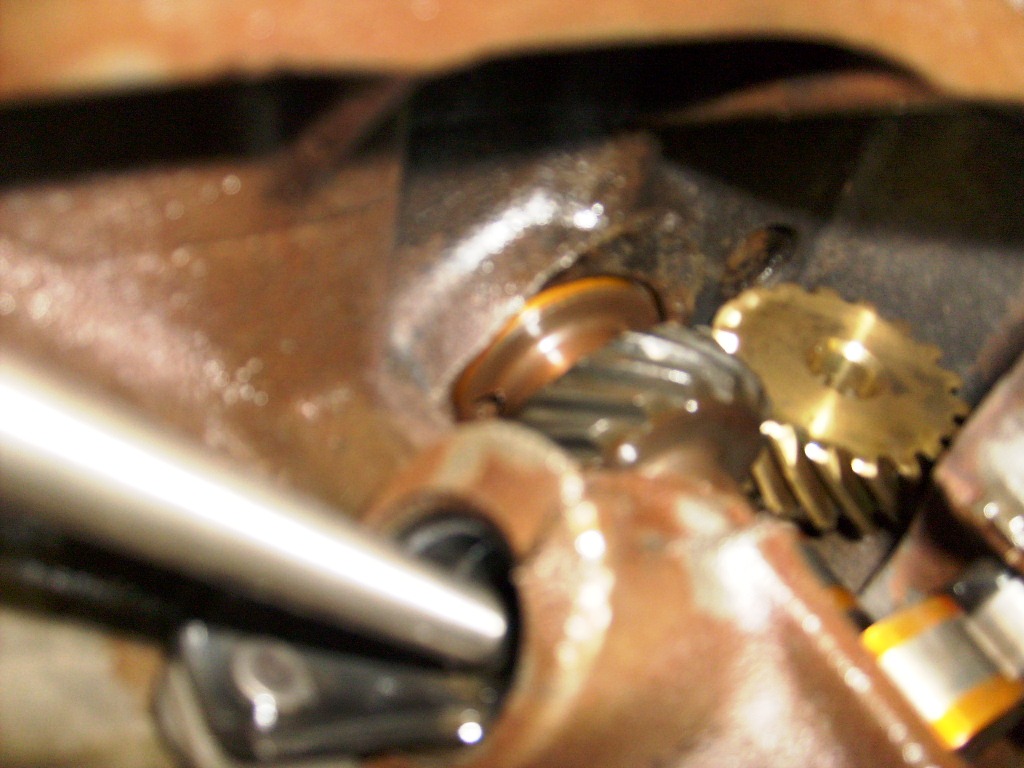

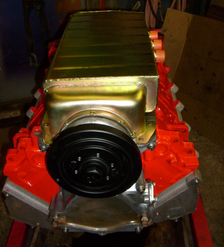

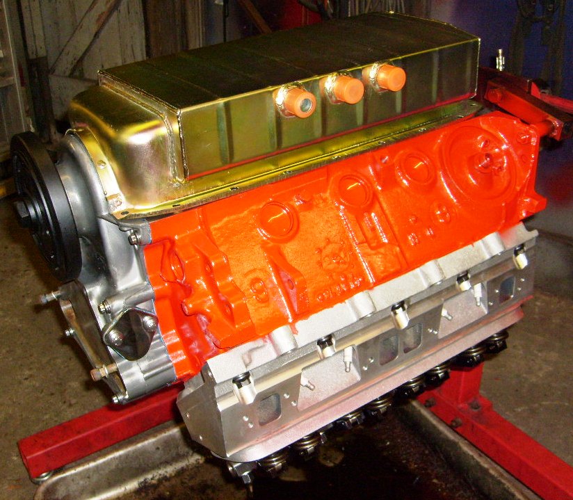

Went for " Massey combine red " in the end ;) block now painted.
Bronze gear fitted, oil pump removed, oilways blocked, pump drive shaft cut down and now sits in a phospher bronze guide bush.

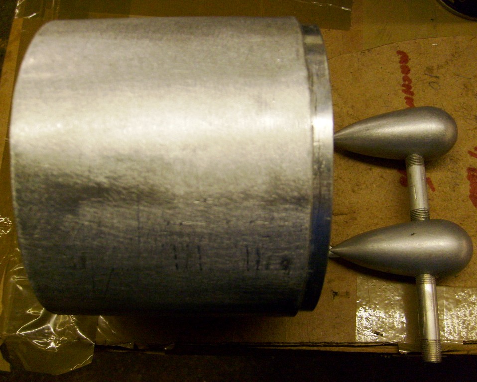

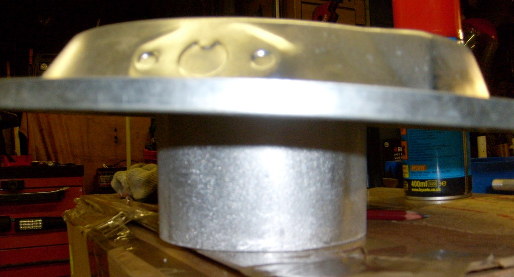

Refrigerated intake taking shape .. the alli bulbs will sit in the airflow under the filter base plate. Alli spacer will be insulated and sandwiched between filter and carb, off centred using studded rod.
Next job is check all rockers and adjusters and change out as required, then build up intake, then start on dry sump

Now thems is 8000rpm intake ports!! on a SB...are they W9's Jon?....look real nice to me.
Les
Jon Connolly
Posts: 3116
Post by Jon Connolly »

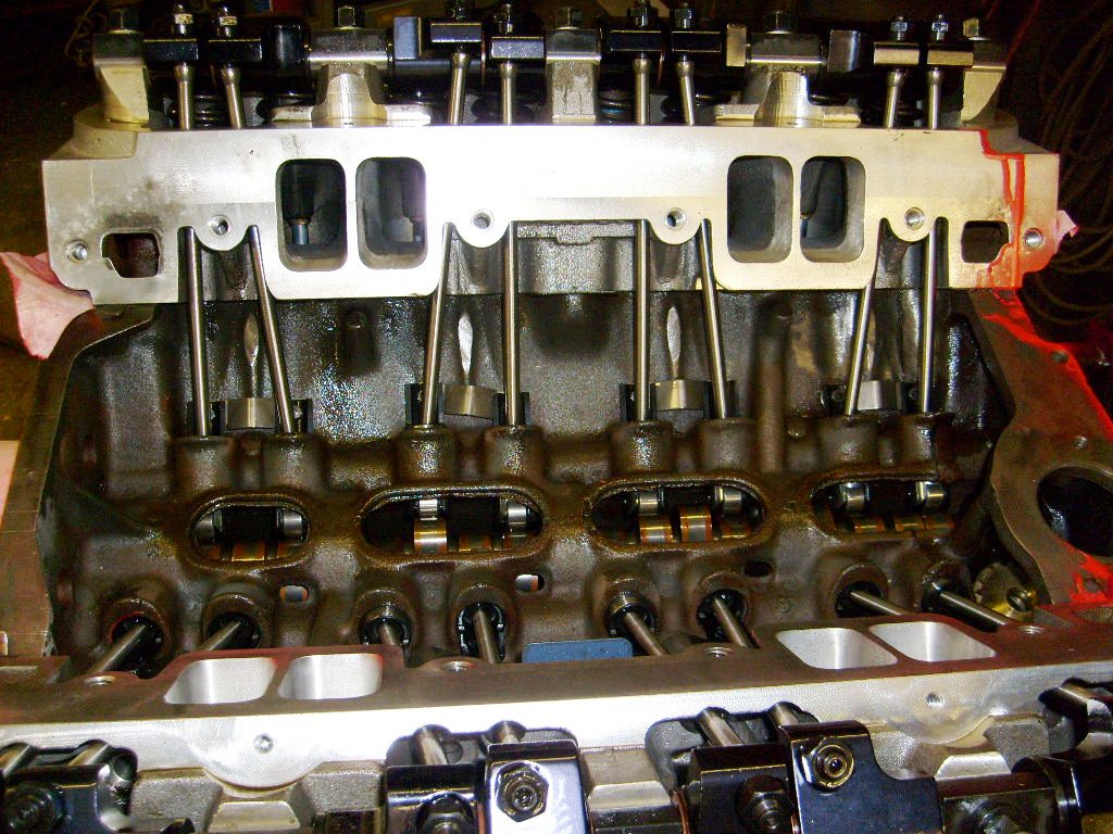

Thanks Les
These are Indy 360-1 .. gasket and port matched ... intake ports come out at 1.4" x 2.2" ... should flow circa 300 cfm
Std 10 bolt 59 deg factory block

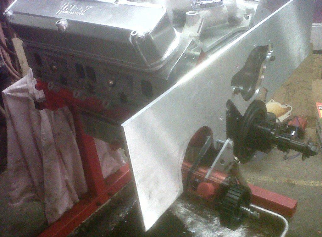

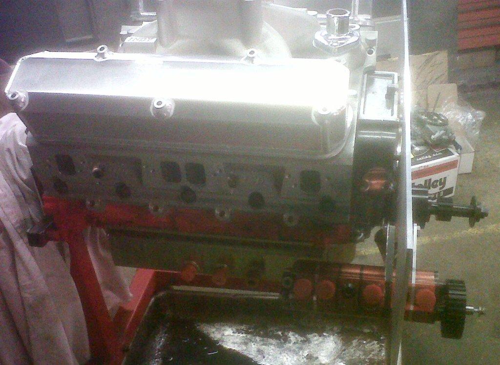

Waiting for some gaskets so can`t button up engine yet
Mocked up motor plate and dry sump pump and crank drive pulleys.
Next job is to fit mid plate and gearbox and lower both into car to get the oil pump to clear chassis rails. This will then give me approx position of pump which will then be mocked up with a few different belt lengths to get final position ... it`s coming out as a 30" ish long belt.
Sump pick ups will be below chassis rail with oil pump just on top.
Also check position of mid plate / firewall and mock up prop angle.
As the car develops I will get the I.C. in the right place by careful placement of heavy items : oil tank / fuel tank / batteries etc.
