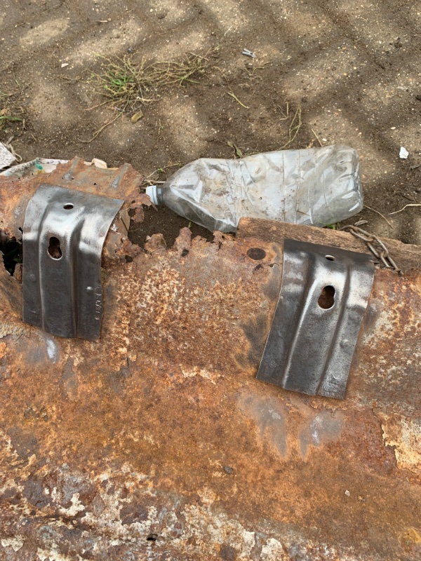

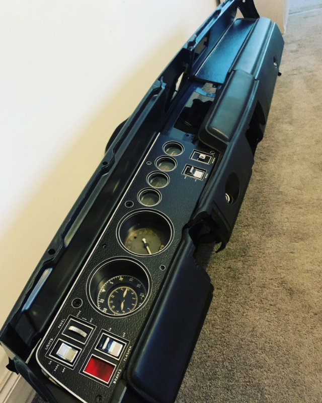

Spent this weekend getting closer to first start up. The car has a new fuel tank now and the dash restoration is almost complete I just need to decide if I’m going to attempt to re trim my existing dash pad or just bite the bullet and buy a new one. Dash core was blasted and powder coated, then resprayed the plastic trim and re lined all the chrome trim with a pen! Not for the purists but I’m happy with how it came out. Treated the vinyl on the pads with some leather polish. Used a Matt lacquer to finish for a bit of extra protection and to seal the paint.

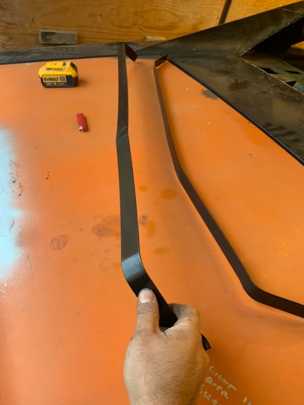

I just couldn’t bring myself to pay the £70 shipping for new gas tank straps and my existing, although a little pitted were not in bad shape so I cleaned them up and re finished them in a tough paint and called it done.

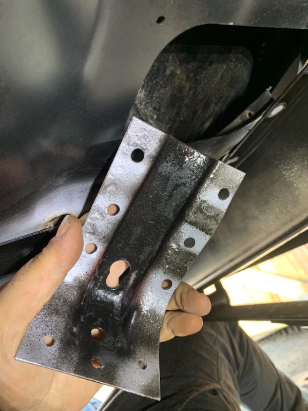

Also in good shape were the hangers for them so I cleaned them up and got them welded on.

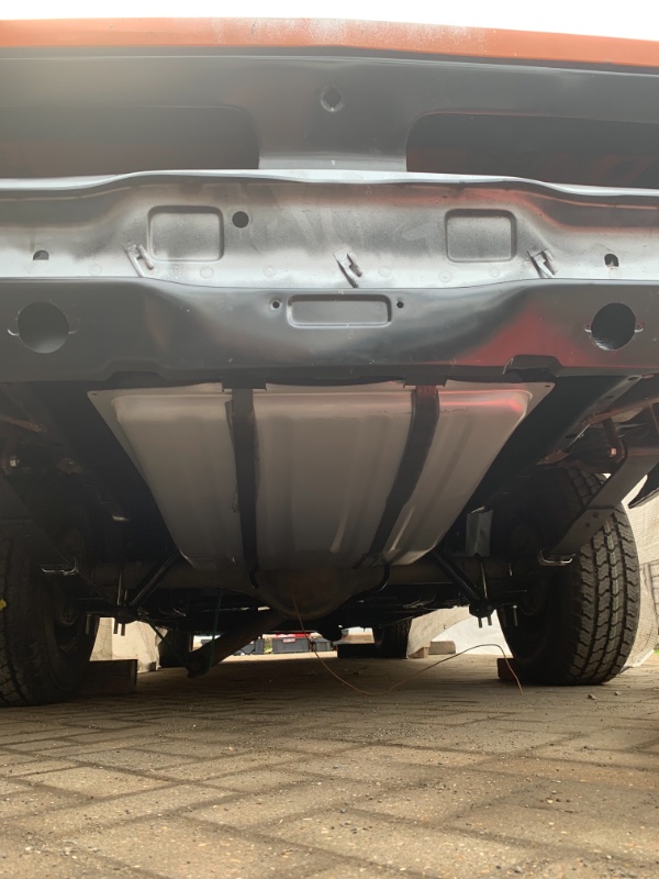

Por-15 the underneath of the car and the hangers and installed the tank. Finding 5/16 nickel/ kunifer fuel lines was not easy but managed to find them online. Prepped the hoses leaving the fuel tank and installed the wiring so I don’t have to struggle to do those connections in that tight little space, I can just connect the solid lines to the hoses next week when it comes to routing the line to the front of the car to the pump….
If anyone has constructive criticism here or advice please don’t hesitate as Iv never done a fuel tank before. Whilst it doesn’t seem like rocket science, if there’s anything I may have missed or done wrong please feel free to say!

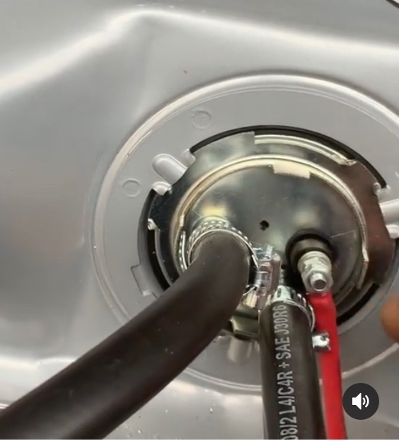

Great work.
You need to ensure that the Sender unit is earthed or the gauge will not read correctly, you cannot rely it in just being in contact with the tank due to the gasket.

Pete wrote: Sun Nov 14, 21 11:38 pm Great work.
Thanks Pete!
Was thinking I just earth to the body from the lip of the gas tank with a self tapper and washer or nut and bolt
