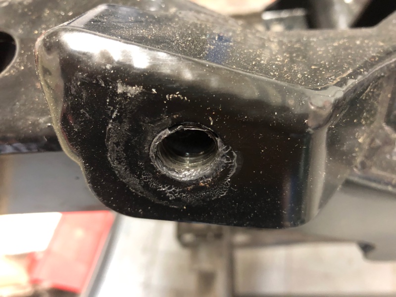

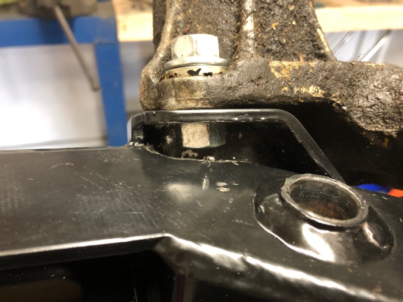

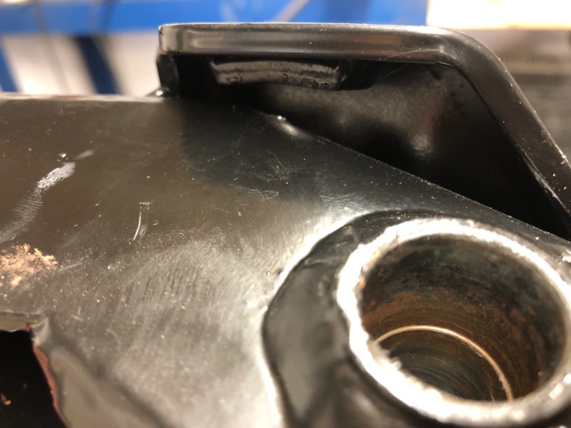

Torqueing up the last steering box bolt and American quality bites me in the arse again as the thread strips out, simply remove K frame to repair. You can see there's just a bit of metal tacked on rather than a nut in this position. Bit of careful keyhole surgery with a die grinder to remove said plate and clearance for a nut, sorted. Bolt on never is...

Posts: 9617
Re: Blue's Barracuda
that looks a bit rubbish for something i am guessing it wasn't cheap.. did they miss something out? should the nut have been there?

Really Frustrating, and not what you expect for the cost of the item.
