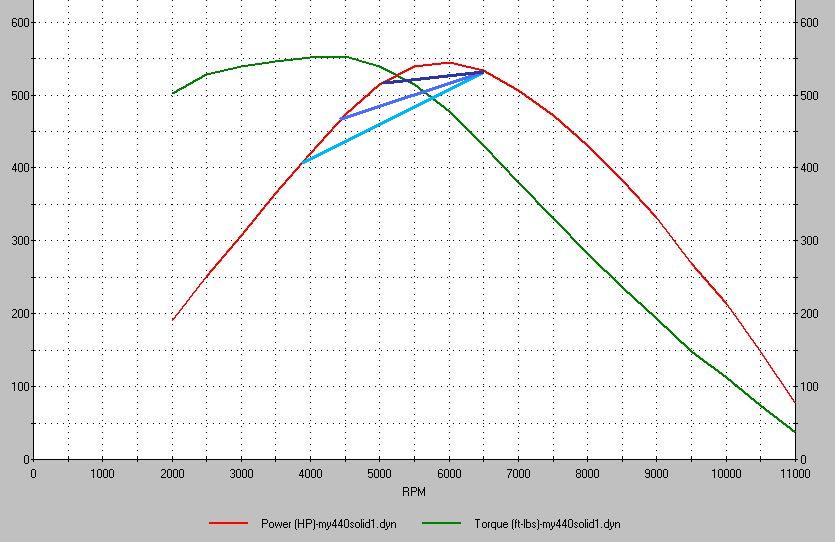

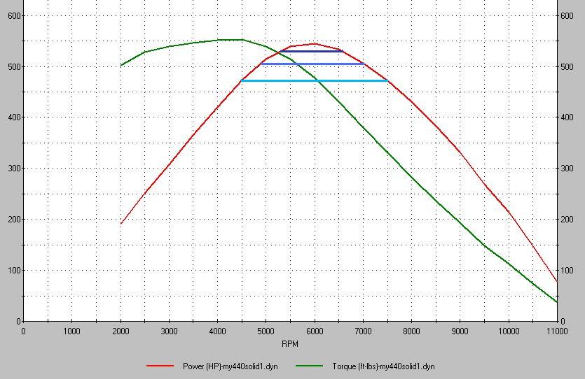

Ideal shift points work out as;
1-2 shift @ 7500rpm
2-3 shift @ 7000rpm
3-4 shift @ 6600rpm (if needed)
But no way am I shifting over 6500. :lol:
So on each shift @ 6500rpm my rpm will drop to;
2nd = 3846rpm
3rd = 4482rpm
4th = 5078rpm
So my average HP through the quarter mile is going to a lot less than the peak HP shown on the dyno sheet. Meaning 11.8 in the quarter is unlikely unless I am making more power than that.
shift ideal.jpg (84.27 KiB) Viewed 1790 times
