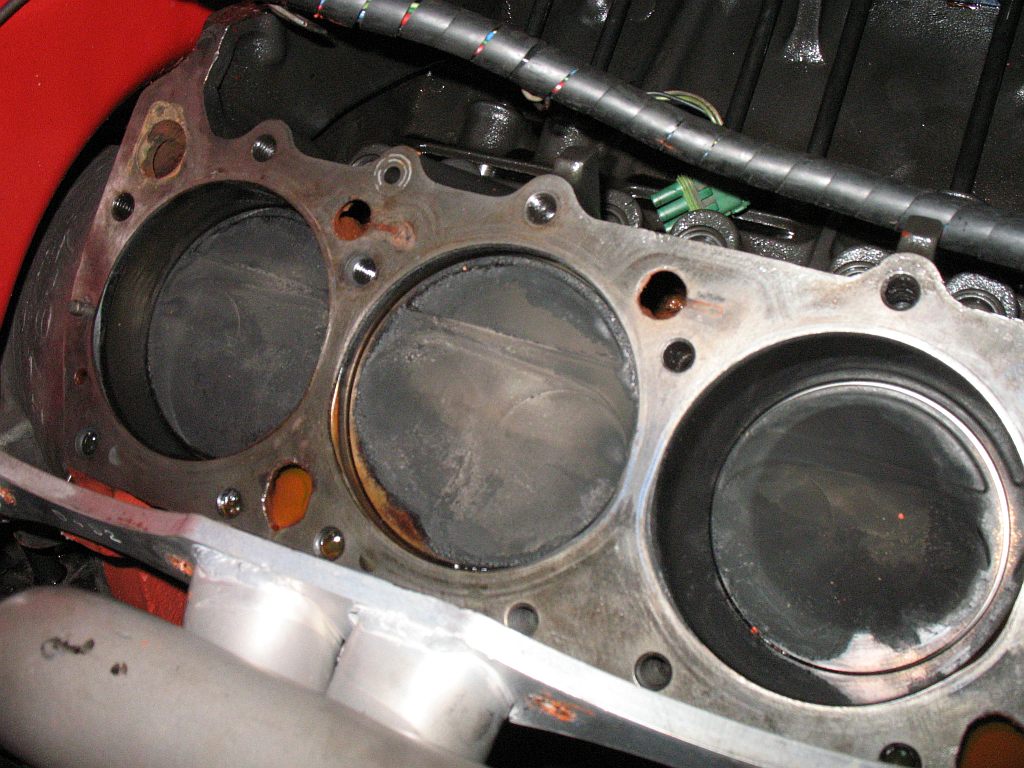

What make is that gasket ?
and are the Dougs headers you have one long flange or split either side of the centre two ports.
They obviously fit better than the Hookers, which always seem to blow at the rear port...both sides :roll:

Percy's Performance gaskets.
One long flange. Thick.

certainly doing the job apart from that little weeping bit.
do they weep at little, as it warms up and cools down ( when you hear it)...with nothing happening due to the expansion (Heat) when driving.
I know it obviously is...bit of plumbing tape/ or silicon on the header bolt threads ?
ALL KILLER NO FILLER
Tried all sorts on the bolt threads. Hence my worry it is the head. I am loosing half a radiator full of water every 150 miles or so. You can hear it boiling on the header flange and there are bubbles in the water.

Magnaflux the heads...that'll find it if its something that happens once the motor is up to temp.
