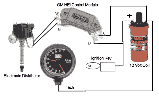

(AC DELCO,Wells,petronix,car quest,Napa, niehoff,Borg Warner,GM,Mallory,jegs,moroso) (DM 1906,D1906,ACC35361,aCC35367,D2000,21040,ECH TP45, Dr400 ,CBe4,cbe22,10482820,607,555-40600,97857) (module,hei,)
run them with no ballast and a 12 volt coil i.e blaster, lucas 12 volt any magnetti marelli or Bosch 12 volter off a 6 or 8 cylinder mid 80s car or the stand alone original HEI coil off a late 70s 6 cylinder chevy truck not the coil in cap one off the corvette and other swish cars it has no spur connector for the king lead due to the rotor button connecting direct into a port in the coil when it is mounted in the cap

Thus
aaa hei_pic.gif (19.87 KiB) Viewed 484 times
Posts: 13858
Yes, looks simples :thumbright:
