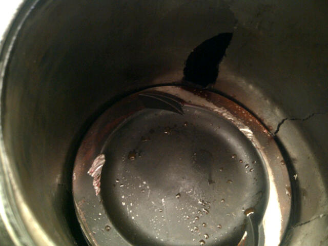

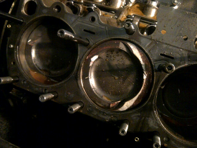

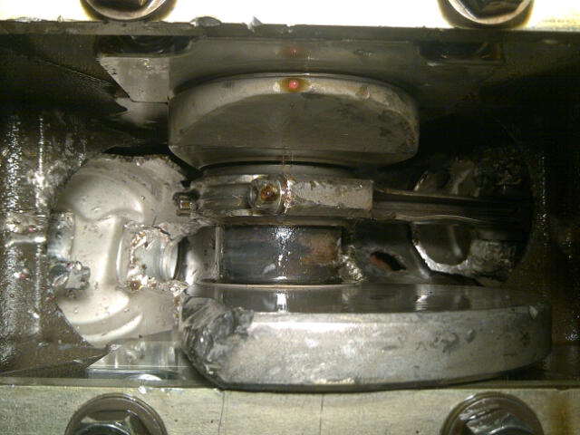

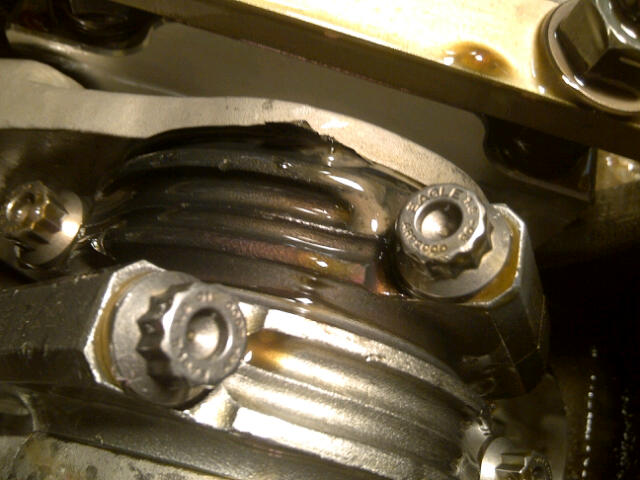

Had a look yesterday and it looks like something has blocked an oilway in the crank. No 6 rod then let go smashed the bores then allowing the rest of it to hydraulic, that is our best guess so far.

Thats not a pretty sight John was there any damage to the heads as the bottom end looks fooooooked :(

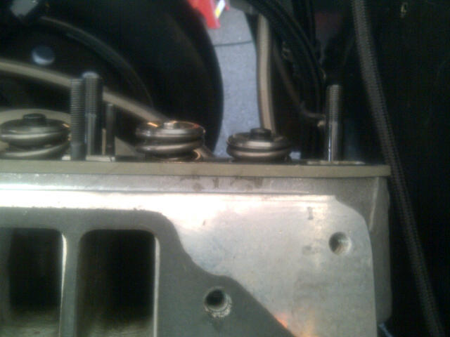

I think there maybe 2 valves that are not bent!! But they should be saveable, not had chance to check them over properly yet.

The girdle is fine, it seems it was no6 that let go and no 3 was about to follow. There is not much left of no5 bore, most of it was in the sump.

thats a real bummer jon you need follow the path of destruction verry carefully like csi find the cause,,
