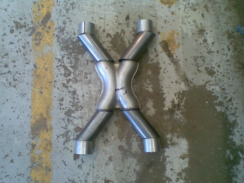

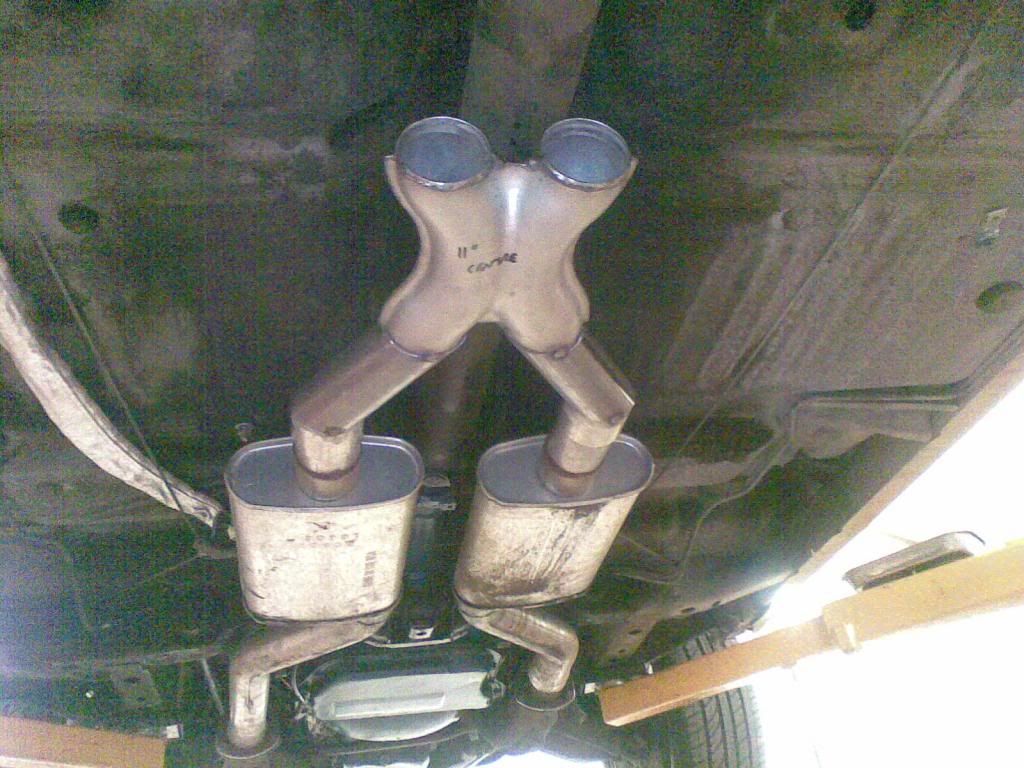

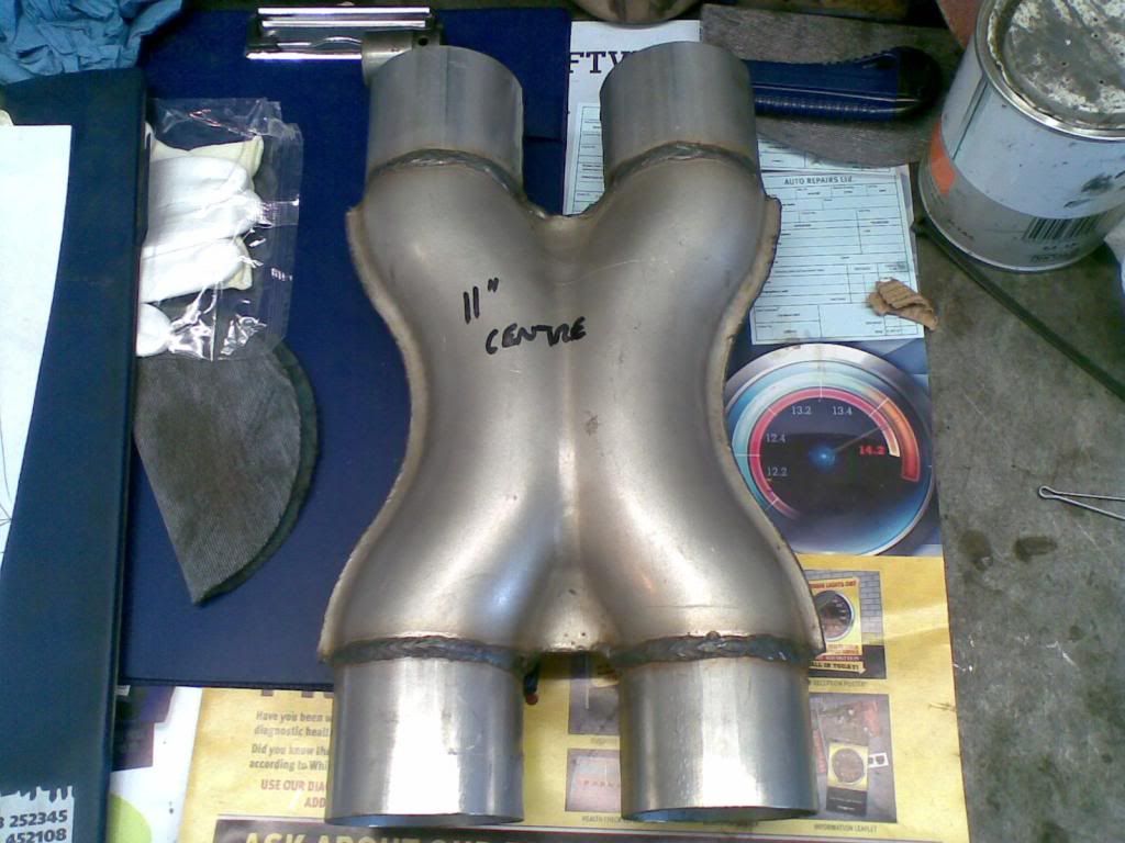

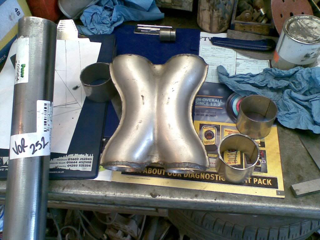

Had a play with the exhaust X pipe at lunch today. I had to cut the X pipe up because my Dart has already got a 2 pipe system built by someone else, and the distance between the 2 pipes is bigger than the standard X pipe.
I'll have a weld up tomorrow lunch time.
Oxygen sensor will go in the X pipe .

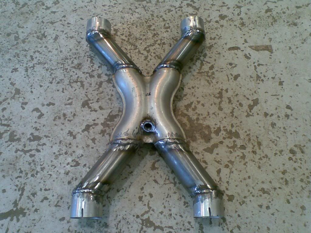

Did a bit more exhaust this evening.

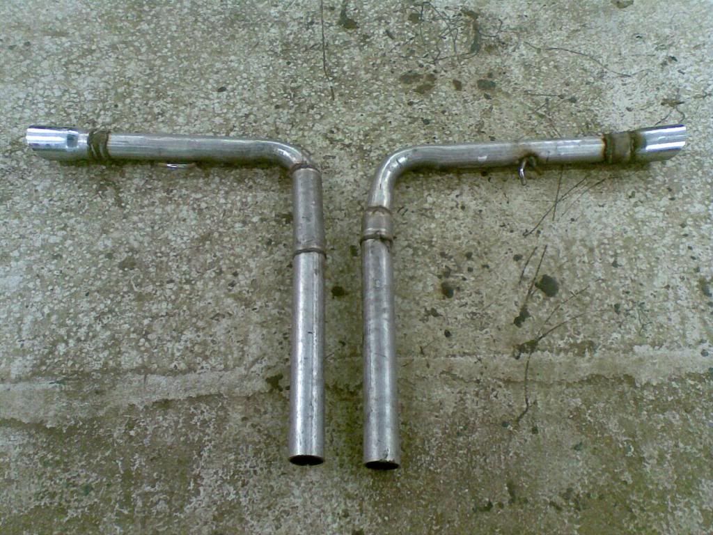

Cut off old nasty exhaust pipes
Tacked and checked for fit
welderized
Test fit, just need to make up the rest of system.
I would like to go for over axle pipes. Does anyone know where to get some in the UK ?

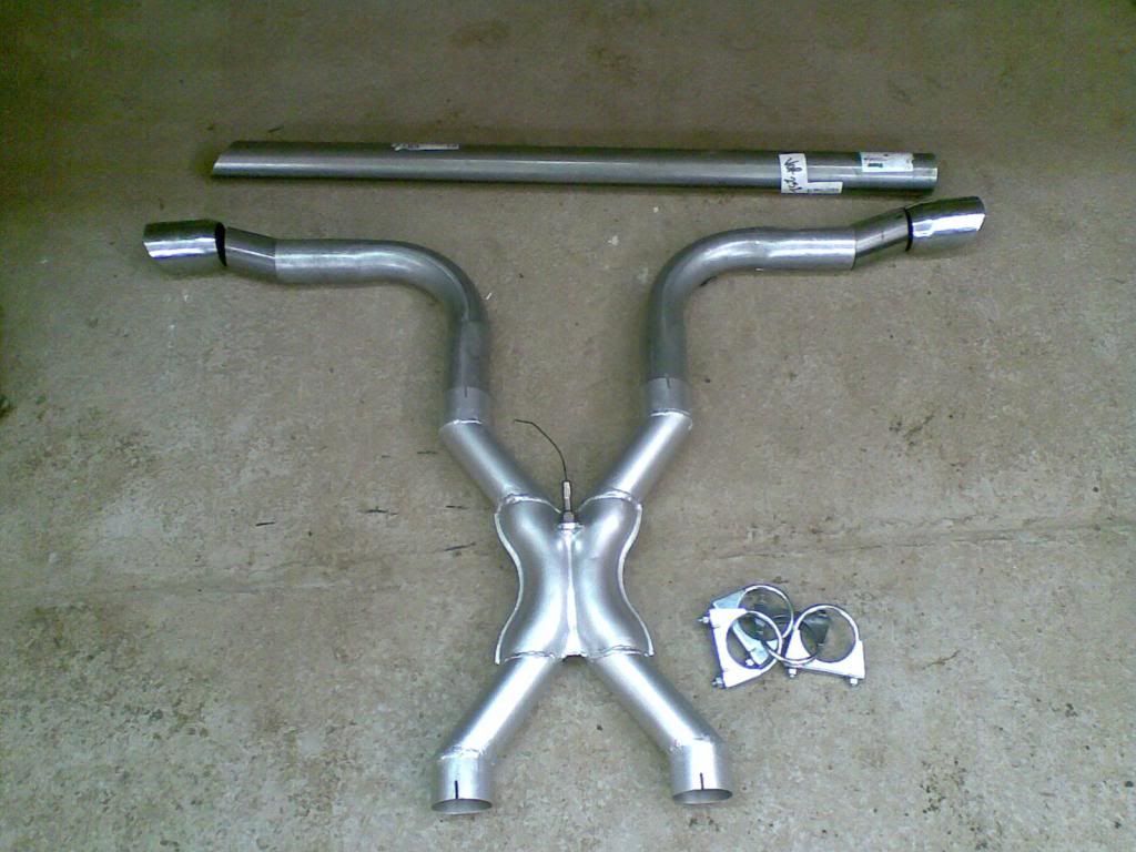

Finished off the X pipe today, and fitted the oxygen sensor boss.
Waiting for some welding bends and clamps to come tomorrow.

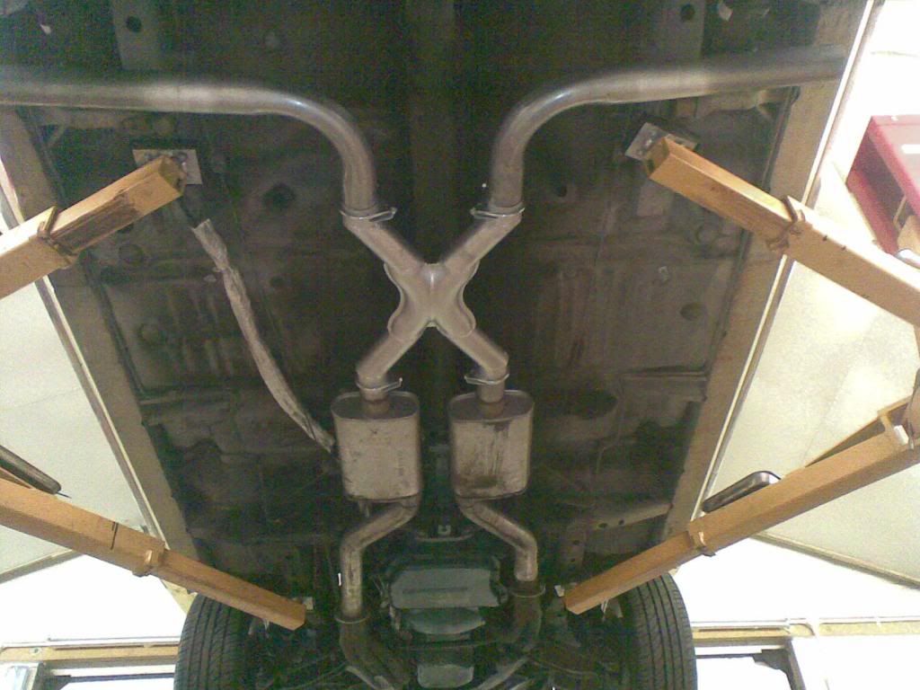

I've done a bit more exhaust tonight.
Just need to source some mounts, and hang it right.
Sounds like a V8 now , rather than 2, 4 cylinder engines. And runs much smoother :thumbright:

Personal choice , pipes, I think. But I also wanted to stick the oxygen sensor to be able to sense ave mix of both banks.

The benefit of the X pipe for me,other than the oxy sensor, is that it runs smoother, its quieter, and should be more responsive , as one bank of cylinders, help suck out the other bank ( scavenge effect ) :)
