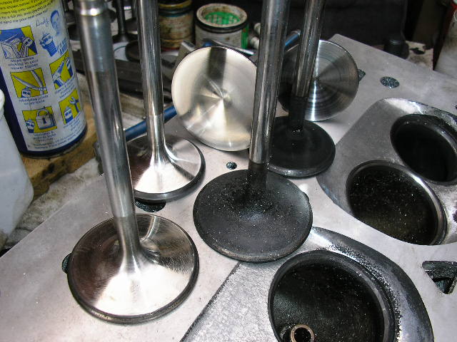

Nice valves TOO!
Clean valves.JPG (75.28 KiB) Viewed 1423 times
