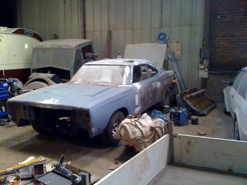

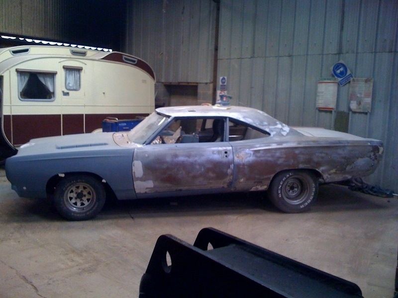

My new project is a 1968 plymouth roadrunner. purchased off ebay pics as advertised.
EBAY PICS
The car has been off the road for some time it was owned by someone in swindon for 23 years, with two previous keepers, it was imported into the uk in 1973. from swindon it went to leicester, rutland then to its last owner rich in arkendale near harrogate. back to Swindon to be rebuilt whats the chances of that. rich spent the last year working on the car the underside has been repaired ans rust treated.

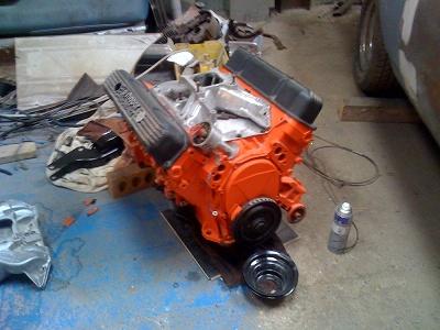

engine is 383 it has been rebuilt with new rings shells and a mild cam.it not the engine that came out of the car. as number is for a 67 engine. richard said it was bought by the last guy who started to restore the car

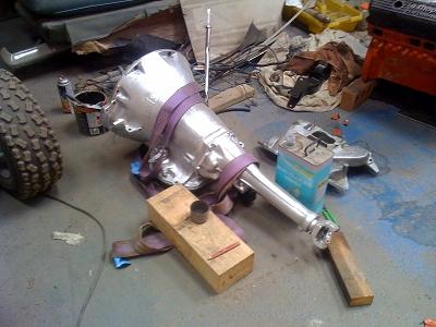

gearbox has been cleaned up with new filter.

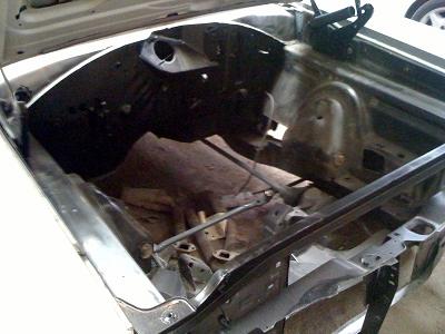

engine bay has been painted mat black with will changed same colour as the car. front suspension has been powder coated in grey looks good

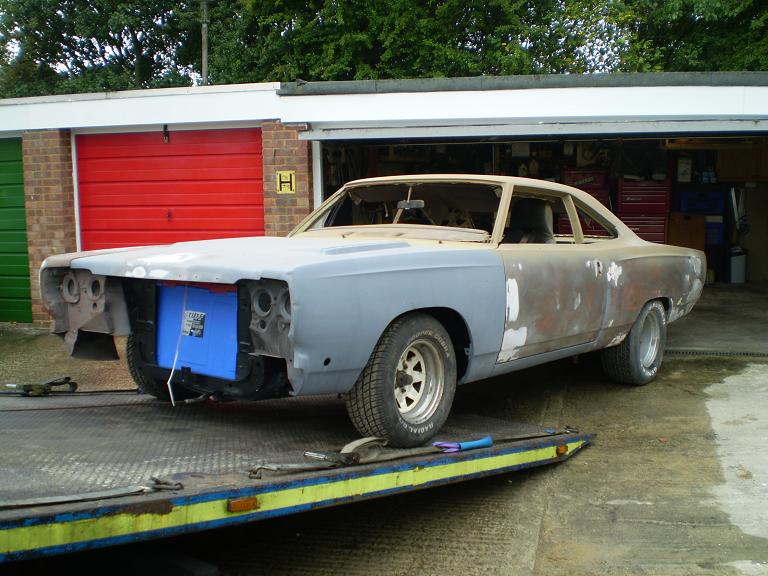

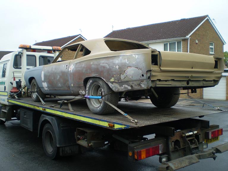

Nick Eagle 68 Roadrunner

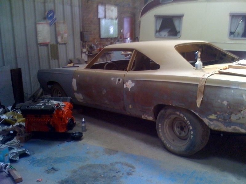

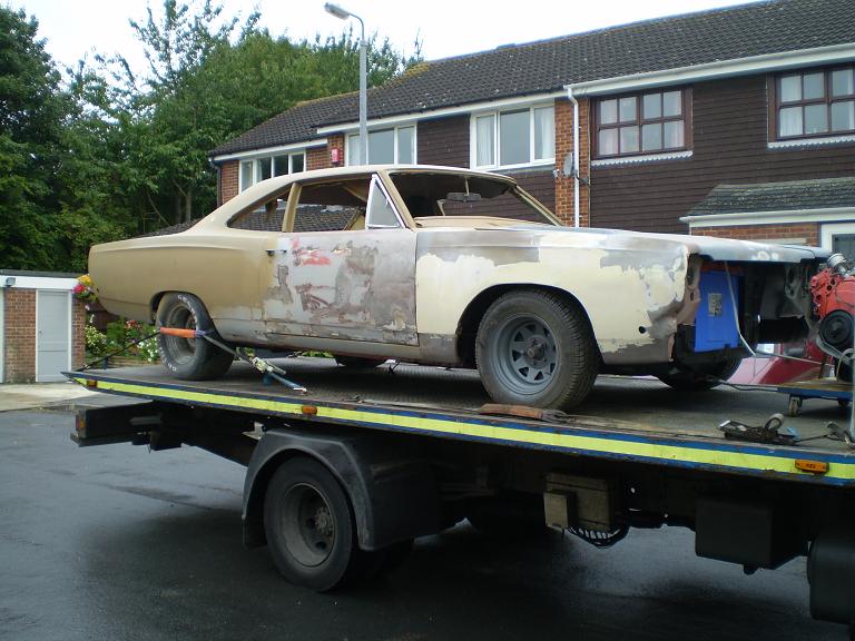

thanks to kiwi the car was brought home 220 miles.loads of bits missing just a rolling shell. got a engine and box with the car though hopefully will be ok.( not numbers matching engine);
home at last now fro the fun part

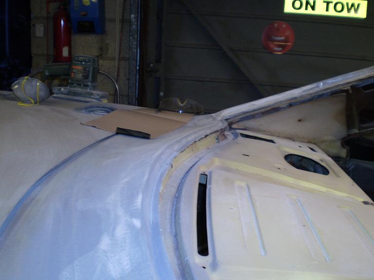

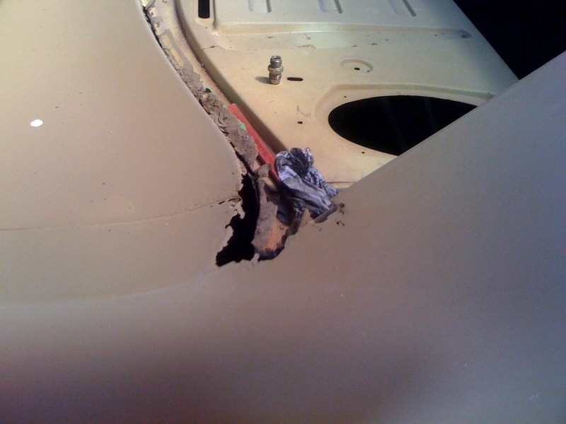

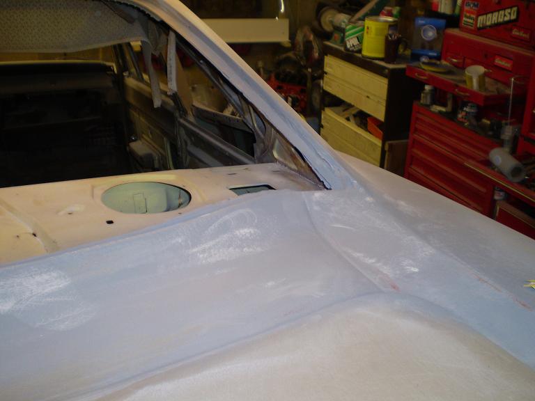

first repair was the rear window frame the corners were gone completely

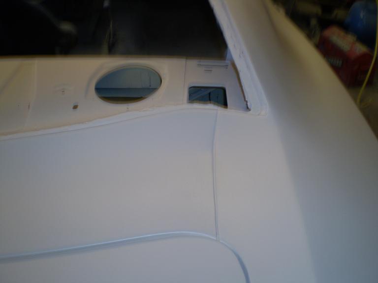

and the lower ledge was missing. two corner repair panel from Dunk at the nats and repair done.

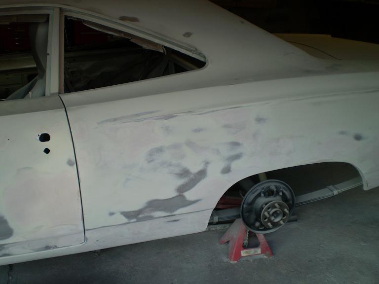

welding filling and sanding its looking good
Posts: 13003
Lovely, that's a bit less water to run down and rot your rear quarters! ;)

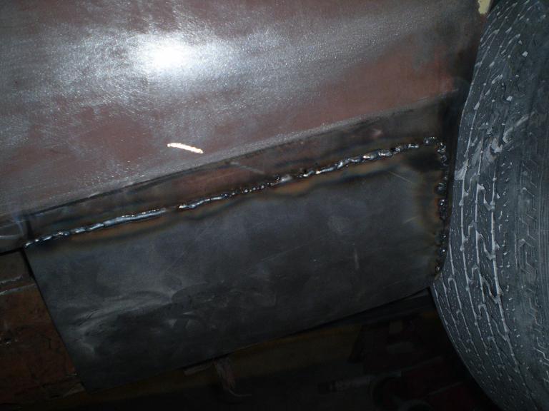

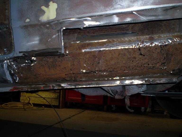

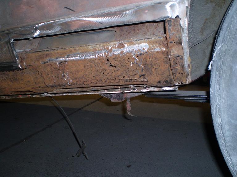

had to cut the rust out of both rear lower panels mig welded repair patches as required some filling and shaping. i know the car was standing for some time outside when it was first in swindon a lot of water must have collected in the lower panels rotting them out.
