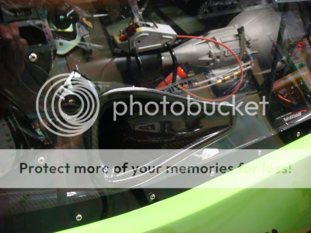

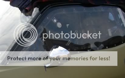

If its proper polycarbonate you can bend it to 90 Degrees or more with slight bit of heat /warmth to help it stays were it should be
I used 4 mm thick for front & rear screens & 5mm thick for the side windows.
What I did do & was a Bananarama! job, was to cut out the old windscreen supports & make new supports for the Polycarbonate screen. Then got my mate to welded in new supports, so that I ended with new screens flush to body.
A lot of work, but makes the difference when looking at the car, downside being if you wanted to revert back.
I used stainless button heads to secure (think 4mm ? but cars not here to check) to secure to frames or wind screen surrounds.
After the screen surround, the next longest job was marking out screw holes to get them equally spaced, no big drama, just a lot of measuring & marking.
I didn't use any sealer or rubber to seal, if its really pooring/hammering down water will seap by.
New screens were masked & painted black, if you don't use the right paint it will just peel off, ask me how I know
Oh yeah, the side window frames - I bought the window tabs, as was too many to make & was not much to buy tabs & saved considerable time.
Think I got them through chassis engineering, not sure what they were advertised as ? Also had a nice slot in them, kind of like a lightening/weight reducing slot
Cheers

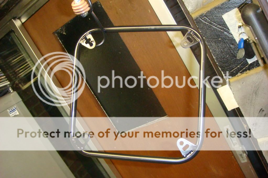

Heres picture of the tabs, I also used them when I was making parachute mount

I forgot to say, I used button head screws, as this allows a slight adjustment, where as countersink have no adjustment.
Also depends if you have a little pillar drill, as this way you can get all countersinks to the same depth & how accurate you are in marking & drilling.
