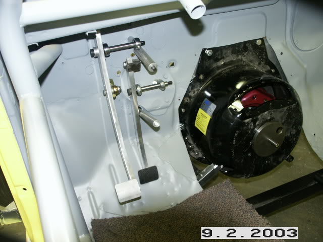

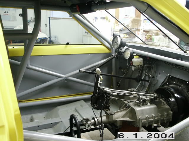

Liberty equaliser 5 speed with dual bonanfonte clutch
Is it me or do these American homebuilders fall into 1 of 2 catagories ?
a ) Genius
b ) Shambolic
