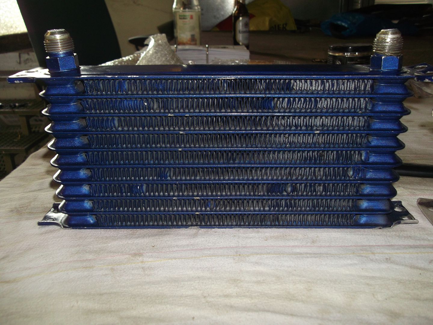

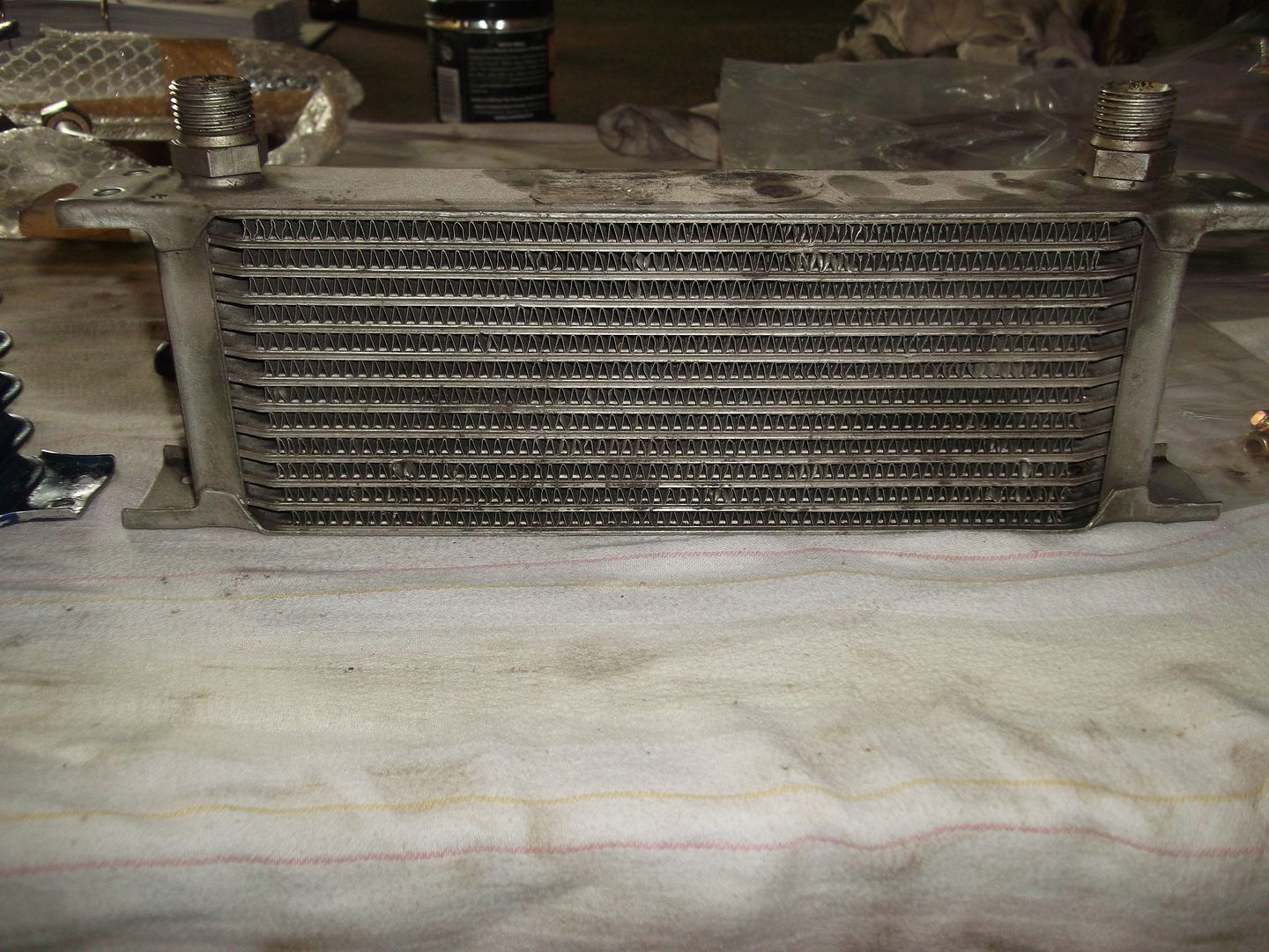

Im planning on installing 2 x oil coolers on the front of my car in front of lower part of rad
1 x engine oil
1 x gearbox oil
From what i understand an oil cooler is just that it cools oil and there is no diffrence between engine or gearbox oil.
My question is what is better more rows which are smaller or less rows that are bigger.
Below is a pictures of 2 oil coolers if they where the same external size what would be better. If you understand what i mean :?
Many thanks
WIll
<a href="http://photobucket.com" target="_blank"><img src="http://i73.photobucket.com/albums/i205/ ... 45cab3.jpg" border="0" alt="Photobucket"></a>
<a href="http://photobucket.com" target="_blank"><img src="http://i73.photobucket.com/albums/i205/ ... ff2d97.jpg" border="0" alt="Photobucket"></a>
<a href="http://photobucket.com" target="_blank"><img src="http://i73.photobucket.com/albums/i205/ ... 6dce82.jpg" border="0" alt="Photobucket"></a>
You have to look closely and decide which has the most surface to air ratio.
I am using one very similar to the blue one you have and it seems more surface area will cool better ,
and make sure you leave a space/gap between the radiator or you will be pulling hot air from the cooler in to the radiator
I placed mine in the valence area 3 years ago not in front of the radiator and I drove it yesterday in 35c temps for 50 miles and I only have to run the fan in heavy traffic ,
OTHERWISE THE COOLER WORKS AT HIWAY SPEED with out the fans , REALLY WELL :thumbright:
Those stacked plate designs are so efficient you will probably find a very small one will cool enough anyway. I fitted a small one to my trans and it never got above 160F in normal use.
The gap you need between the cooler and radiator is more to do with airflow. If the cooler is too close the fins can line up with the radiator cooling fins and block airflow. So a half inch gap is needed to allow the air to swerve around the fins and airflow through both increases.
