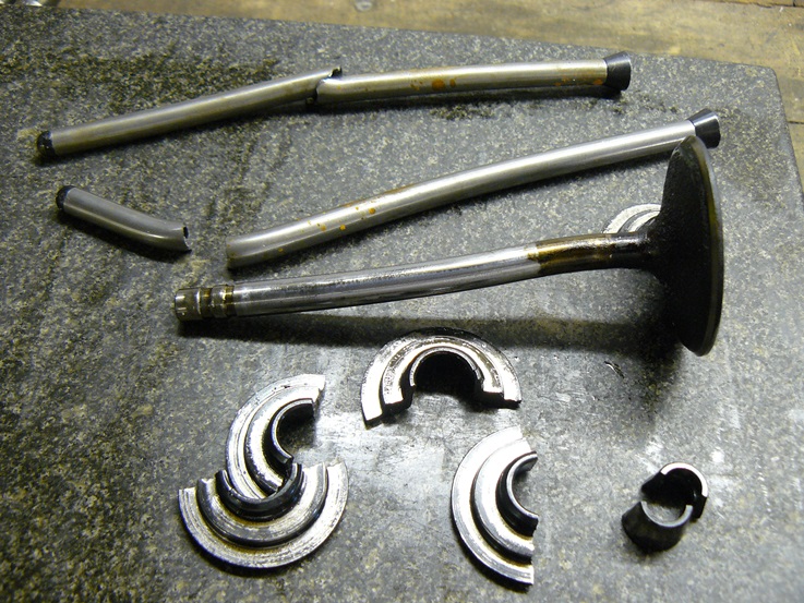

After weeks of frantic preparation involving multiple gearbox and carb rebuilds, I eventually got to packing a couple of days before. I thought I'd brought everything but unfortunately no spare pushrods... :roll:
Yes, my first breakdown was before we even got there!
There was a 'clang' on the M1 and sure enough, when we pulled over, I found a busted pushrod.
I wired this and the rocker off the cam and made the last 40 miles on 7 cylinders :thumbright:
With loads of help in my search from Ade, Pete, Ivor and others... Miles tracked down a set in the hands of Dave Bishop early Saturday afternoon.
I dropped the full set in and the car sounded sweet as anything!
I quickly signed and joined the queue.
Approaching my FIRST EVER RUN, I was pretty relaxed until I suddenly realised there were only about 3 cars ahead of me! :help:
Luckily Pete appeared from nowhere and signalled me through the burnout box, etc. That took a lot of stress away, BIG thanks for that mate :thumbright:
Burnout went well, I rolled up to the line feeling confident, car sounding better than ever.
So... the tyres let go in 1st and 2nd, I couldn't get 3rd for a second, but floored it again when it went in and eventually crossed the line.
Thanks to my tell-tale tach recall, I found I'd hit 7500rpm (shift light was at 5800, what reactions!!)

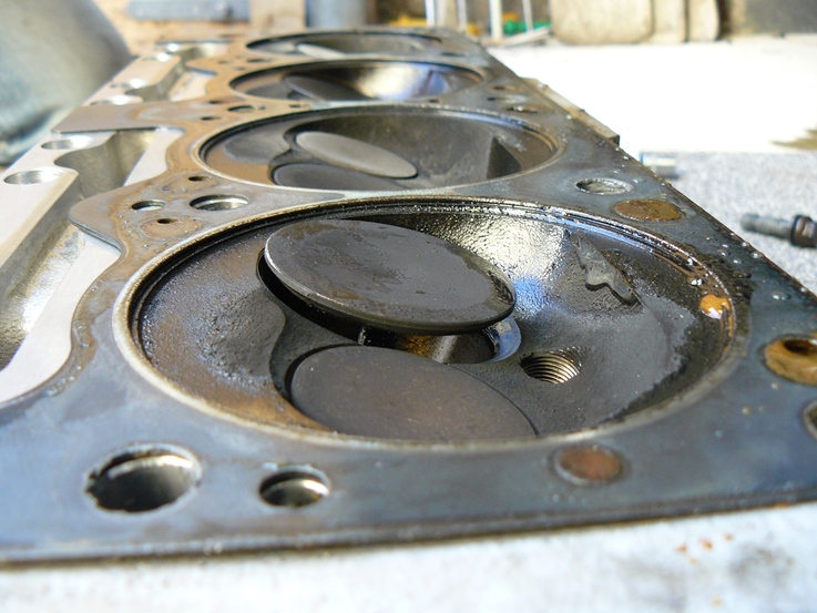

The resulting valve float bust 5 inlet spring retainers. One had come out completely letting the valve drop into the piston, luckily only bending it.
GAME OVER :(
2013 July. The Nats. Some broken bits.jpg (226.79 KiB) Viewed 4761 times
2013 July. The Nats. Bent valve.jpg (193.13 KiB) Viewed 4761 times

So, who do I send me head to for a new valve guide? :scratch:
Posts: 9570
Blue wrote: Unlike David Cameron, we really are all in it together!
he once sold me a clutch plate
right diameter
right spline
only fitted a ford sierra
rotter
Posts: 9570
any engineering shop should be able to do it
however i have heard great things about
Cylinder head shop (if he still does it)
http://cylinderheadshop.com/home/
I got mine done by
power for peanuts (dermott) http://www.power4peanuts.com/
becasue i am a cheapskate
dermott gets his guide a seat material from or from the same place as the top fella
however you are in wales
so try Ferriday
http://www.ferriday.co.uk/

Would stiffer valve springs/ titanium retainers be a good idea or would that just create other problems?
Guy
Posts: 5002
Location: Behind a Camera
Post by Guy »
The valve springs need to be matched to the cam you are using so stiffer springs would only put unnecessary load on the rest of the valve train, ie pushrods, lifters, cam and the only result would be be a loss of horsepower and potentially cause rapid wear or failure of components, You would be better off with upgrading to 10 deg locks and retainers which hold in place a bit better. Titanium retainers are a good way of losing weight in the valve train in high rpm applications but I doubt you would see any benefit in your motor.
The best thing you could fit to your motor would be a decent rev limiter to stop you over revving it. ;)
