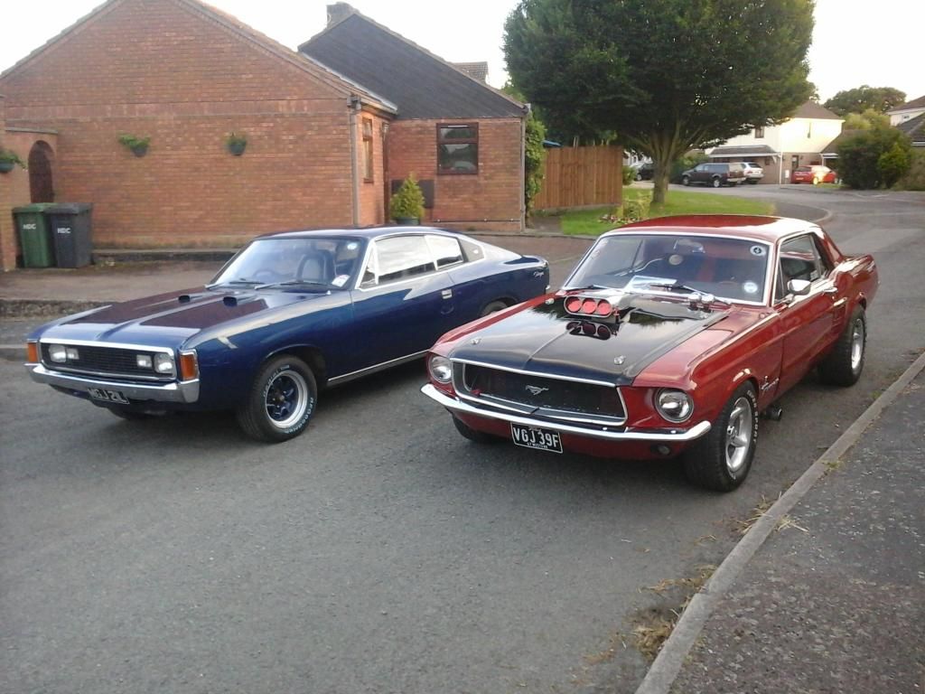

I own a'67 Mustang coupe drag car, (not taken it up the track yet and it is for sale so I guess I won't).
I also own a '72 VH Valiant Charger 770 which I absolutely love. I have seen a few threads relating to it on here which was a bit weird but be assured that it is in good hands now lol :help:

It's the blue one lol. A chap called Rav sold it to the guy I bought it off about a year ago. It had some serious issues and I'll never know how I got it home! It had skinny tyres and huge nasty rims on it, it was like trying to control a shopping trolley in ice. It looked ridiculous from the back, it was jacked up and there was about 8 inches of shackle hanging down at the back. Luckily the guy I bought it from threw in the original wheels so I put them on, I have had air shocks fitted, the brakes were knackered so I had all that replaced and new tyres. It handles much better now. Needs a new carb so I'm in the process of sorting that out. Some say go Holley some say stick with Carter. I am leaning towards a recon Carter from Hemi Performance - but any thoughts would be really appreciated
The exhaust is blowing a bit too so that is on the to do list!

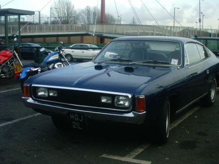

Hi Sammy,
Welcome. Your car has ended up near where it started. Ray had it after a guy called James in Cambs restored it.
Glad to see it back in the club, it was one of the best around.
Mine is the grotty pink one, a VJ with VH front end.
You should get plenty of advice on here from members to keep your car sorted.
Here it is at the Ace Cafe Australia day in Jan 2004.
