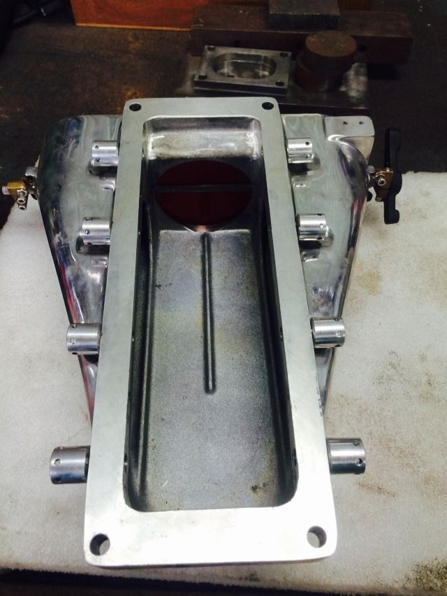

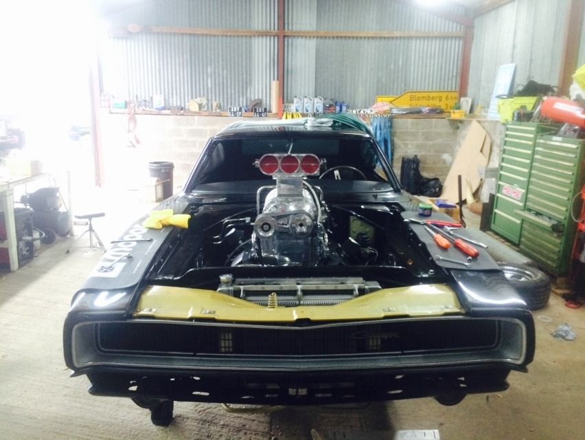

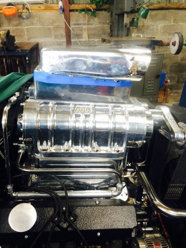

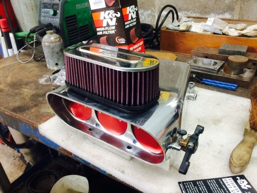

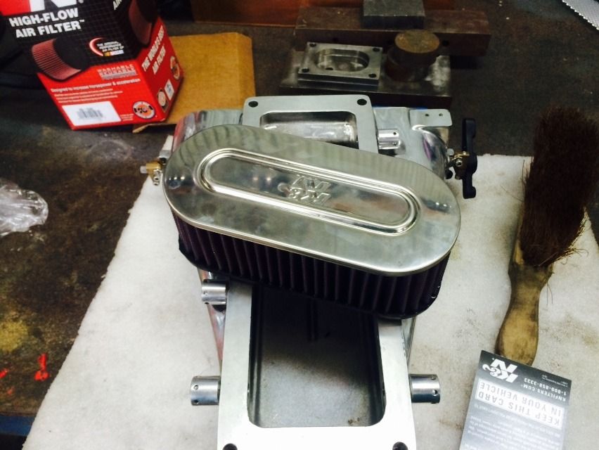

Firstly Fuel is injected at the blue line so the filter has to be above the line.

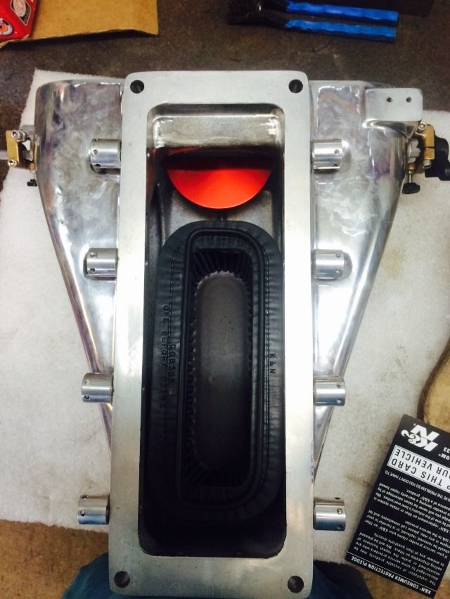

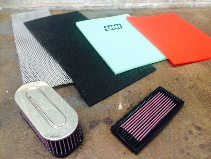

I have order muti filters. The best i got is the oval K&N filter.
Q. Does it look to small ?
Q. you got a better idea

Part HA-1245 Product Specifications
Air Filter Shape Oval
Filter Material Cotton Gauze
Height 2.875 in (73 mm)
Inside Length 6.5 in (165 mm)
Inside Width 1.75 in (44 mm)
Outside Length 8.5 in (216 mm)
Outside Width 3.75 in (95 mm)
Weight 1.2 lb (0.5 kg)
K&N Applications for HA-1245
HA-1245
1985 HONDA VF700F INTERCEPTOR 700 - All
1984 HONDA VF750F V45 INTERCEPTOR 750 - All
1984 HONDA VF700F INTERCEPTOR 700 - All
1983 HONDA VF750F V45 INTERCEPTOR 750 - All

They are never gonna flow enough air to fill those cylinders ............even if I they were UNDER the blower :lol:
You only need to stop large airborne particles & any poss debris, like a dust cloud, I would spray some light oil on a foam element gauze & be done with it Will.

Ask in a bike shop mate, there's a million different shapes and sizes of filter to fit inside airboxes. K&N type, oiled foam, etc.
db wrote:Ask in a bike shop mate, there's a million different shapes and sizes of filter to fit inside airboxes. K&N type, oiled foam, etc.
I have buddy and the VF700F bike filter pictures above is the biggest that will fit in the hat. (Which I don't feel will let enough air past it)
Think I will go with Adrian's ideal and make something to hold the corse foam.
Will have to be strong to not get sucked down the blower :roll:

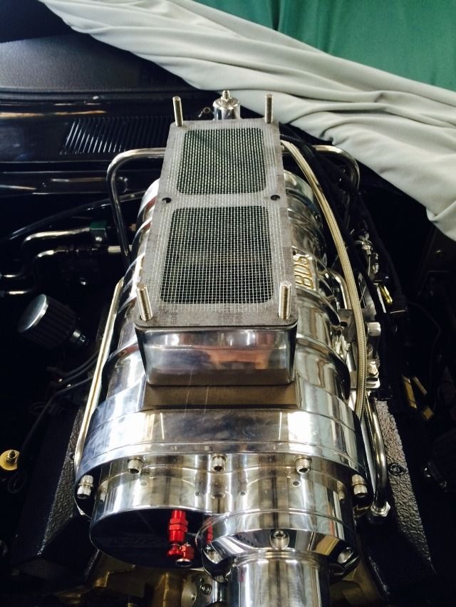

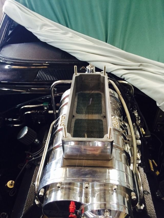

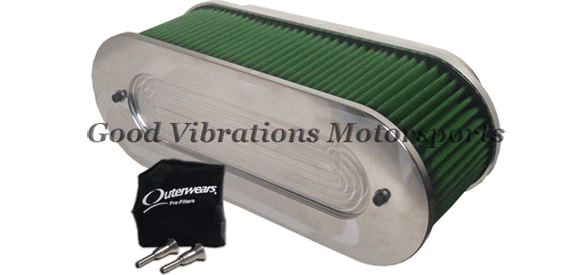

I never ran a filter, but did run a blower filter
Do you have a gauze filter over the blower inlet, they sell them at Good Vibrations.
inlet gasket G-2014 or similar
Yes I'm Running 2 x blower gasket gause

If it was me, I think I'd just use the gauze, that'll stop anything chunky.
Filters pretty much just make your bores last longer... Now I don't want to sound negative, but is long-term wear likely to come into play before catastrophic failure? ;)

Think you'll be okay with what you have.
You've got the throttle blades plus the gauze, so bar dust, you should be okay.
Just don't tail gate........ :thumbright:
You could always put some fine stretchable material ( like tights but not prone to combustion), over the metal gauze for fine particle filtering.......it'll be a PITA though to do checks for blockages/clogging!
Will. I think as soon as you introduce any foam/material type filter you will cause problems. That thing is gonna SUCK !!!
