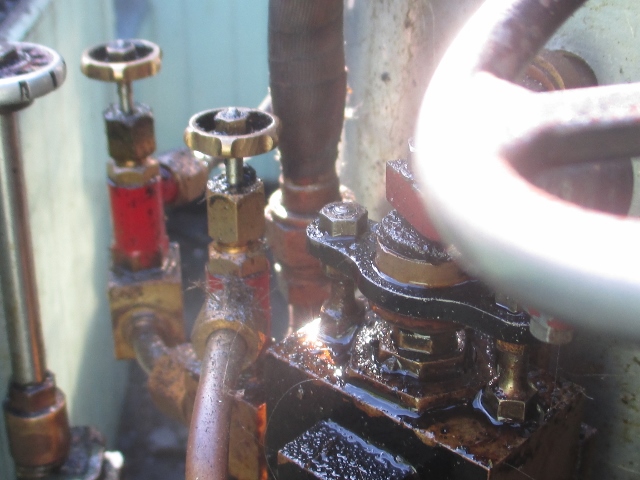

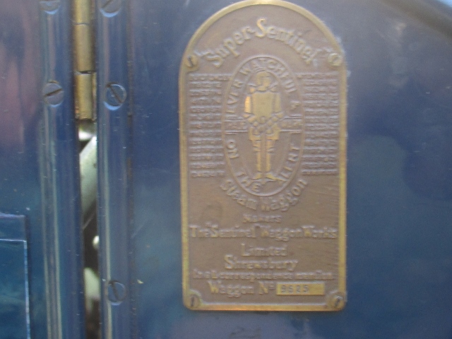

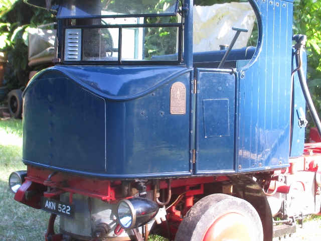

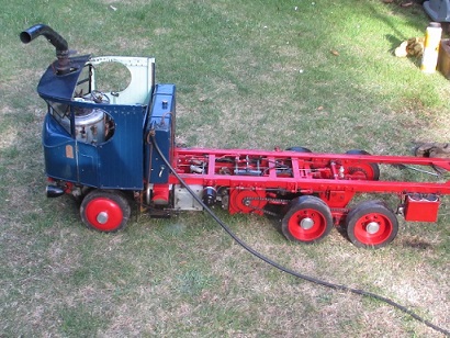

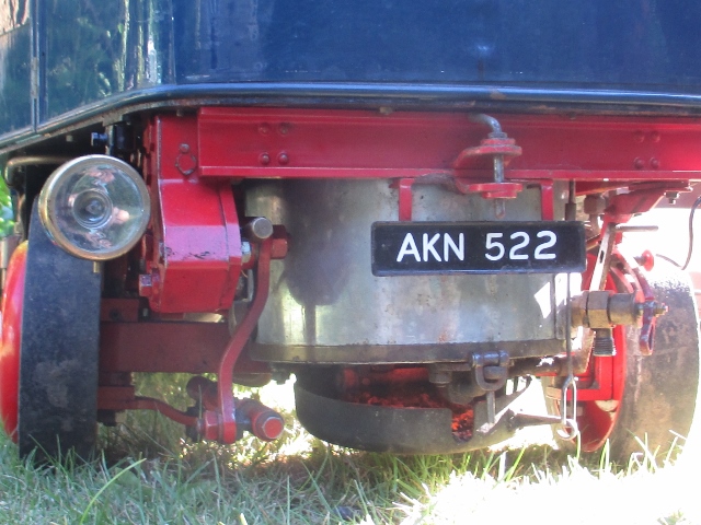

Had a bit of fun this afternoon.

Excellent stuff :) Is that a Tiller or a Spade in the Cab?
latil
Posts: 12076
Post by latil »
Long handled coal shovel.

Ah the Super Sentinel with the ash tray so you can hit a pheasant and barbecue it all at once...I bet that was an experience you won't forget...

This took my late father some 40 years to build,it's 2" scale and is exactly like the real thing to drive and manage.

Wow, we know our steam here but didnt realise it was 2 inch from the pics, thought it was full size.
Excellent. There are several sentinels local to us, buses and lorries and a 1/3 rd scale electric one.

Everything was measured and scaled from friends fullsize waggons,only the engine is a deviation,following a Doble compound design and larger than it should be.

The perfect scale makers plates were photo etched using positive/negative images of the real thing,then reduced to the correct dimensions.The screws holding them are 14BA,about the thickness of a needle!

For driving it there is a plywood flat bed with seat but there is also a perfect scale wooden dropside body with all correct hinges and catches for photos.
I don't have a picture and it's hidden away in storage now.
You may appreciate just how tight it is for fingers in the cab :lol: Burnt finger tips are the norm after 5 mins.
Boiler is all copper at 120psi with a superheater,original steel boiler was as per original with studded flanges to take it apart for maintenance,sadly it lasted 8 seasons before rusting through,that was 4.5mm powerstation boiler tubing.
