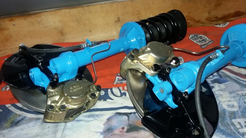

dave theres a company next door to my new workshop in stourport and all they do is refurb calipers,master cylinders and servo,s etc these are the finished results of a mk 1 rs2000 escort im doing, obv these are smaller than yank but £35.00 each
ross rs struts.jpg (117.61 KiB) Viewed 5704 times
keep it mopar !
